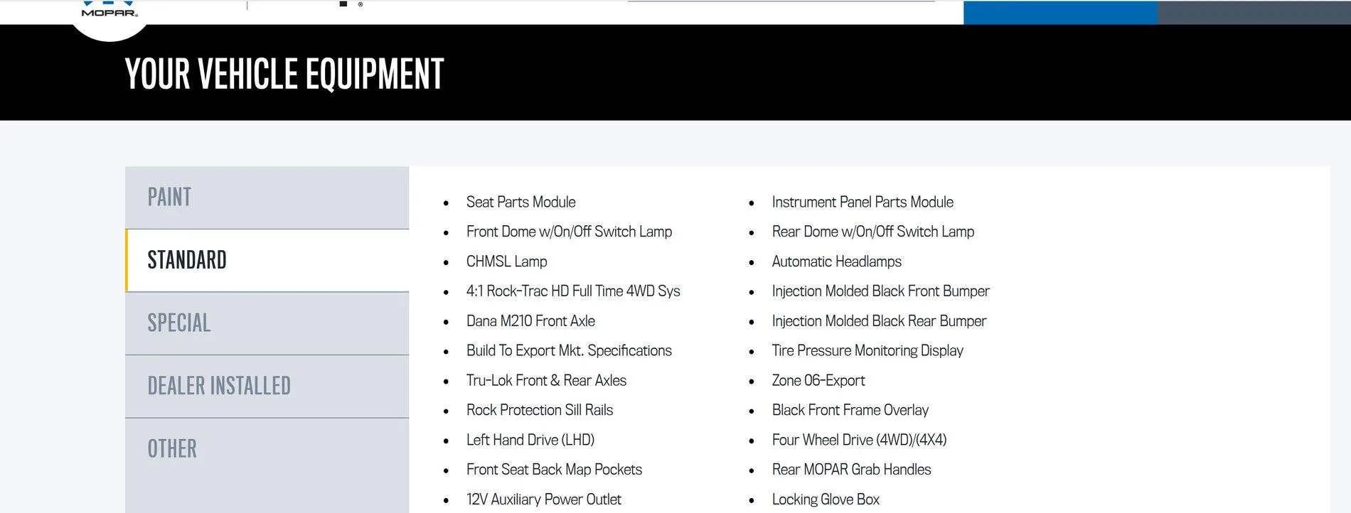

so is it the selectrac with 4:1 ratio ? this is what i got (4:1 Rock-Trac HD Full Time 4WD Sys) when i logged into my mopar account.

Ok my apologies to the poster. Didn’t know that. But .... Why? Why dilute the Rubicon brand? Don’t get me wrong, I think the SelecTrac system is fine and very capable, I’ve twken my off-road in some pretty bad conditions and it’s fine. But the Rubicon is meant to offer the pinnacle in Jeep engineering. Why do this???
Dude.. sorry, but you don't know what you're talking about.
This topic has been beat to death many, many times on this forum. Maybe you should read some of those threads before spouting off.
The Rubicon in ALL markets except NA have BOTH selectrac AND the Rocktrac transfer case with 4:1 gears, plus lockers, plus swaybar disconnect, It is not "watered down" as you claim. Just different than what you have.
They have D44s, front and rear. Except that they added CV joints to the front so that 4 auto is possible.
I have been under the sahara and rubi at the show room, and the transfer case and axles are clearly different.
