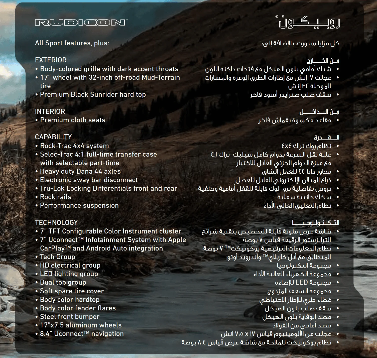

Ok, yes what we get is 4 hi auto with the rock-trac transfer case as I understand it. In the UK brochure it’s called Comand-Trac?
That's odd, Command-trac is the sport transfer case.

Selec-Trac with 4:1 and Lockers
I guess they use Roc-Trac + Selec-Trac for marketing purposes since its easier than to say a "modified Selec-Trac" transfer case
the brochure says both its making my head hurt too.
i will crawl under the jeep and find a part number or something tomorrow.
“Rock-Trac 4x4 System” means absolutely nothing. Damn Europeans.

so is it the selectrac with 4:1 ratio ? this is what i got (4:1 Rock-Trac HD Full Time 4WD Sys) when i logged into my mopar account.
