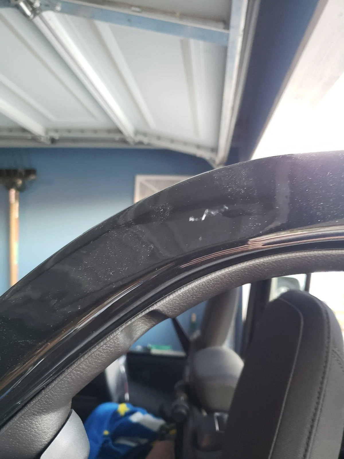

Hello! I am not sure if anyone will see this, but I found a scratch behind the passenger door handle of my brand new JL and was wondering if a meguiars compound would solve it. For those who have dealt with something similar please let me know. I would really appreciate any advice I can get.

Yes that should take care of that little scratch… usually the scratches in that area are caused from rings. once the scratch is removed you could place a small piece of clear paint protection film from 3M, Xpel, or the likes to prevent this from happening in the future.

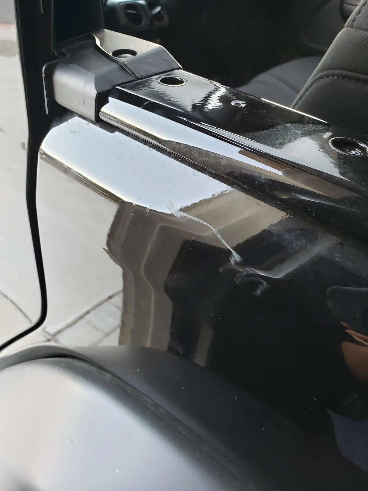

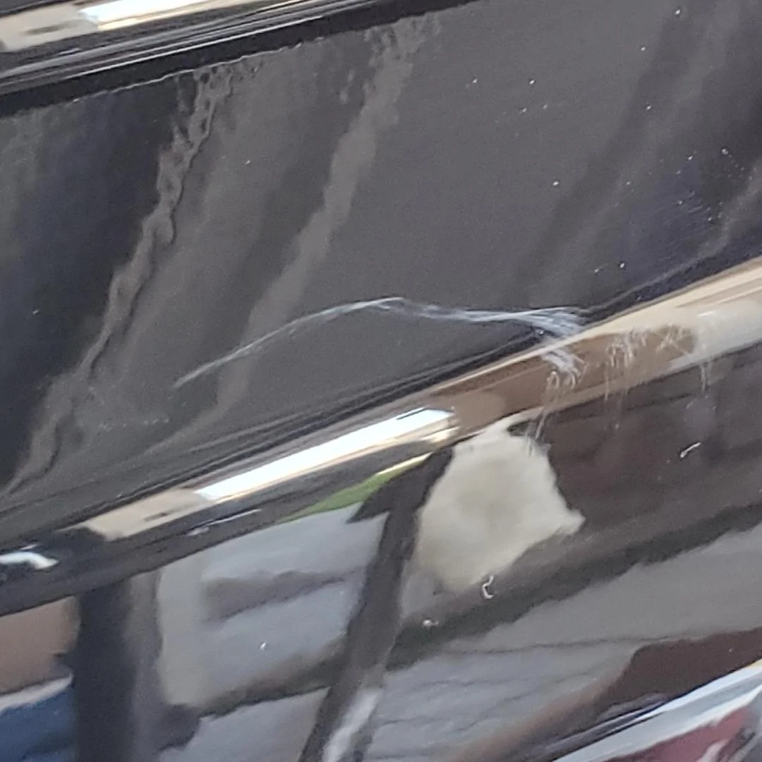

This is how my scratch look like in my Rubi. Any suggestion?
That's down to the primer. In that metallic paint, any repair will be detectable unless the entire panel is painted. However, it can be locally repaired if you're willing to accept that you will still see it if you look for it.
There's a lot of ways to approach this including everything in between cleaning out the gouge and filling with the paint no larger than the damage, to sanding out the gouge and repainting the panel.
If you go the minimalist route, clean it out, fill with a small amount of filler, such as bondo or paint putty. Sand with 1000 grit, apply paint by blotting a touch up brush. Sand flush, buff,
