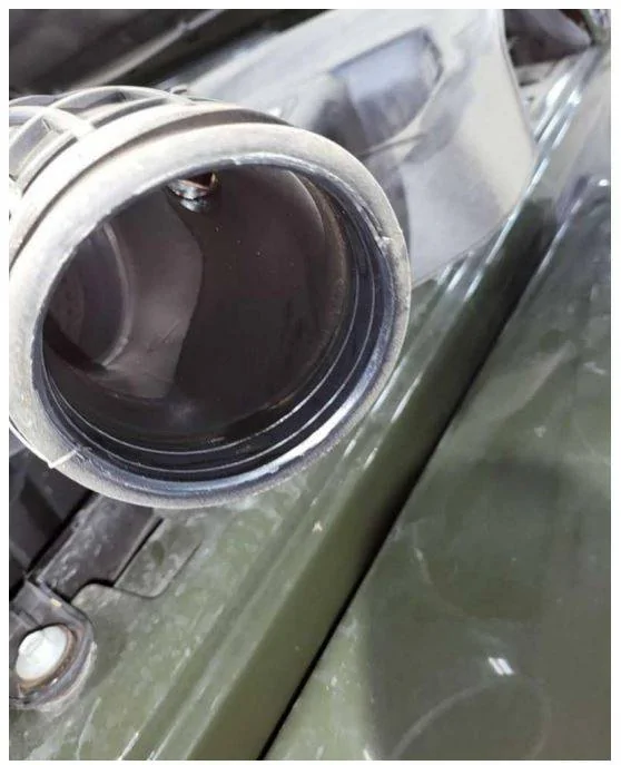

Didn't anyone take pictures to document all this supposed sand?
When I asked the dealer for a photo of the sand in the engine this is what they sent me.
Jeep Wrangler JL Sand In Engine Sand In Engin

Kurt, I can see a dust trail. Is this the induction tube that connects to the airbox? Did the air filter show any visible distress (trying to implode from plugging) that might show bypass where it seats? Any cracks in the air filter housing that might allow dirty air on the backside of the air filter?
