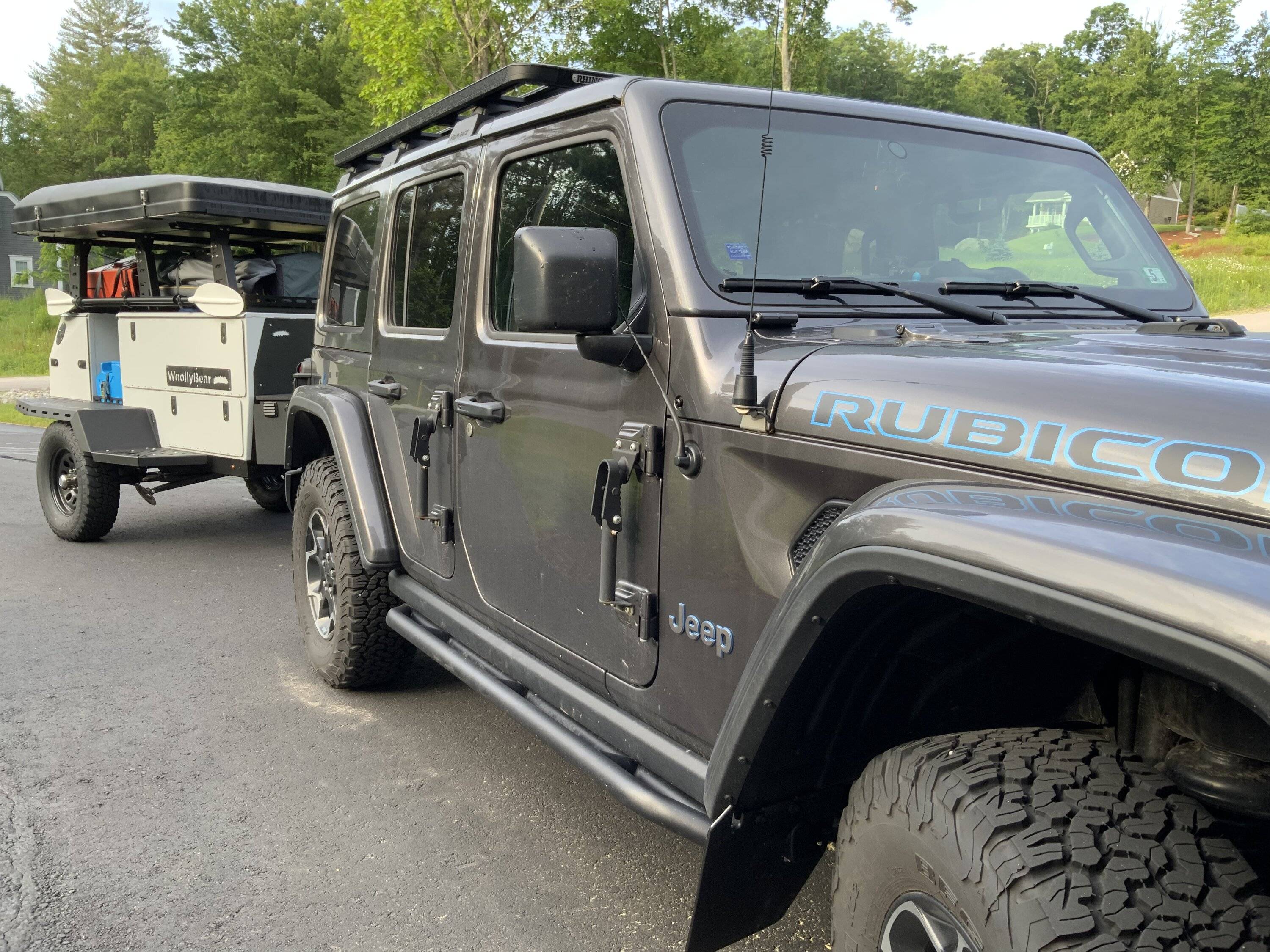

@mjposner, we’ve towed a Taxa Woolly Bear on a couple trips - once more than 1,000 miles. See pic below. It’s a lightweight overlanding trailer (1,270 pounds dry). We then loaded it up with roof top tent and other gear to its max weight of 2,100 pounds.
Installed brake controller, and never even noticed the weight. Even had one panic stop with swerving to avoid an accident, and it all worked flawlessly. Having the max regen braking is almost like having a brake controller as well - so it’s kind of like having two brake controllers stacked on top of each other.

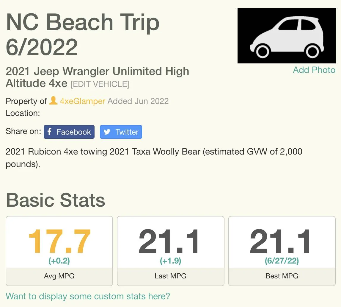

Measured MPG on that long trip was 17.7 MPG using the Fuelly app.
One $100 mod is a must for towing - Airlift Air Bags for your rear springs. Immense difference.
Can’t speak for anything above 2,100 pounds, but towing this with the 4xe was perfect, and barely noticeable, with an acceptable impact to MPG.
Jeep Wrangler JL RV Towing w/ 4xe ?? 475450D2-39C5-47C2-996C-93775FC7829A
And here’s the output from the Fuelly app for that trip:
