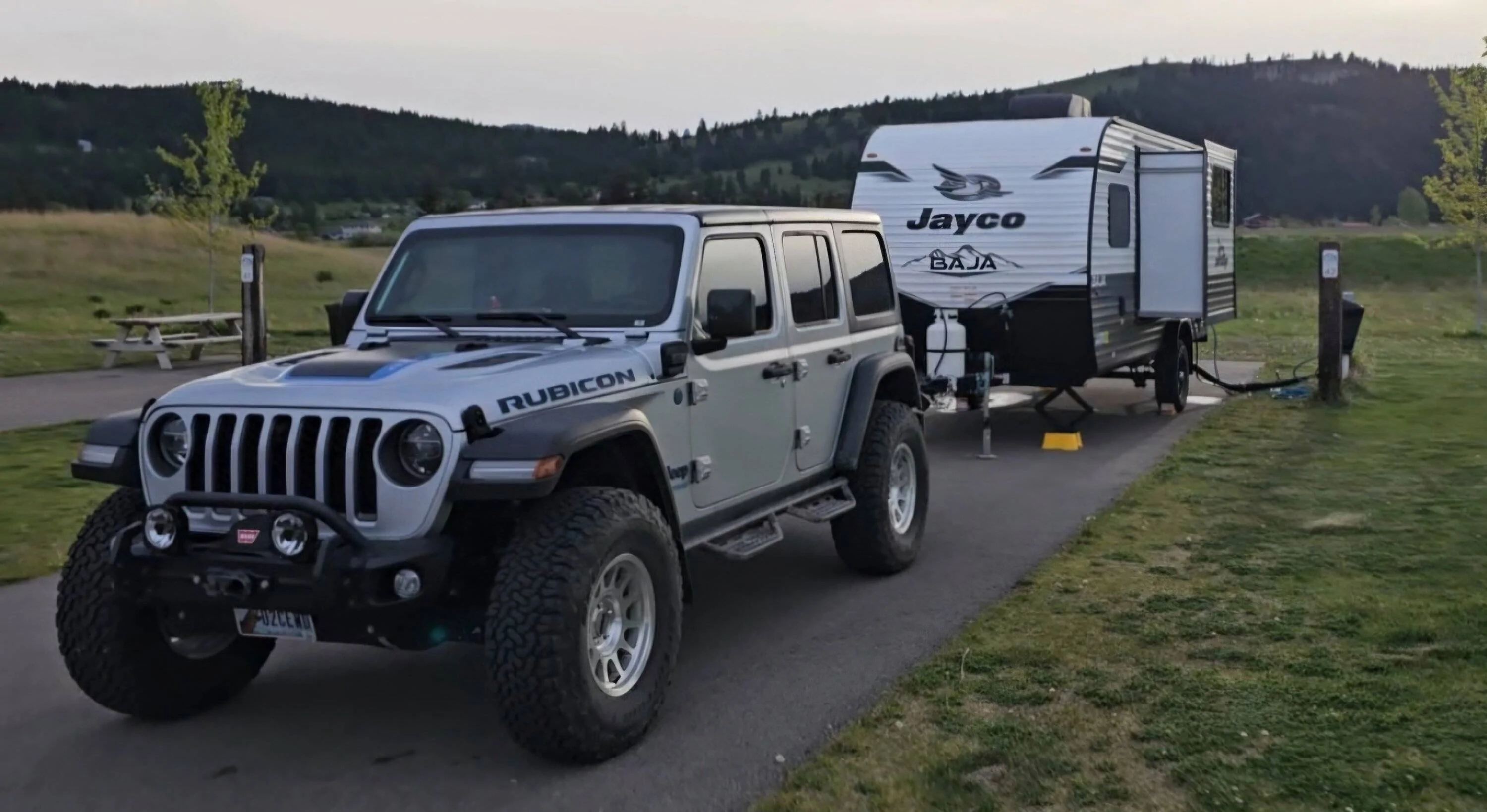

Just finished a 2,300 mile trip towing a 4,000 lb camper, figured I would share my experience.
The Jeep is a 2022 Rubicon with 7,000 miles. It has a 2" Mopar lift, 37" K02 tires, and factory 4.10 gears.
The trailer is 3,500 lbs dry, so probably over 4,000 loaded. It squats the Jeep a bit, but not an embarrassing amount. It does not bottom out, and rides very nice loaded. I added a Curt sway bar, but it really didn't need it. With the sway bar installed, I can set the cruise control at 70 mph and rarely get any wiggle. I drive 62-67 mph, anything over that and the trans searches gears a bit. It pulls hills at 65 mph with no drama or high reving. Most hills it pulls at 3,500-4,000 rpm. I had total confidence to pull into the fast lane and accelerate to 65 mph on hills. Very good power.

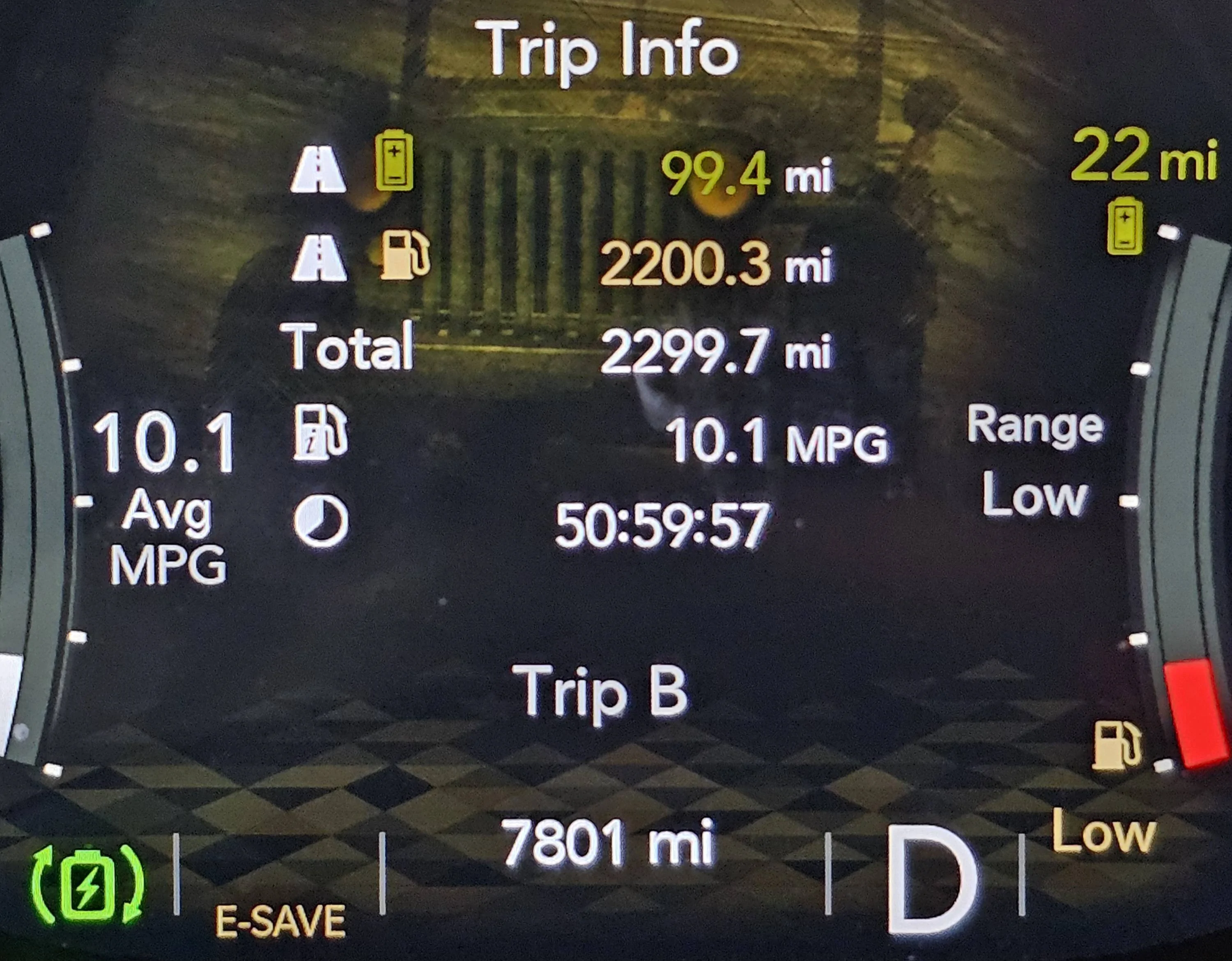

It will deplete the battery quickly towing, so we left in E-Save mode. Early in the trip we left it in Hybrid and the battery was dead before we noticed. The next 4 days it stayed on <1%, and we never recharged it. I was shocked that it had no issues towing and power was not affected... Almost. On the way home we lost power pulling a hill. It was 100 degrees, and I thought it had overheated. We topped the hill at 45 mph, and that was all it could muster. After going down the next hill, it went back to normal. I watched the temp gauges the rest of the day and didn't notice anything out of the ordinary. After a long 5 mile uphill pull, it dropped power again. Same deal, topped the hill at 45 mph then back to normal after the downhill. When I was almost home, it occurred to me that the battery was dead. I know that seems obvious, but it had been towing at hwy speed for 1,500 miles with the battery below 1% and working perfectly. Just before we got home, we had to go over a pass. It's a good climb from 2,000ft to 4,000 ft in a few miles. I pulled up the guage that shows ICE and Electric power use. Starting the hill, electric use was high. After about 3 miles, power dropped off and the electric use guage dropped to zero. There's my answer, lol, the battery was dead.
It is absolutely mind blowing that the 4xe tows the way it does and maintains excellent power at sustained loads over it's tow rating. Even with a dead battery, it operates in hybrid mode for thousands of miles with almost no power drop-off. Average mpg for the 2,300 mile trip from North Idaho to San Francisco was 10.1 mpg.
My only complaint is that I can't lock it in E-Save mode. Jeep absolutely killed it with this powertrain. It is an absolute joy to drive loaded or unloaded.

Isn’t the towing capacity 3500lbs for the 2024 Rubicon 4xe? That’s pretty good experience if you were over its rating. Nice setup.

Nice writeup, do you have a brake controller for the trailer? I’d probably be terrified without one if going over the tow rating.

Yes, that is slightly over the tow rating. I did add a brake controller. The regen braking is excellent though and I never had to apply the brakes on hills to control the speed.
I have towed trailers my whole life. This setup is top 2 or 3 best driving setups I have towed.

When you say you can't lock it into E-Save do you just mean that you have to manually put it back into E-Save everytime you restart? I can't imagine a situation where it would pop out while driving but maybe yours is.

I mean we had to put it in E-Save after each stop... which is VERY frequent towing with the Jeep. I wish there was a way to lock it in E-Save or whatever mode you wanted it to stay in.
