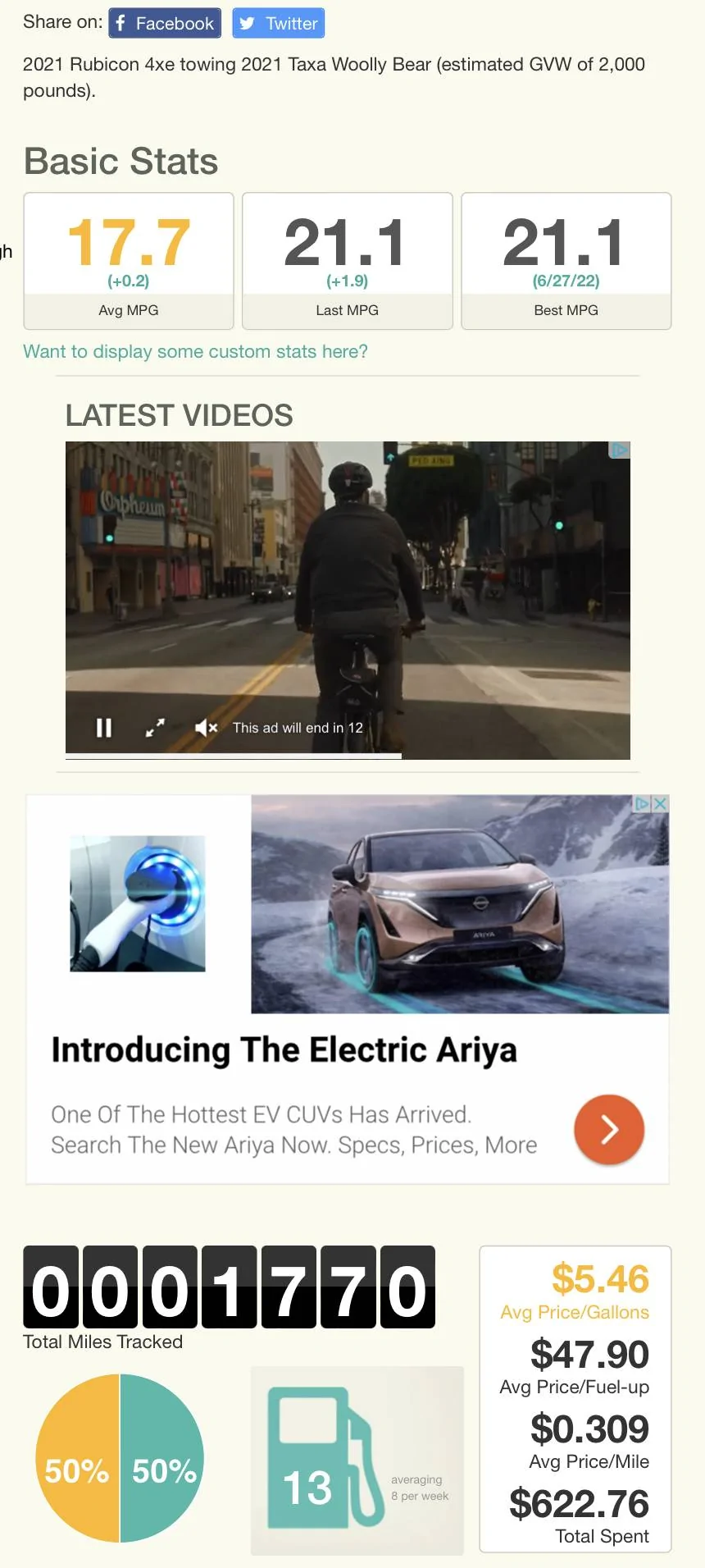

I know this doesn’t help the OP, as he’s looking to tow 3,000 pounds. But it might help someone else as a reality check for towing a more modest load.
I towed a trailer with our 2021 4xe JLUR on a 1,770 mile trip this past summer and averaged 17.7 MPG, with best mileage of 21.1 MPG. See Fuelly stats below. For reference, our 4xe has no lift, OEM 33” BFG KO2 tires, and probably was hauling about 800 pounds of mods/cargo/people in/on the Jeep
The trailer itself is about 1,300 pounds, and we calculated roughly 700 pounds of gear, food, roof top tent, fuel, water, etc. So, roughly a 2,000 pound total weight being towed.
Zero problems at all with this configuration. I do have the OEM tow package, a pair of AirLift 1000 Airbags for the rear coil springs, and I installed a Tekonsha brake controller. The brake controller worked flawlessly, even in one crazy panic stop when someone cut me off, and I had to swerve and mash the brakes at the same time.
Also loved how the max regen provides extra braking - great for down hills, etc. It’s like having another brake controller, not that I needed that for such a light trailer, but I would imagine that would be of help if someone was pushing the envelope on trailer weight.
Biggest factor for me impacting MPG was speed. If I stayed between 55 and 65 the mileage was good. Above 65, the efficiency dropped pretty quickly. Probably not a great idea to be trying to set any land speed records while towing anyway!
Here are my Fuelly stats for this particular 1,770 mile trip:
