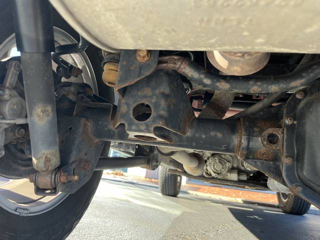

Hey fellas, figure it would be good to post in this thread as it's 5 yrs old to see how your rigs are holding up based on those who used fluid film vs. linex vs. eastwood vs. just undercarriage wash? I pick up my new Jeep in 2 weeks and want it to last.
I looked at this 2018 w 40k miles for another forum member who wasn't local and this is what I'd like to avoid. The salt use here in MA kills the undercarriages.
Jeep Wrangler JL Rust Protection Standard? IMG-3797
Jeep Wrangler JL Rust Protection Standard? IMG-3798
Jeep Wrangler JL Rust Protection Standard? IMG-3799
