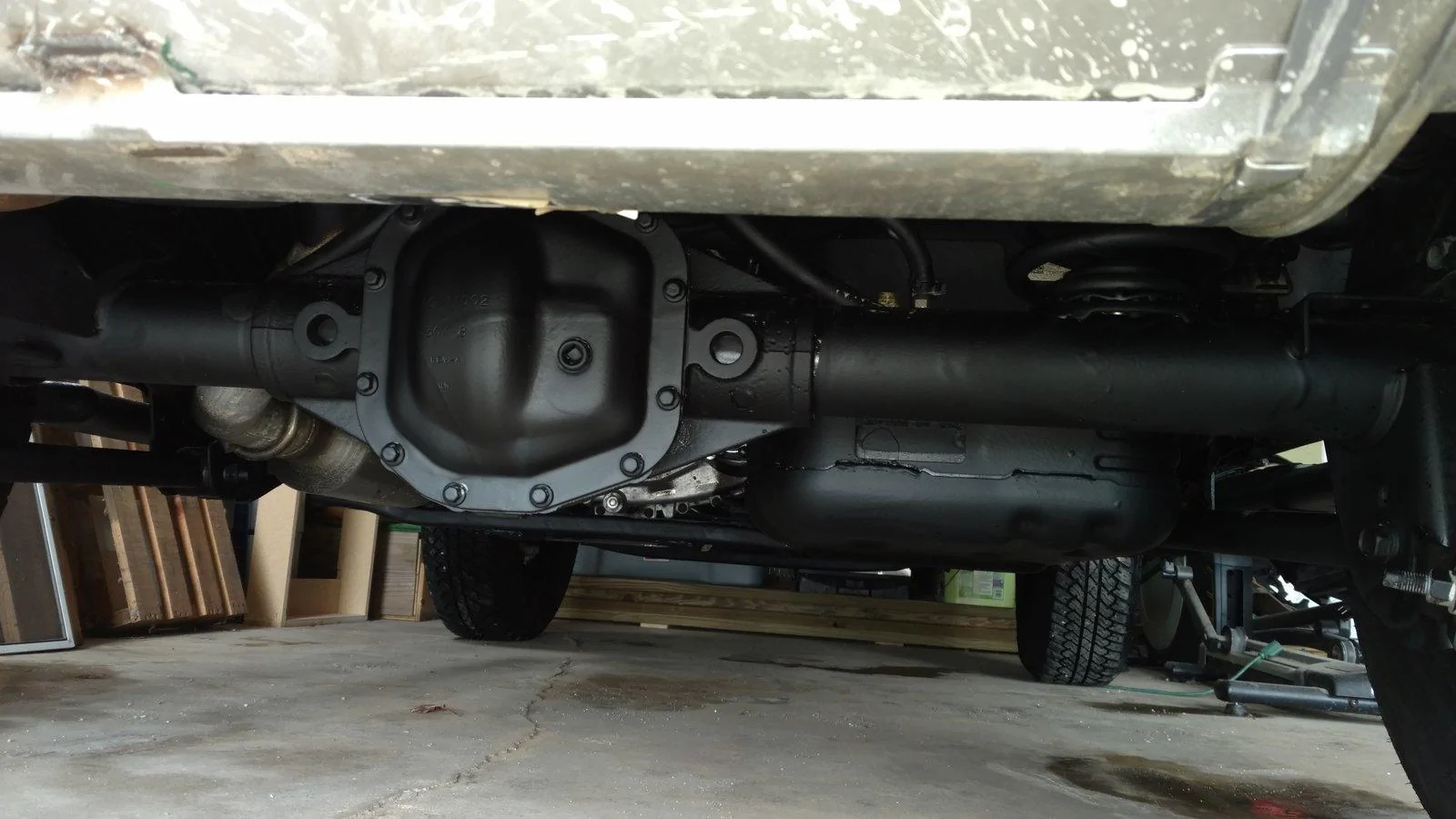

Not the best picture, but this is the rust proofing and undercoating from LineX.

Are you happy with it? I was looking for a place to take mine
Yes I am. I also had my 17 JKU done when we bought it. No problems with it. After owning a TJ, I do what I can to try to prevent any rust, if possible.

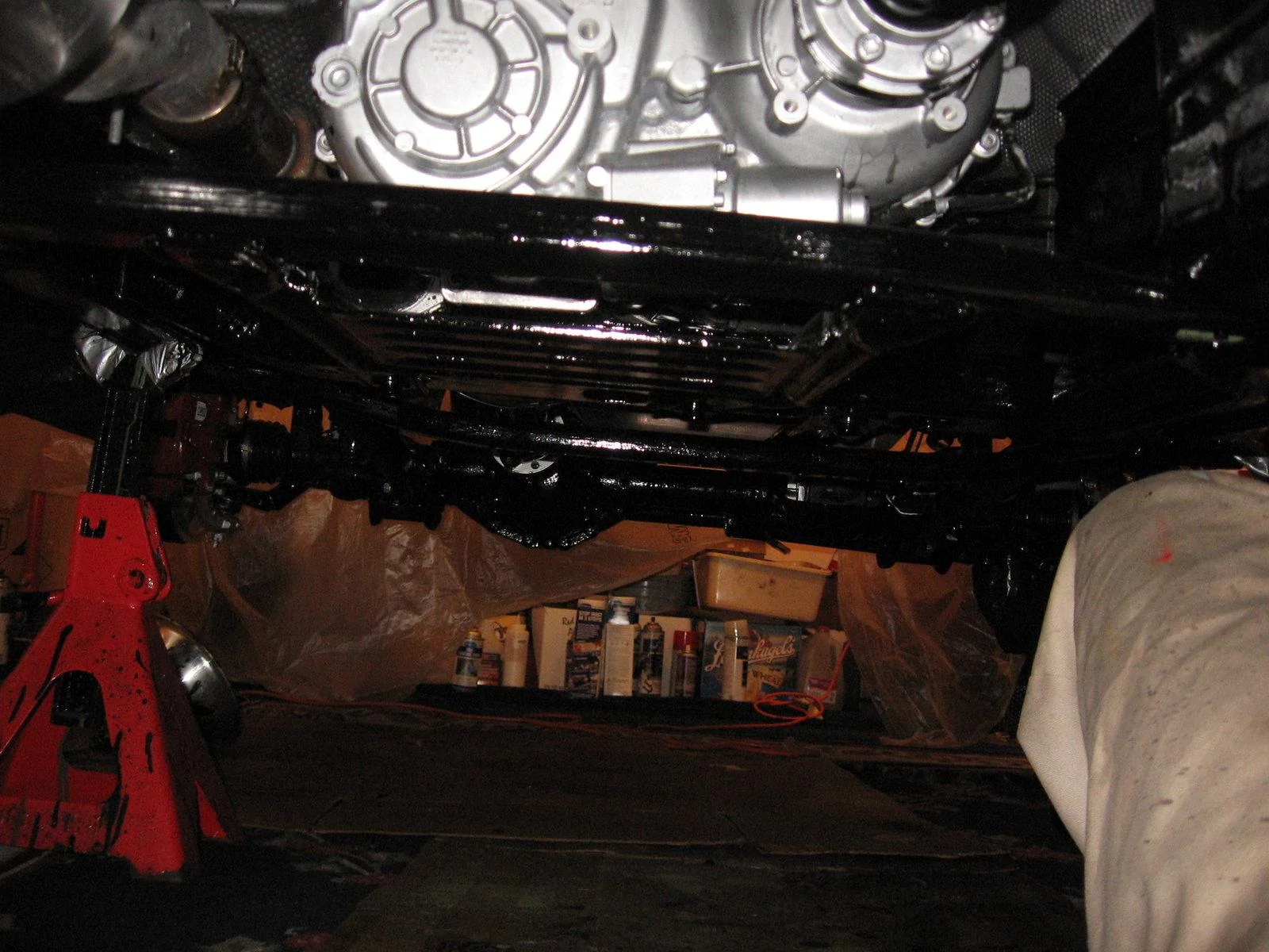

Here is what work for me. I order my cars/jeeps, pick them up at local dealer(pays to buy local, store is around the corner and gives excellent service, free loaners for any servive on any car, new or out of warranty) and bring them right home.
power wash under side, allow to dry. Pull all the inner liners out.
Paint everything under neath with Eastwoods Rust encapsulator paint and then top coat with their chasis black epoxy, do all the floors and suspension. Also use their paintable seam sealer on floor pan seems where they overlap. I use their inner frame coating ( Zinc phenolic) inside all the rocker boxes and frames. Cans come with a wand. Then I finish with waxy coating I bought at PSC, spray it on everything
https://petroleumservicecompany.com/undercoating-in-a-can-black-wax-coating/
I use Rustoleum aluminum paint on all the aluminum underneath
lastly I use Fluid film with a wand to flood all the lower doors, tailgate and respray inside the frames, rockers.
Time consuming PITA to do this but if you do it correctly from the get go when new and everything is clean, it works well.
I also use eastwoods caliper paint and do the calipers. Pull the unit bearings out and put some grease behind them so down the road can get them out of the hubs for replacement.
Also take all connectors apart and put dielectic grease in them for corrosion. On all negative chasis grounds, use liquid electrical tape, and dab on the ends where the eye loops are so corrosion doesnt start.
Things like this will help avert all the stupid little problems that crop up.
