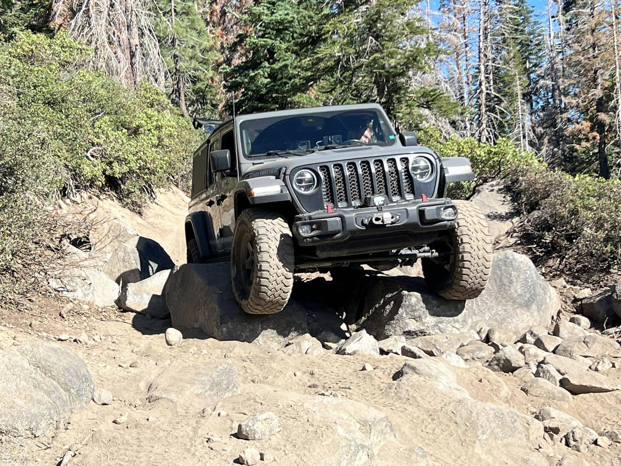

Based on what you say you will be driving, you will be fine IF you have good spotters and follow their every single command.
My Advice: Prepare yourself mentally to hear thuds and scraping sounds. Hopefully you've heard them before. Remember slow & steady will get you to the finish line... it is not a race. If you get impatient you will dramatically increase your chance of damage. There's a little sand on all of the rocks and you increase your chances of sliding off (in an any direction) if you don't have great foot pedal command. Start practicing your two foot driving skills now, don't wait until "game time".
My Background: A group of 12 of our club members tackled the trail in July 2023. We had 2 & 4 door Wranglers, plus an XJ and 4 JTs. Great spotting by our fellow club members got me through, only winching 3 times, with my Gladiator on a 2.5" lift and worn down 35" MT's.
Truth Be Told: I have a full belly set of skid plates from Rock Hard 4x4, but a couple JKU's in our club had very little belly protection. Also of note because of my inpatients, I did bend my steering stabilizer somewhere in the last hour or two at the north end of the trail. I got lazy and apparently hit a solitary rock in the middle of the trail. One of those spots that didn't seem like an issue. However, I was still able to drive home all the way to Kansas just fine.
Jeep Wrangler JL Rubicon Trip Z Turn 7
Jeep Wrangler JL Rubicon Trip Random Spot
