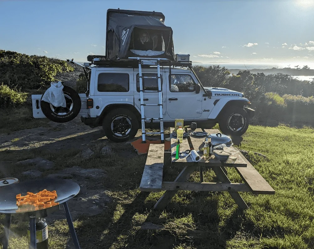

I've got the frontrunner and it's very solid and I believe can handle at least as much as any other. It does require drilling the hardtop and installation of brackets to the roll bar. I'm very happy with it.
Jeep Wrangler JL Roof Rack Weight Capacity? 1711467027091-wg
