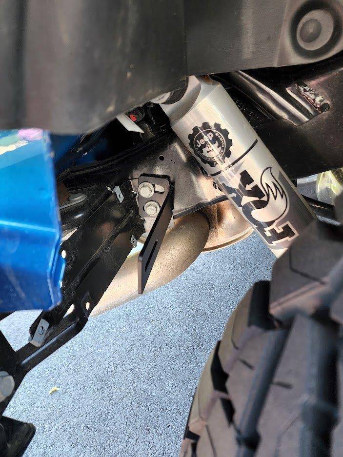

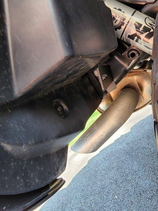

I put the rears on to protect the drivers behind me. These bigger tires on a lifted jeep tend to throw things. It does keep the rear cleaner and the bracket is super easy to install and remove if you need to repaint.
I changed the installation by cutting a small box on the plastic part they recommend removing (just where the two bolts would go in), flipping the bracket, and reinstalling everything. Keeps the mud and junk out of everything and looks cleaner.
Jeep Wrangler JL Rokblokz rear mud guards bracket and rust Step1BracketOrientation
Jeep Wrangler JL Rokblokz rear mud guards bracket and rust Step2CutSquareAreaAroundBolts
Jeep Wrangler JL Rokblokz rear mud guards bracket and rust Step3HowItShouldLook
Jeep Wrangler JL Rokblokz rear mud guards bracket and rust Step4BendBracketOutSlightlyForPerfectFit
Jeep Wrangler JL Rokblokz rear mud guards bracket and rust Step5FinalInspection
Johnsonrd, can you explain why you "flipped the bracket" on your install here?
Your pics are great, but as I haven't installed the rear mud guards yet, I'm not familiar with the exact details of how everything fits together back there. And I also like the idea of not ditching that smaller piece of fender liner, but cutting it to allow the bracket to be installed in conjunction with it.

It's really just installing forwards. If you look at their instructions and see the orientation, the L shape of the bracket is rear facing where I put it forward facing. Their installation is the long edge is on the backside or rear-facing and I just flip the basket forward so the long edge is pointing forwards. Once you have the bracket in hand, it will make sense.
PS Keep in mind that the bracket that holds the fender liner is removed and thus the mud flap bracket would flip that space. In mine, it stays so you can reinstall that part.

OK, thanks! In looking at your photo, I believe I understand you on that.
Can you tell me why you chose to mount the bracket flipped, though? I'm not challenging or questioning your positioning of it, just curious as to why you chose to do it that way.
Without the fender liner and regardless of the mudflap, you're going to get a lot of debris thrown behind the remaining liner and the top of the mudflap. I really didn't want that area to be constantly getting mud, water, etc. I figured it was an easy adjustment, retained all the parts, and provided the most coverage. Honestly, the setup is perfect and I only get a bit of stuff on the tail end edge of the bumper. When you remove the lower fender liner, you'll see how big that space appears suddenly.
I'm running 37" tires on that setup and there's plenty of room.

No, you cannot retain the lower fender liner portion if installed according to their instructions. You ask why so my reasoning was the desire to retain that part which maintains complete coverage of the wheel well.
