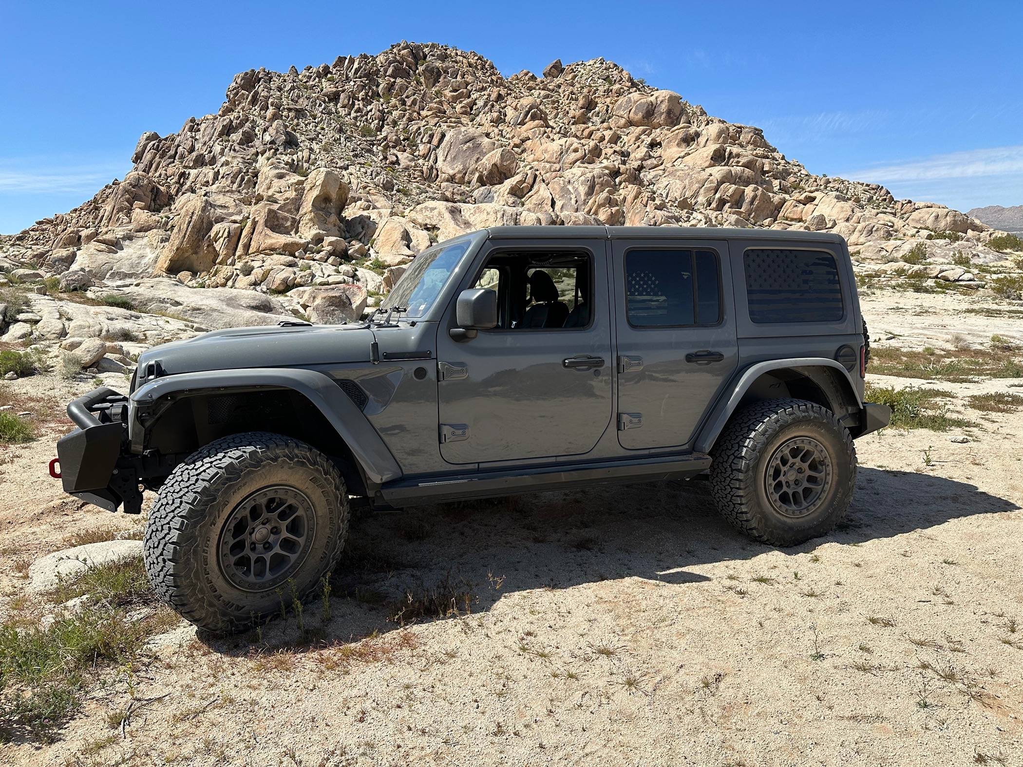

It’s funny that as I read each post I couldn’t help but notice that nobody posts a picture of this thing. It looks good. I’ve got the Rubicon sliders on mine, but I would like a step on the passenger side.

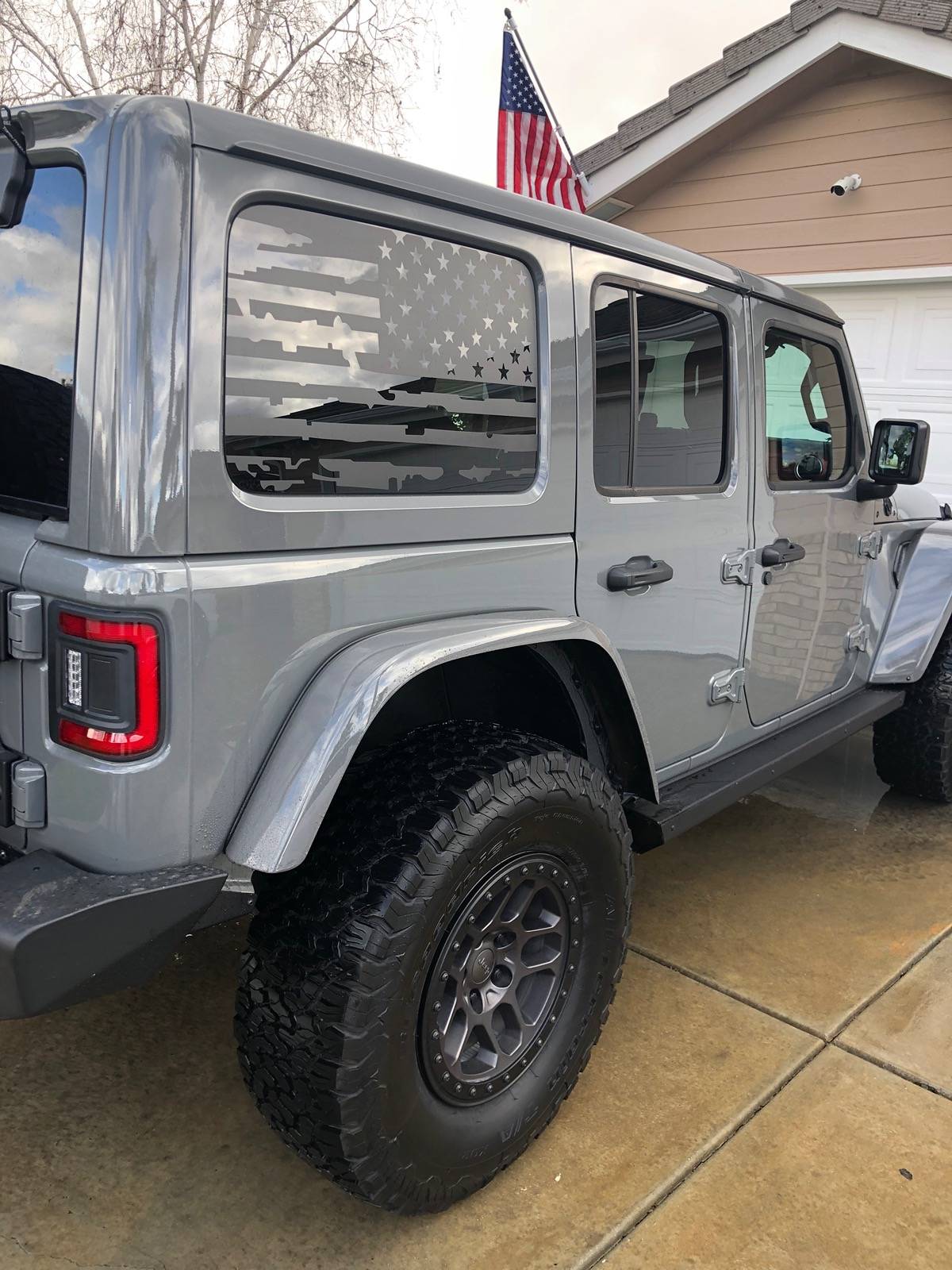

let me know what pics you want. I’ll be happy to post
