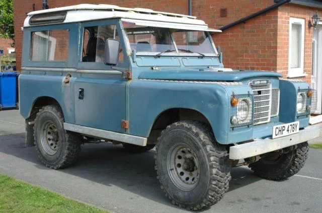

I wonder if you can find some sliders that are galvanized, or maybe have some dipped? That tends to last a long time, and scratches tend not to rust past the scratch. A buddy of mine building a CJ-8 Scrambler is having various items dipped. If you want to avoid rust that can work well. Typically if you want to paint over the galvanizing, a latex based primer is recommended. Although I have also used some enamel and it held up ok.
These sort of galvy sliders are popular on Land Rovers. (In fact I plan to weld up a pair and have them dipped for my old Series this summer.). This version does not provide area for a "step up". But also it avoids sticking out far to catch on things. So depends on what you want. Rover owners often leave the sliders unpainted, to match the other galvy bits. Might want to paint them on a Wrangler though.

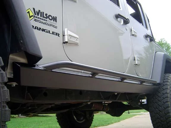

The ACE sliders appear to hang down lower than I prefer. I’m sure there will be plenty of options soon enough. If you can’t wait, you could have some custom built by a local fab shop. Some I had built some years back on a previous Jeep: Jeep Wrangler JL Rock Sliders 1FB9A130-D717-46AA-A26D-8346601871E8

That picture doesn't look like my ACE sliders on my JL. ACE sliders sit just under the Rubi rails. So you have 1" more protection and less clearance at the point of the Rubi rails. (Since they bolt to frame and not the tub you get better protection.) They angle up a bit so no loss of clearance laterally.. Anything that bolts to the tub will not provide near the protection as one that bolts to the frame. Lots of videos of people who warped their tub using rails that bolt to the tub. Tough when your door no longer opens due to warped opening.
Also there is advice on the slider thread about keeping them looking nice. When mine get a few nicks, i'll over spray with black rattle can, then use it to touch up.

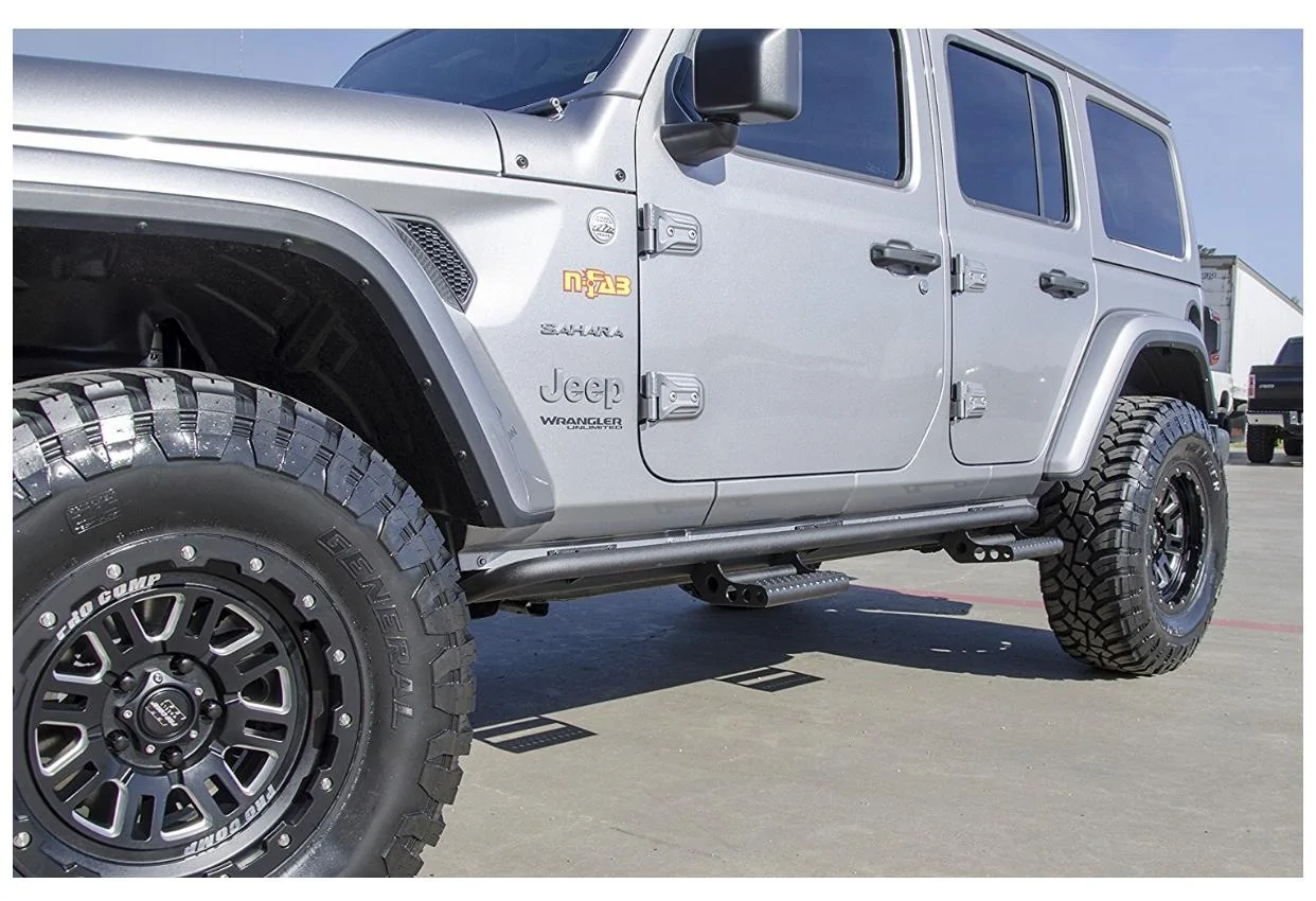

I have the NFAB sliders with removable steps ordered. I had these on my JK and they were great, I got my order in early for these and last communication should have them in a couple weeks.
