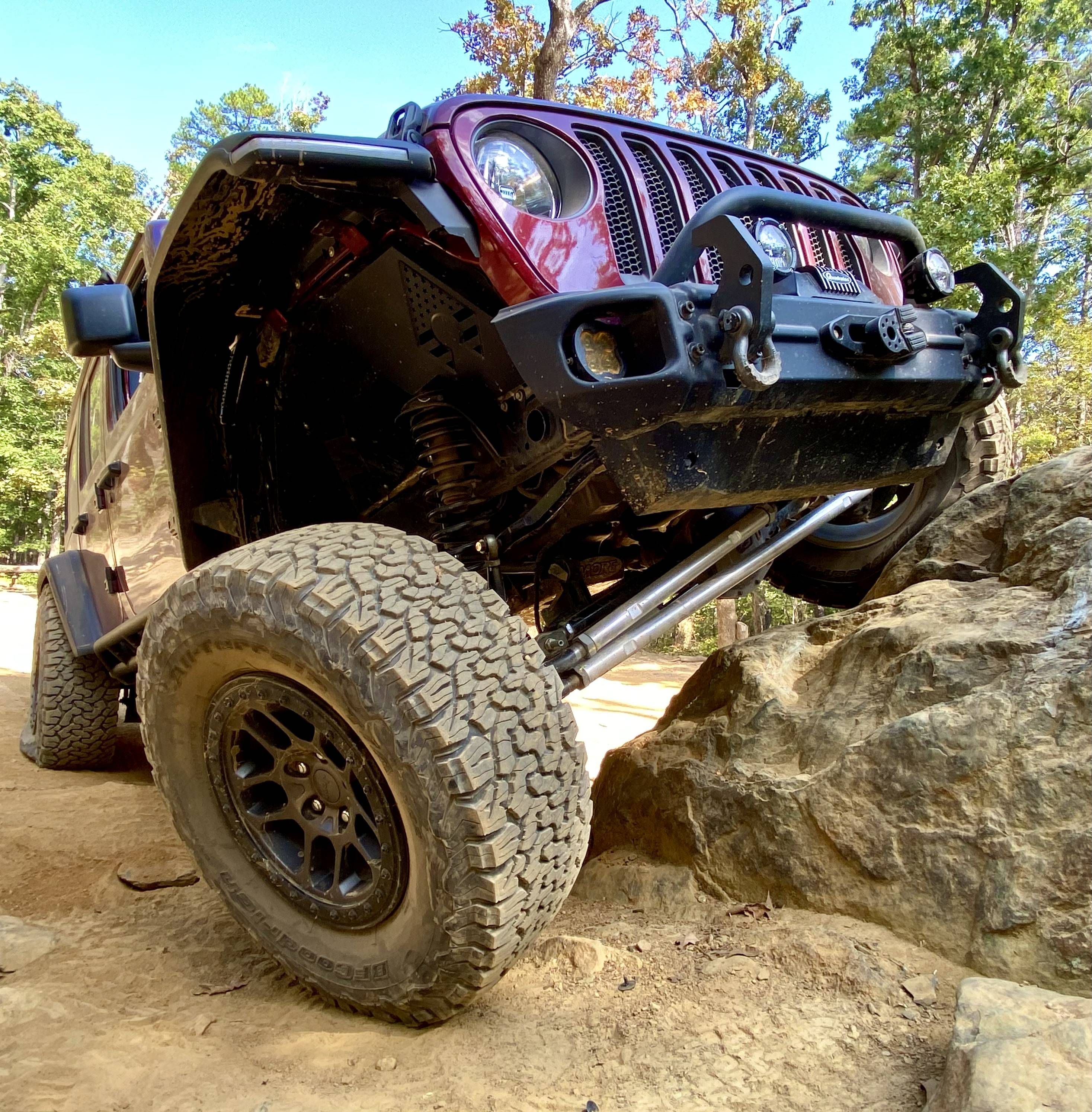

Rock Krawler does not disappoint
Jeep Wrangler JL Rock Krawler Differences? 92C336B3-925F-4ADF-9EC2-80D191610B79
