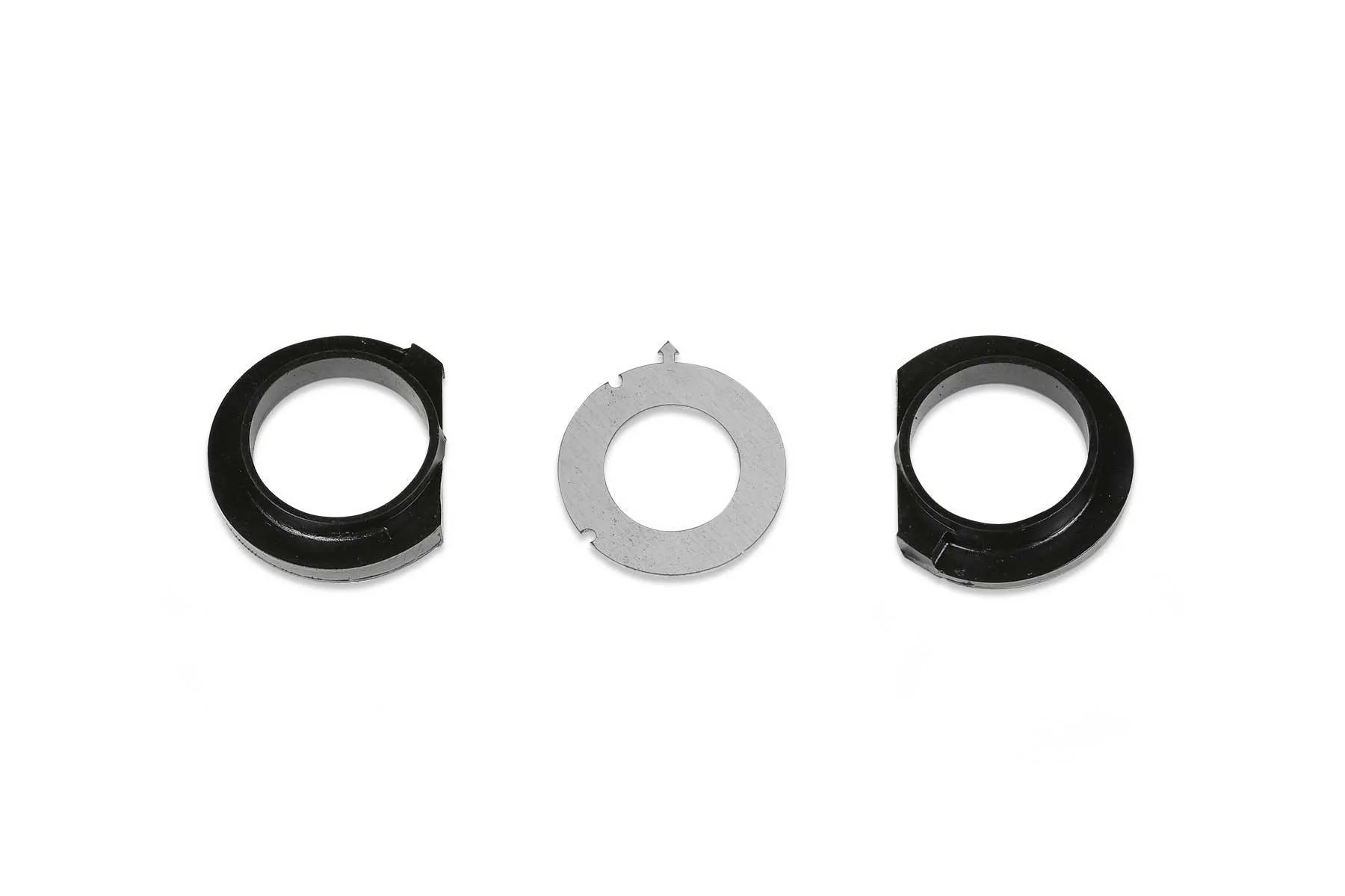

I bought a set of RK coil springs and 'correction pads' due to their popularity for correcting coil spring bow on JL and JT models. All these 'correction pads' did for my coil springs was make the bow MUCH worse... I tried them with Mopar coils AND the RK coils in the kit.
When I contacted RK they were totally aware of the problem, but they claimed this is all Jeep's fault. They sent me a video that would 'fix all my problems' . My request for a refund was flatly rejected. Video and response below is from RK.
You have one option at this time. That is to perform the procedure as outlined. We are not sharing this information publicly because companies need to figure it out on their own. You could have gotten products from a company that has not figured it out which is the majority of them. While the other manufacturers struggle greatly with this issue and keeping up with Jeeps on going changes, we are way ahead of the curve. When we found out about this simple change made by Jeep that effects so much for every manufacturer we actually designed and are tooling up a new top spring seat. That does take a considerable amount of time 24-26 weeks just for the initial mold samples and obviously a good amount of capital. Then we bring in the production parts. This will be a part just like our bottom spring seats we can sell customers and other manufacturers or they can copy (which has happened to us many times) and go from there.
Do you think Jeep alerts every aftermarket company to their changes? Do you think even the brand managers know when this change occurred or on what models? Do you think the brand managers know when their purchasing department is buying from one supplier of theirs and not the other and which ones go down the line? They do not. Trust me, I asked all of them and could not get a solid answer. I am really good friends with the brand managers and their development team when we found this update. Their is no reason to tell everyone as it does not pertain to everyone. As a matter of fact, it has not come up all that often to my Suprise so we may have spent a large amount on a new tool for a new part we need very few of. But, this part will make them universally correct. So it is what it is. We see a fair amount of posts on boards regarding other manufactuers coils doing the same thing and then we politely message them and share with them the corrective action and they are thank ful for us jumping in and helping out.

Sounds like Stellantis randomly made a change negatively impacting Aftermarket companies once their products were already out.
That stinks but not the aftermarket companies fault. Sounds like an easy fix based on the video.

That's very odd.. I'm running them up front and they straightened mine out perfectly.. maybe they changed them?
Rodeoflyer
Bert
Dec 16, 2019
43
1,946
1,509
Conifer, Colorado
2020 Jeep JLUR; 2016 Ram Powerwagon
OH you have a diesel!! Yes, the diesels have different coil buckets for whatever reason.
They also have much high coil rates due to the extra 500lbs up front.

Right, but I bought the RK coil kit specifically for my year model, engine type, and lift height.

No, it's not RK's fault that Jeep changed a part, but selling aftermarket parts that do not require a hack is their business. I got a follow up today from RK, see below.

      For what you have now there are two solutions available. The one that we supplied in the video Bob sent you and the other company that has noted the change on some applications is Fabtech. As you can see from the Fabtech link, they use our bottom spring seats, have a steel plate that has you drill a hole to reindex the factory isolator which does exactly the same thing we are telling you to do. Their sheetmetal indexing template was released sometime in Sept of this year. We are the only two companies that have noted the change from Jeep and as I stated the issue is, it is not across the board. The fabtech solution is not a solution for all coils that could be possibly affected by this update from Jeep on select models/applications as they do not account for wire size diameter which will still be an issue for Fabtech on Hemi/Diesel/4XE coils. Our top neutral isolator when it comes in will be a solution for all aftermarket coils. It will not be dependent on wire size diameter, nor spring seat taper up top or nothing. It takes all the "Jeep" variables out of the equation. We have no issue sending a set to you when they become available, but at this time we are waiting on the first article tooling samples to come in for tooling approval. We are very close to the 24-26 week lead time for the tool. If they send us enough for you and if they are approved, we can send you a set. As I stated, these are the only two solutions out there right now. Your post will actually be more confusing to the Jeep Community as most do not the same style isolator you have up top.
      Here is a link to the Fabtech one which went in a different direction than we did and where we are going as well.
      https://fabtechmotorsports.com/product/coil-correction-kit-fts24280/
Jeep Wrangler JL Rock Krawler 'Correction Pad' - BUYER BEWARE fts24280-kit
Coil Correction Kit - FTS24280 - Fabtech®
Fabtech’s Coil Correction kit is designed to help straighten the front coil springs on Jeep JL & JT models. Some Jeeps have a pronounced bow in the stock front coil springs and /or after the installation of aftermarket coil springs.
      Again, these are the only two options for what you have at this time. Our information is 100% correct.
      You can post this as well and once approved we will post this very same information if your post is not up. We would like to not post the information as it alerts our competitors to what the possible solution is. We would much rather sell them the new isolators we are making just as we do with our bottom spring seats. 80% of the Jeep Suspension manufacturers use our bottom spring seats as the main solution to coil spring bow which covers the vast majority of jeeps out there.
      This is by no means a "hack", but the solution to your issue given the timeframe and better solutions will be available in the future as we have mentioned above.

The spring correction pads that came with my Rustys 3" lift kit didn't give me any issues on my 2022 Diesel that I picked up from the dealer in February of this year.
So if there was a change, it must've happened this year ?

I have the same parts on my rig, its a easy fix. Just cut the nipple off and align the bottom correction pad to the spring and align the top pad with the spring. I used electrical tape to hold the top pad on the spring. Reinstall the springs back into place and that is that. I have 5000 miles on mine right now and everything is just fine.
