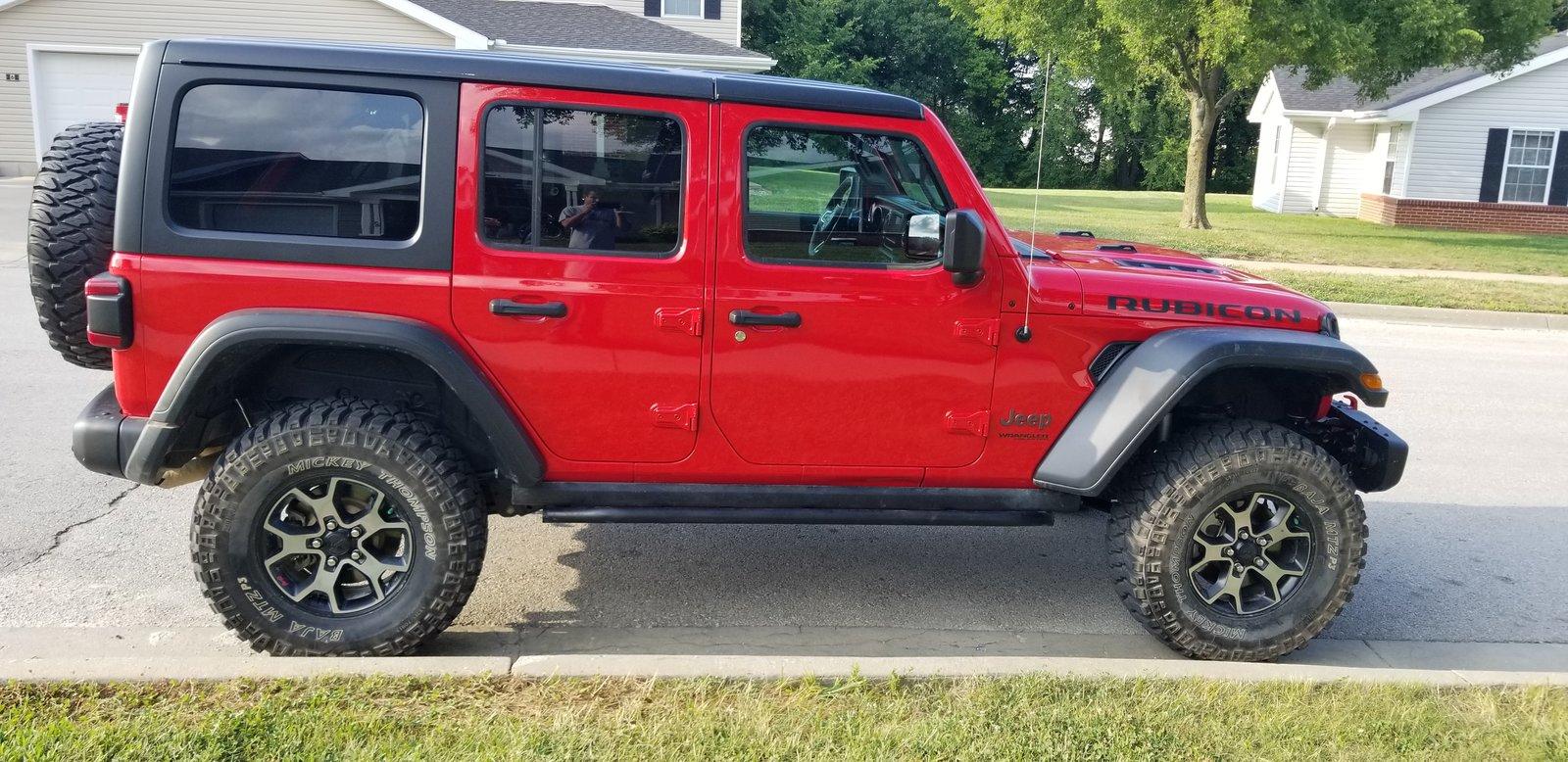

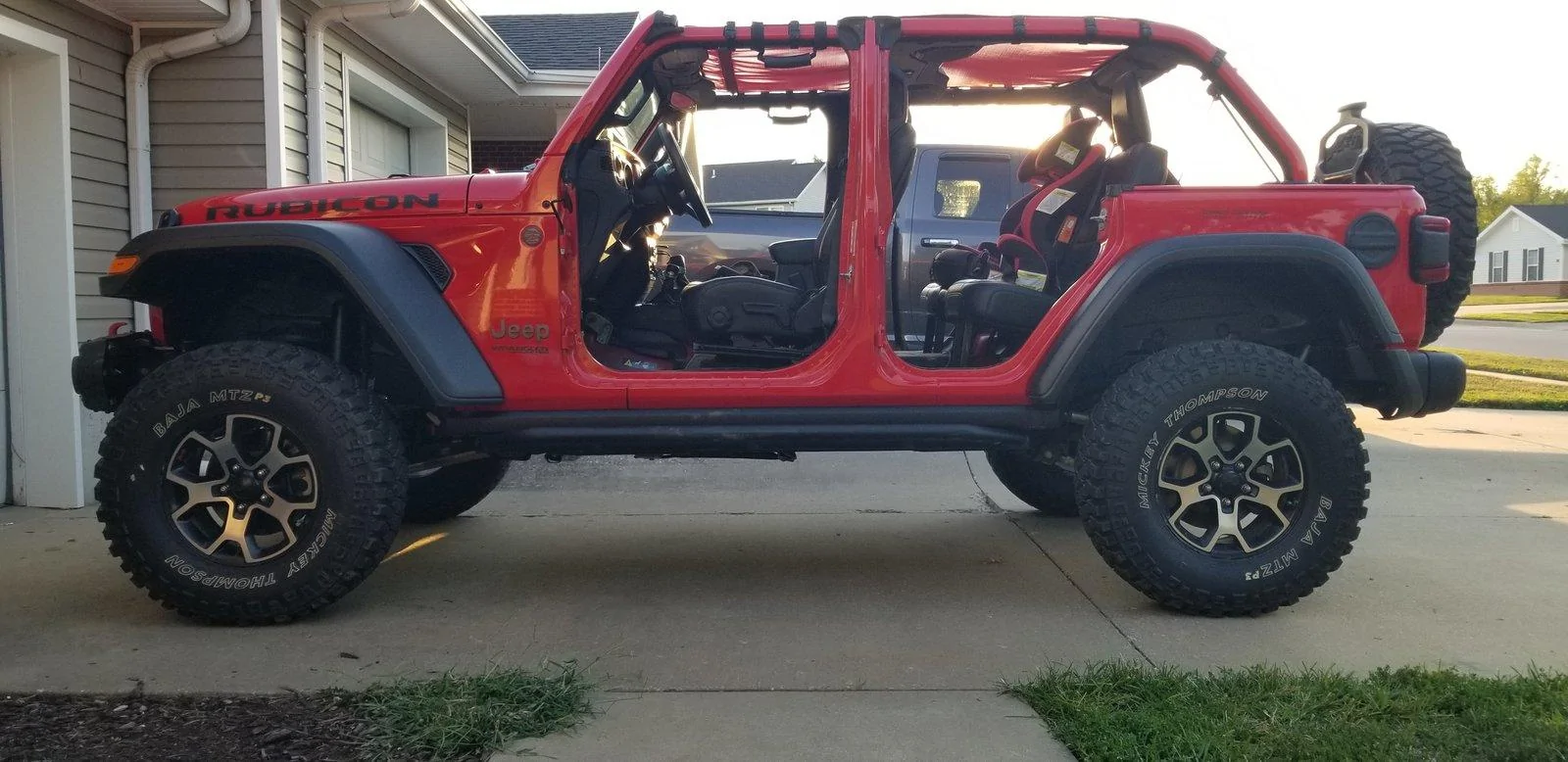

I pulled the trigger and swapped my RK kit for the MC gamechanger.
I can tell you with absolute certainty that the MC articulates better, sits higher, and binds less. The RK is definitely thicker, but having put stock equipment through some pretty obnoxious situations, not once did the stock equipment fail from contact with foreign objects. Articulation and ground clearance in my opinion are the two largest factors when I'm wheeling. The MC kit has both of those exceedingly covered.
My height sits at right about 4 inches with no additional weight added on. The driveshaft does make contact at full droop, as to be expected. The drag link, although flexed, is not flexed to the point where breaking is of concern.
I have not tested the kit off pavement yet(that will be this saturday), but on a 30 degree ramp it past my RK kit by 6 inches(I did not have bumpstops on the RK kit at the time, but after installation of bumpstops that RK supplied me free of charge articulation was less). I'm sure some of you will immediately question such a difference, as I did. Verified by two shops, my RK installation was correct. If that ramp is any indication of offroad performance, I'm in for a fun ride.
On the road I felt like the RK kit did a good job of absorbing things such as potholes, cracks, etc. Offroad, it was too soft. I found myself constantly bouncing off the bumpstops in the rear. Weight such as bodies and equipment definitely had an impact on height as well, and often times I was scraping my skids on the same places I was scraping with my spacer lift. The kit did handle all abuse i threw at it but ground clearance and articulation were definitely lacking. I went on the same trails that I did with my RC spacers, and felt no difference in CoG off camber, so I cannot comment on their rear trackbar. Perhaps 25-30 degrees isnt enough to see the benefit.
The MC kit is much more firm. Bodies, equipment, it doesnt matter. The springs just don't move. I am fully confident that additional armor and mods will have little effect on the height of this kit. You do feel more of the pavement than the RK kit, but not so much that it's annoying or inconvenient. As stated earlier, the height is every bit of 4 inches. Given the fact that I have to half-hop into the Jeep, it's clear that ground clearance is better. When fully dropped, I can literally fit my 4 year old between the top of my tire and the bottom of the fender. That's with 2 inch bumpstops front and rear, which is currently the limiting factor. I can safely drop an inch and remove the lower portion of my fenders if I wanted more. The ONLY downside I can honestly claim out of this kit is that my 35s now look ridiculous.
Another benefit I feel is worth mentioning is price. At about $500 cheaper, you get a complete kit from MC. No need to spend a dime more(unless, of course, you dont install it yourself; then you'll pay labor). The RK X-Factor prices at just under $2,400 without shocks or bumpstops. After it's all said and done, with mid-point shocks, you can expect to spend upwards of $3,000 on their kit. The MC, on the other hand, is $2,300 with shocks and bumpstops, and that's it.
While not a major factor, RK kits also require maintenance. Following their recommended schedule, you can expect to service your kit every 4 or so months, and unless you have an elbow fitting on your grease gun, requires dropping the control arms or cutting a hole in your control arm bracket. While not such a big deal, some may be a bit apprehensive on taking a hole saw to their $50k vehicle. The instructions do not mention the angled fitting that I saw, only recommend the hole saw. Keep this in mind if you purchase the kit. MC requires little to no maintenance, no special tools(other than a pipe wrench sent from the gods for their jam nuts), and no modification.

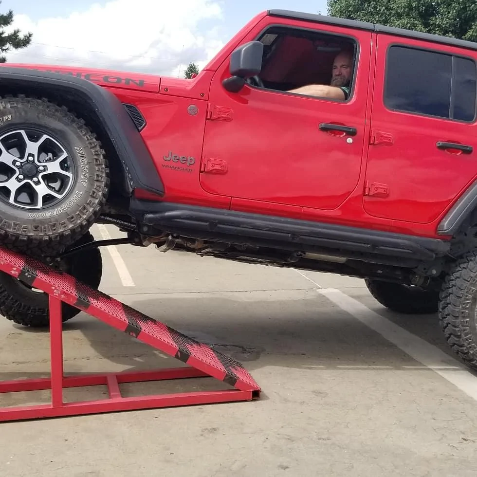

The previous shocks were skyjacker M95s, had a grey body. Dont recall part numbers, but their length was 29.5 if I remember correctly. Current shocks are MC RS shocks, which I believe to be 30" at all 4 corners. The SJ shocks did not max out on the ramp, at either compression or travel. They did max out on the CTI on the downwards stroke, but not compression which is what lead to the 850 score. Obviously with no bumpstops that's unrealistic. As mentioned, after bumpstops were put on, the articulation was less.
Bumpstops became such a large portion of my previous conversation because I was told more or less adding a bumps would fix all my woes. It did fix binding of trackbar on exhaust and swaybar on frame, but then restricted travel.
As comparison, 2 inch bumpstops all around on the MC kit offered much more articulation than my RK kit did unbumped.
I do not presume to know how the two differentiate so vastly, but I don't believe 1/2 an inch(a whole inch to be generous) difference in shock extension would cause the amount of difference shown in the pictures.

Thats right.. I forgot the track bar was hitting the exhaust. Thats why the bump stops got brought into the conversation and yes, they are designed to limit your suspension travel, which would solve that contact. A better solution for that would have been to lose the raised TB bracket and just run the adjustable bar like they do in the MC kit. Especially if your main concern is maximizing travel. I will pull my rear TB bracket out and see how my handling is affected just for fun. (I have a 2.5 X-Factor on my JL.)
"The SJ shocks did not max out on the ramp, at either compression or travel. They did max out on the CTI on the downwards stroke, but not compression which is what lead to the 850 score."
^^ That answers my questions about the shocks being too long or too short. Sounds like they are very well balanced as far as compression and droop go. There aren't any specs on the SkyJacker website for reference, so I figured I'd ask. Thanks for the info!

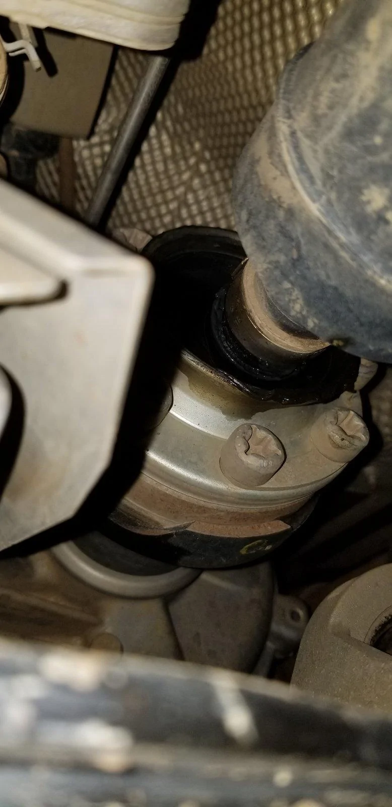

Good luck with your Jeep, we hope to see you on the trails. Keep an eye on the drive shaft and TRE on the passenger side connection of the drag link. We know with taller lifts and long travel shocks that high steer conversions and a new front driveshaft will be required.

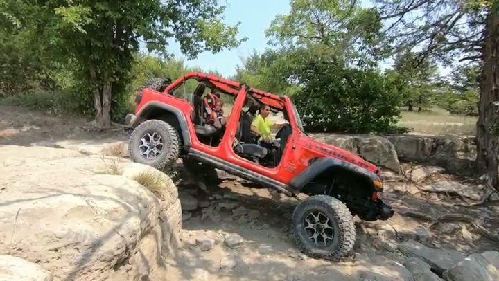

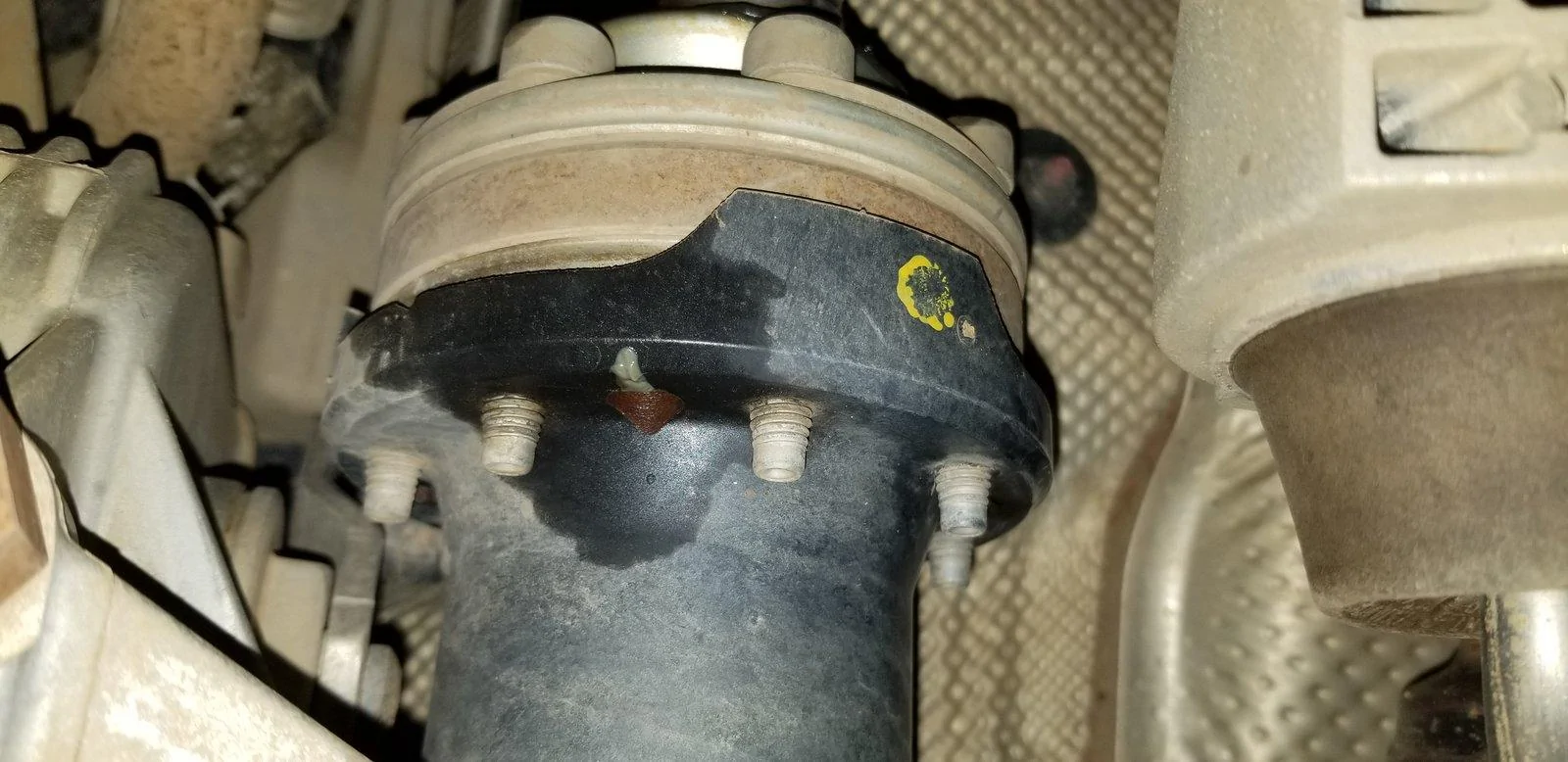

Outside of shocks, I'm not sure what else would have needed to be dialed in. I did install bumpstops, and it did fix my clearance issue, albeit at the expense of articulation.
To be fair, I knew the SJ shocks would most likely bottom me out quite a bit, and am glad I put the bumps on before i wheeled it. They got used often. The measurements for the SJ shocks were 28.5 and 29.5. I gained 1.5 inches of travel in front, and .5 inch in the rear. I don't think that difference would have caused over 6 inches of travel difference, but I could be wrong. The misalignment is higher on the RK kit, but I can't see that having an impact on articulation. At least in the 3.5-4.5 arena. Even at 30", the shocks are bottoming out before the control arms begin to bind on the MC kit.

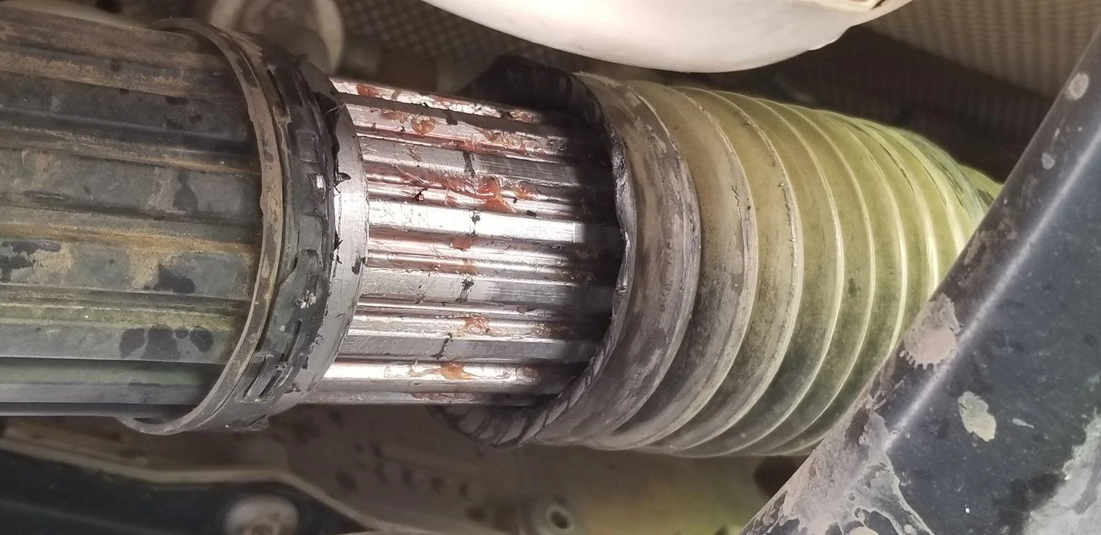

As far as the drag link and exhaust, no signs of the drag link giving out, though it is stressed quite a bit at full droop. The driveshaft slip boot was ripped off within the first hour of wheeling it, and the next day I tore the boot at the transfer case off of it. I did not have any rubbing on driveshaft with my RK kit, even through "bear tracks" which is nothing but off camber flexing. Opinion could go either way on that, so I'll leave it there. My 1310 is in the works.
