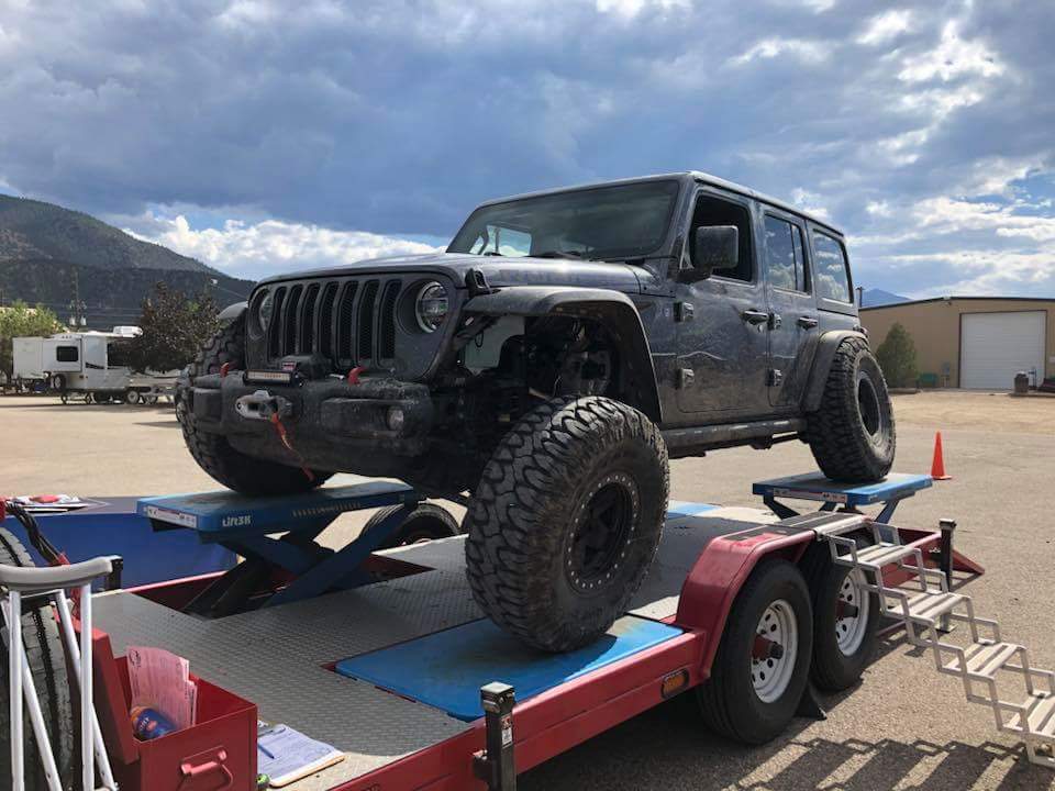

Bit of an update:

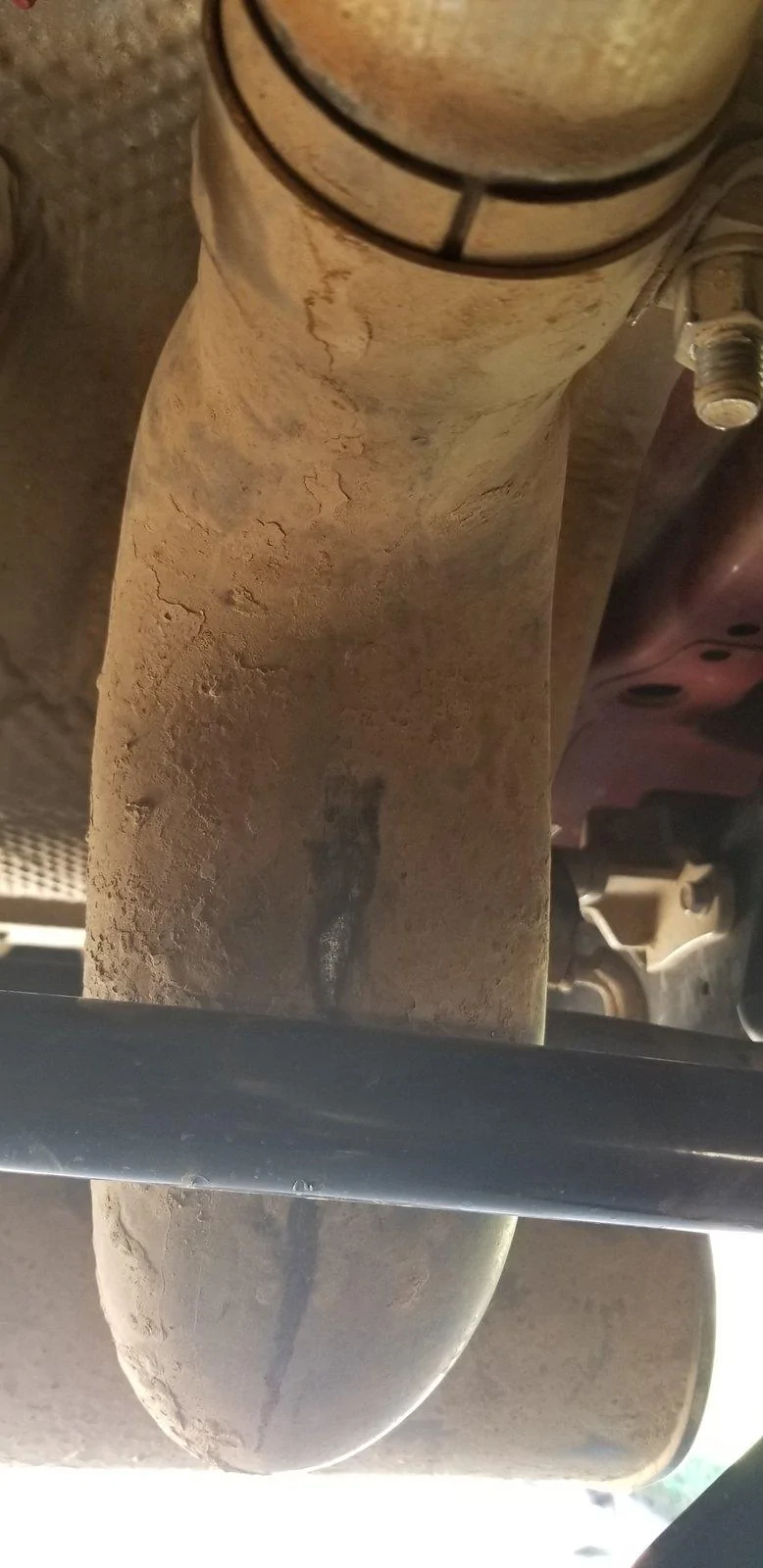

Hit up the CTI yesterday. Removed exhaust to prevent the rear trackbar from hitting. Also, I dropped the rear sway bar links by about an inch because they push into the frame at flex.
Without bumpstops, the RK kit scored an 840. With bumpstops, obviously this score would be lower.
A few notable things to point out:
With a stock rubicon, I'm at about 3.2 inches lifted
At full flex the front driveshaft does not hit the crossmember. It does, however, hit the exhaust enough to put downward pressure on it. The amount of pressure it placed was enough that an Adam's would still contact the exhaust.

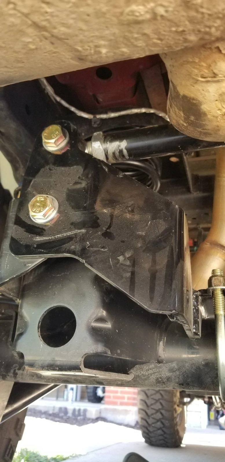

The rear swaybar STILL makes contact with the frame. I'm going to adjust the links lower, but it may look like I'll need to get bracket spacers.
While the CTI was going, there was a very audible bang on the passenger side. Upon investigating, it turns out the front passenger spring caught the edge of the frame and started compressing under it. Finally gave out after the trailer flexed it a bit more.
The shocks were quite a bit into the frame, creating a nice curve along the shaft. No permenant damage was done to the shock.
The draglink, although flexed, did not seem to be under extreme stress.
With 2" bumpstops the estimated score would probably be around a 770-780.

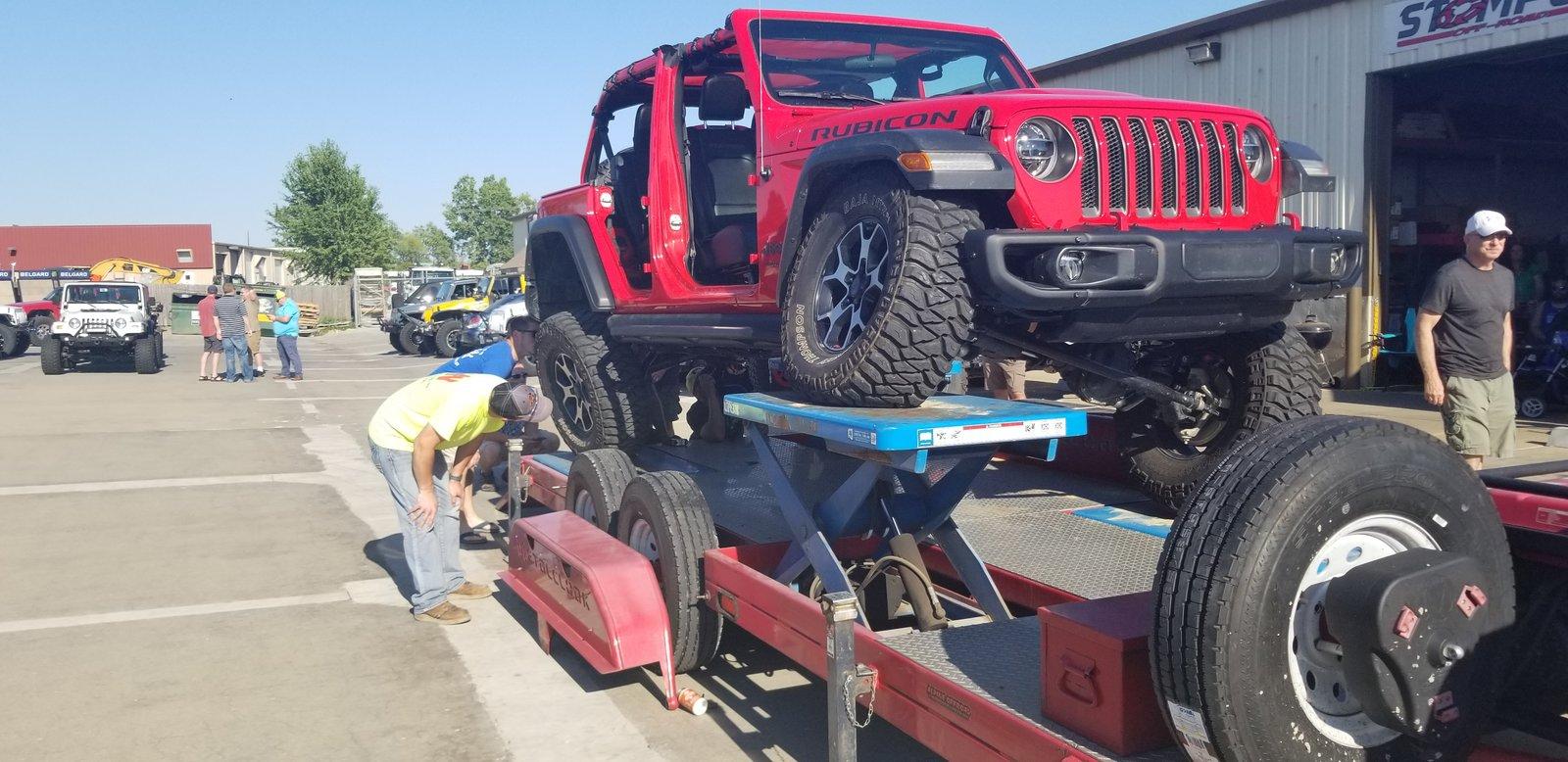

For comparison, my buddy in a JK with 2" bumpstops, MC 3.5 springs and rocksport shocks, Currie lower adjustable control arms, and stock uppers scored an 830 without deflating his tires. Granted a JK isn't a JL, but a JL is supposed to be superior. For having a fraction of the cost into his piecemeal kit, he scored just as well.
Another guy with no lift and 38s scored a 600. Pics attached of all 3
