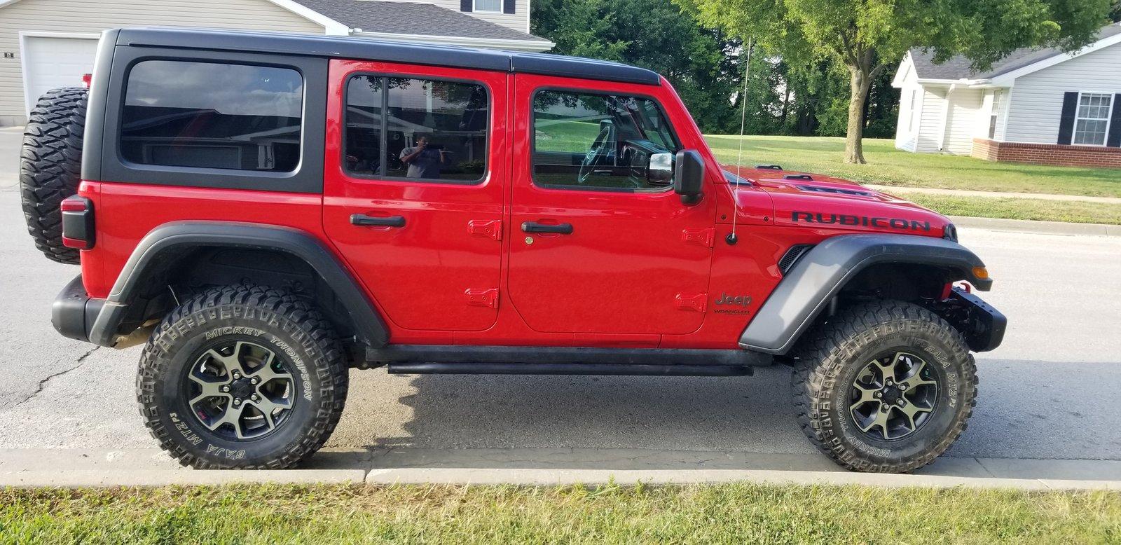

8 3/4 rear, 8 1/2 front are my measurements from center of tire to center of fender well. Less if I go from center of tire to fender lip. That means I gained 3/4 an inch in the front, and 1/4 an inch in the rear. That's with no weight addons.
Damn barely anything over the spacers.

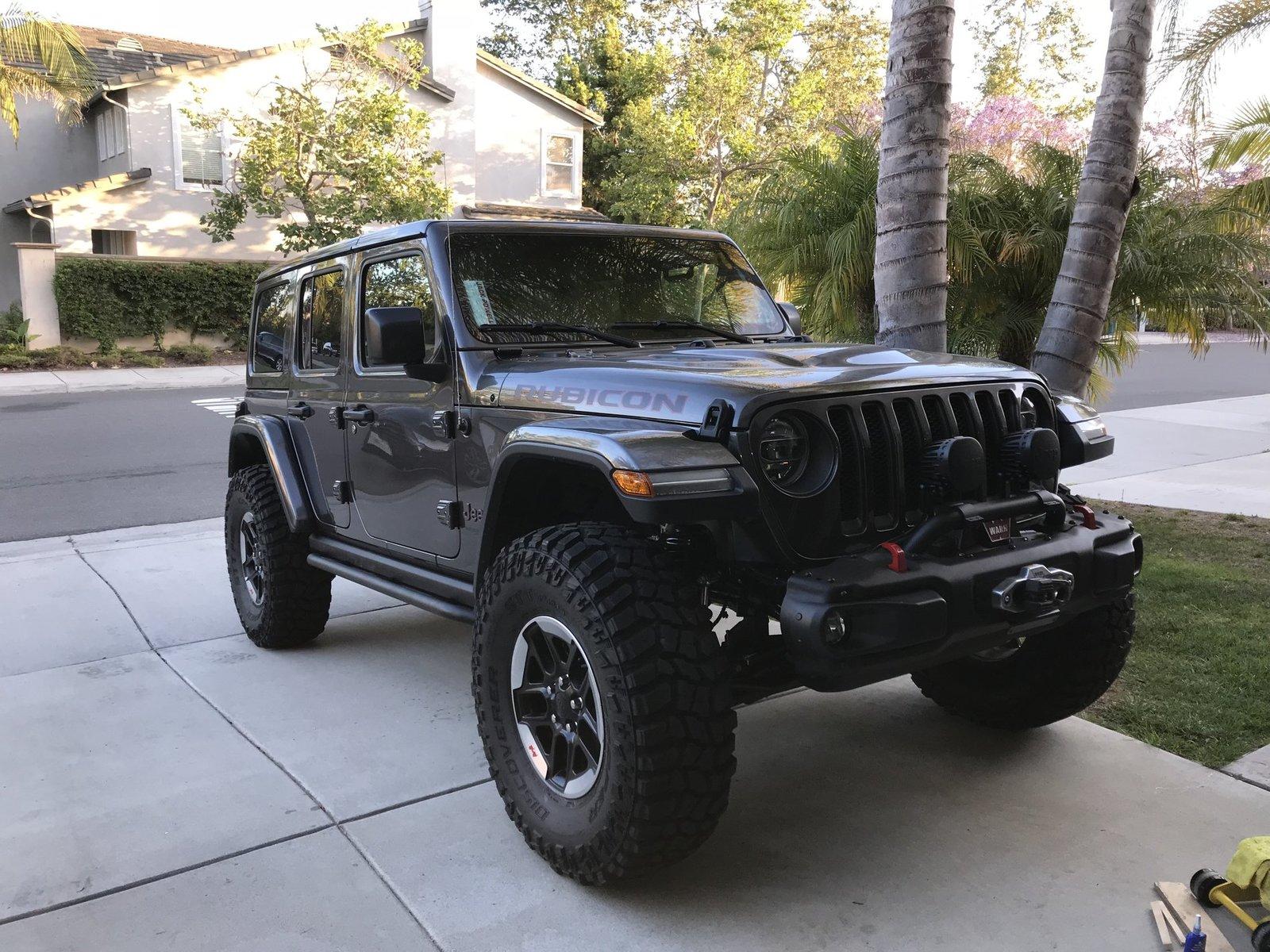

Here is what my RK 2.5 xfactor looks like with 37’s
I would prefer stiffer or taller rear springs,

When you say Jay, I am guessing Stomper? Anyway, I have the mopar, I think I am just under 3”, I have 37s, they only catch the fender in the rear, and its not bad. I have been debating switching to either RK or MC, sounds like MC may be my best bet.
Stiffer would of course ride firmer. Taller we have. We try to maintain a good quality ride while adding major performance improvements both on road and off road.
I will confirm ride quality is awesome. Even the normal JL springs you put weight in the back and it gets a lot of drop. My comment was a preference one, related to the amount of gear I am usually hauling, also daughter and giant bull dog in the back..
I will probably upgrade to the 3.5 next year.
Oh and yes there is NO bow.
Looking good, Im glad my 2-door will net a little more height. Are you running wheel spacers on those stock wheels? If so, which ones?
