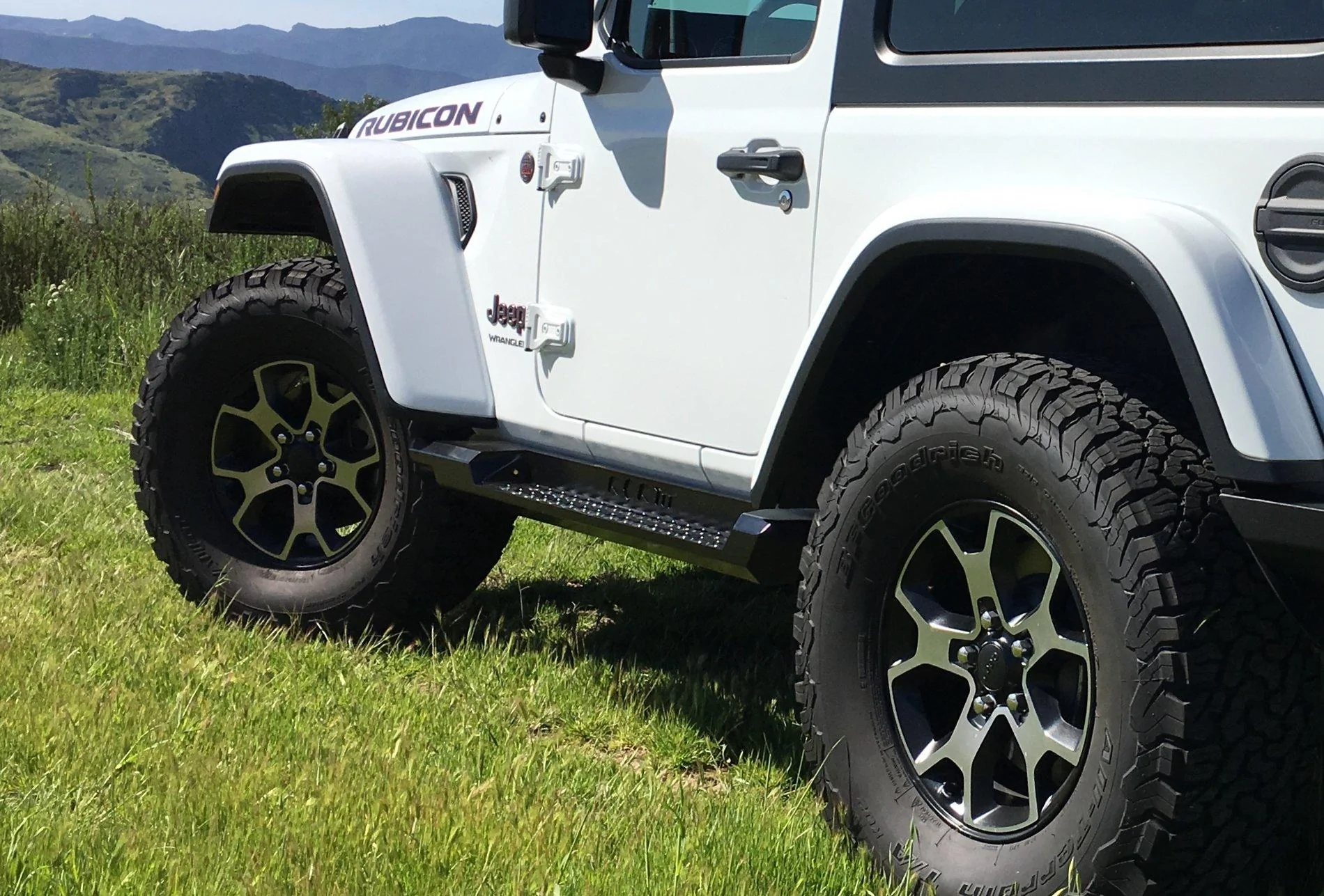

I have received and installed my ROAM frame mounted sliders. Luckily the two door doesn’t require the needed for the four door, so the installation wasn’t too bad. I really like how they look.
I opted to swap out the LEDs that came with the steps for Ozmium lights per the suggestion of @TTEChris, though I still need to finish wiring them up.

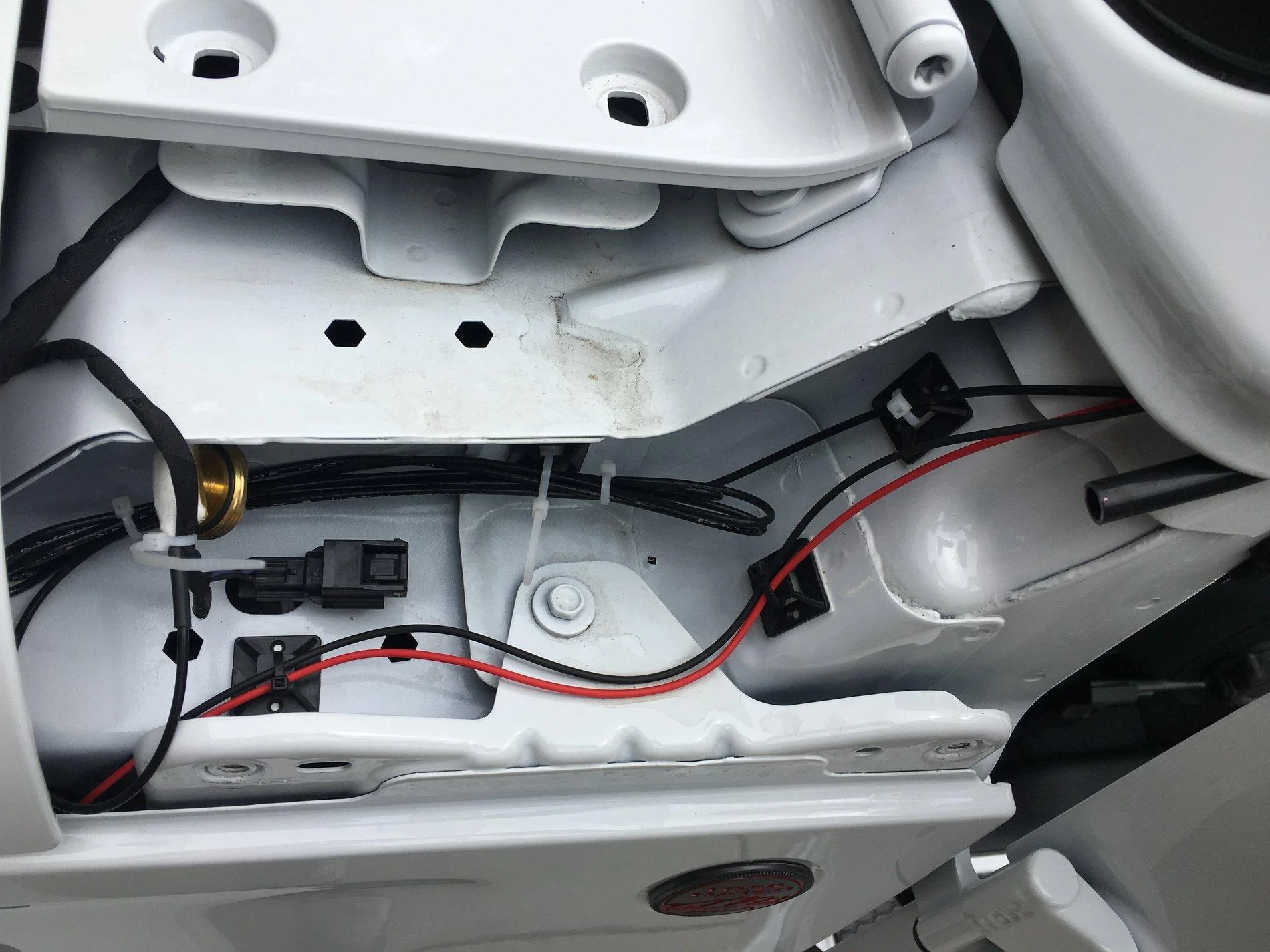

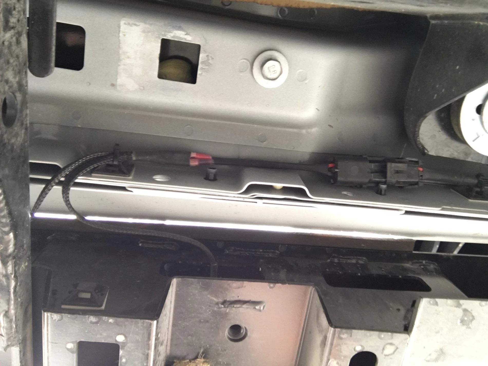

I agree. I do like the looks of these steps. I used the 1W version of the Ozmium LED that @TTEChris referenced. I wish it had an eyelid or something to block the light emitting up because it can be annoying. I can only imagine what the 3W light is like! I ordered the LEDs without a lense. Maybe those with the lense are a little more directional.
On the install I used a weatherpack connector mounted inside the pinch seam in case I need to remove the step in the future. I ran the wires inside the quarter panel from the base of the fender to the cowl on each side, I entered the cabin at the base of the windshield because I didn’t want to deal with the firewall, and then connected straight to the curtesy light in each footwell. So far, so good.

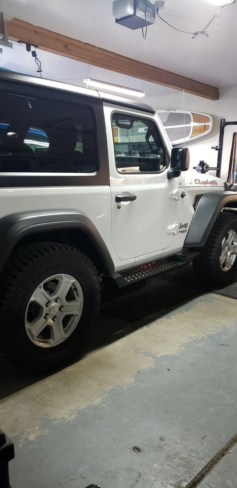

Just installed ours on my daughter's 2dr
Jeep Wrangler JL Roam 2 door side steps out! 20190404_232058

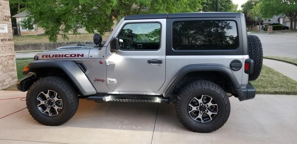

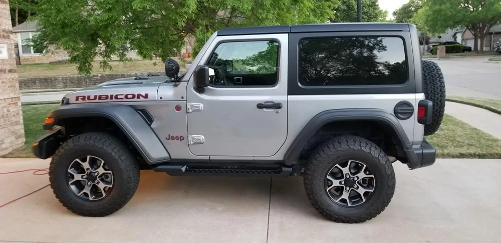

Finally got mine installed as well... I had already installed a rock light under each mirror, so I just used the LEDs that came with the steps. The combination puts a lot of light on the steps.
Overall, I'm very pleased with the design of the steps, and it's easier to get in and out of the Jeep.
