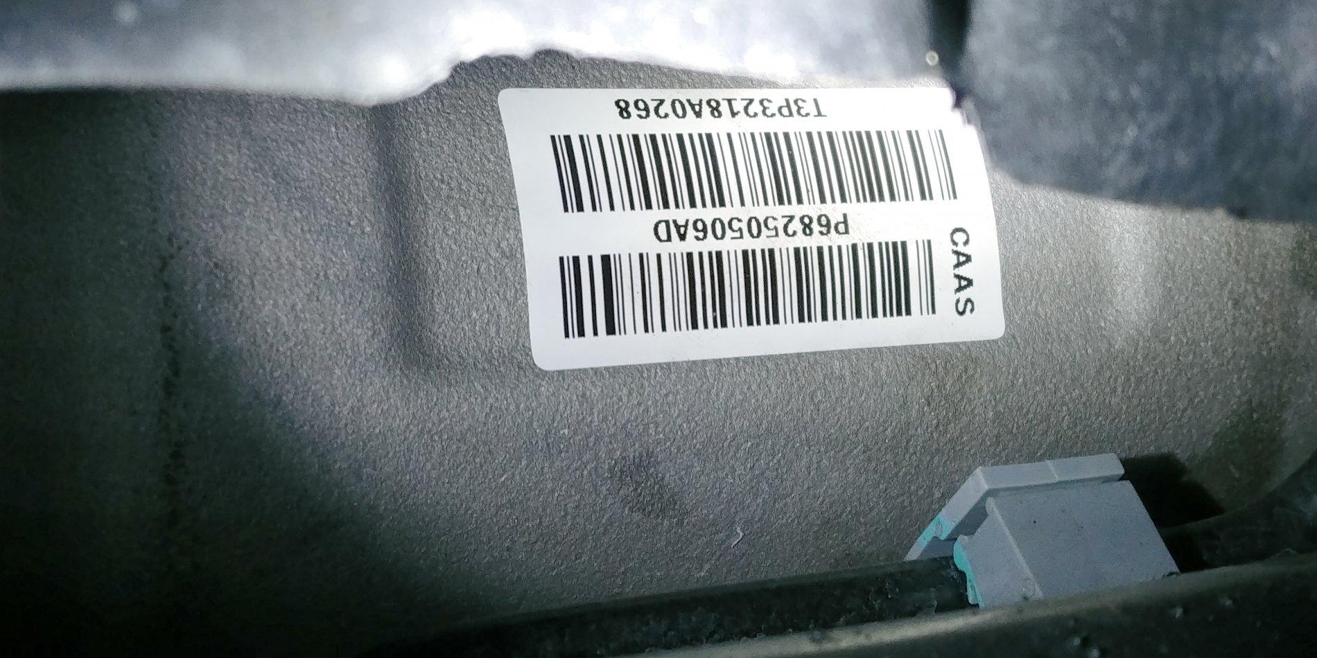

Just had my JLUR repaired today. It's no better than before. Same amount a free play and actually has a bogging feel when turning right. Also, looks like this new TSB is not using the cast iron housed steering gear. Looks like the exact aluminum housed one I had before.
Jeep Wrangler JL Right Drift after Steering TSB 0120211410_HDR
