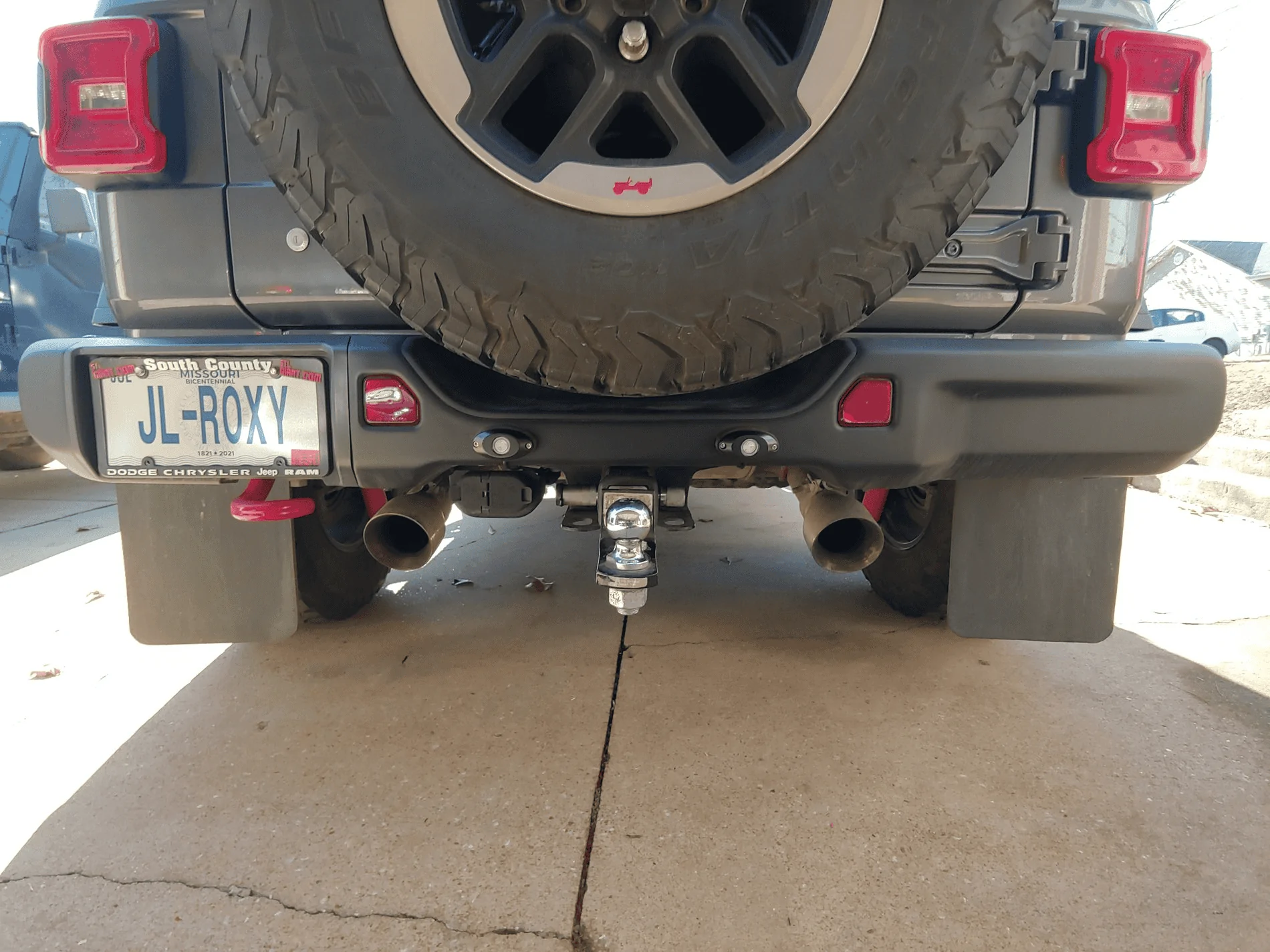

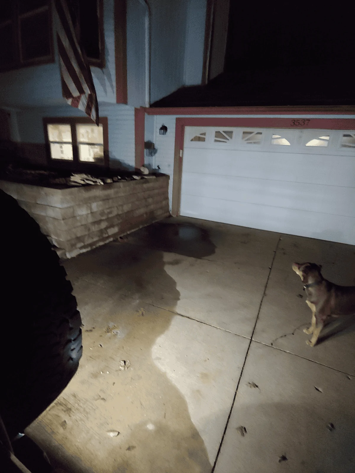

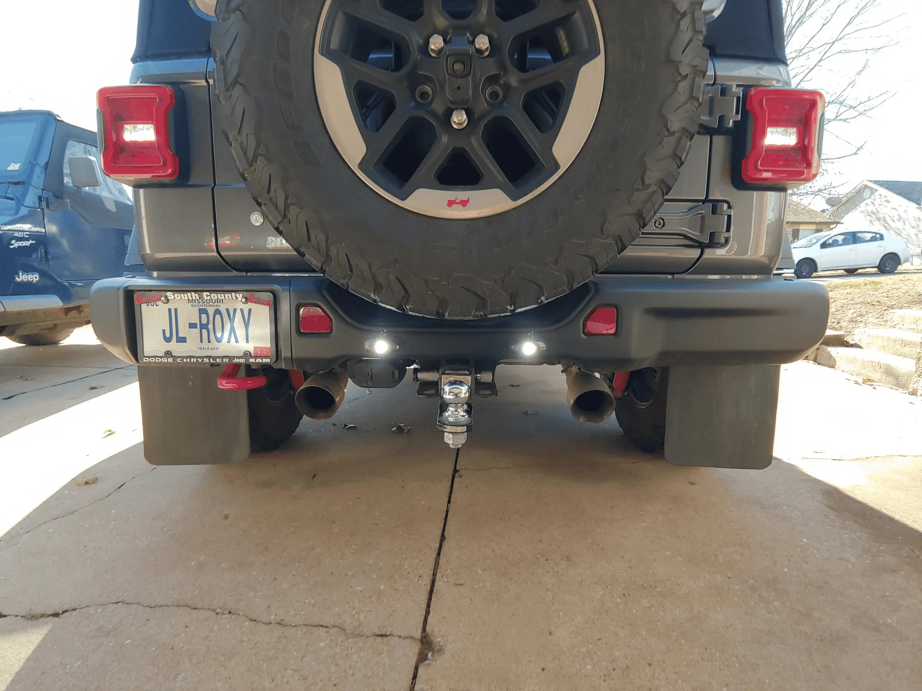

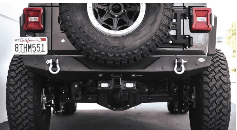

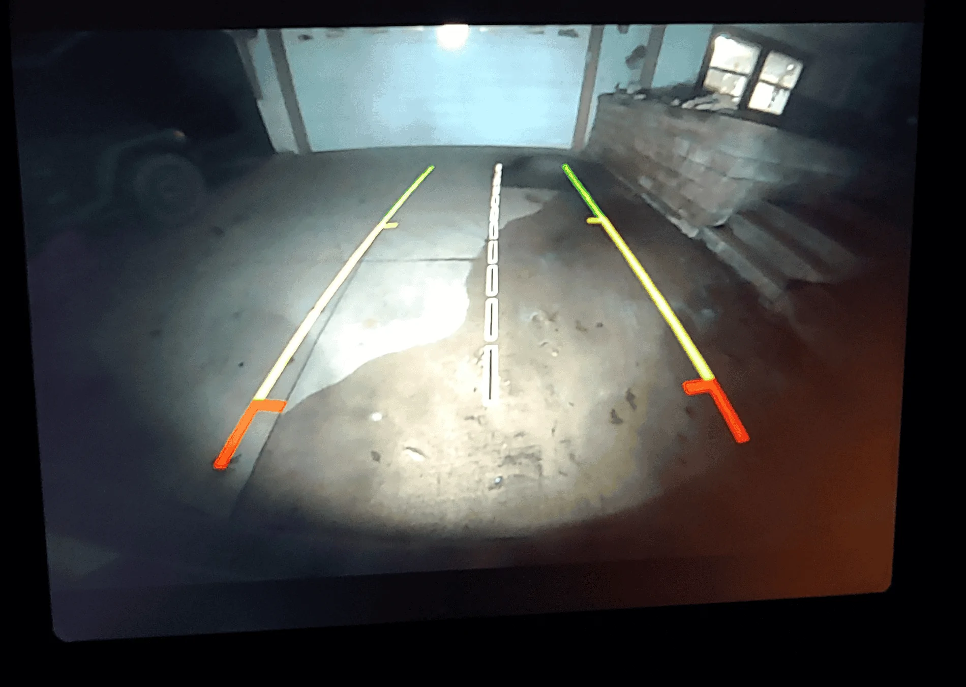

I went with SuperbrightLEDs Replacement Rock Lights. I did just the two pods because I didn't want a whole set. I am VERY please with these lights. Good rugged housing (aluminum), good looks, and super bright leds!! LOL THey have been there for 2 years and no issues. I used a self-tapping screw to attach the lights to the bumper (drilled a small pilot hole before finishing the hole with the screws). Wired the lights into the 7-pin connector wire for the back-up lights.

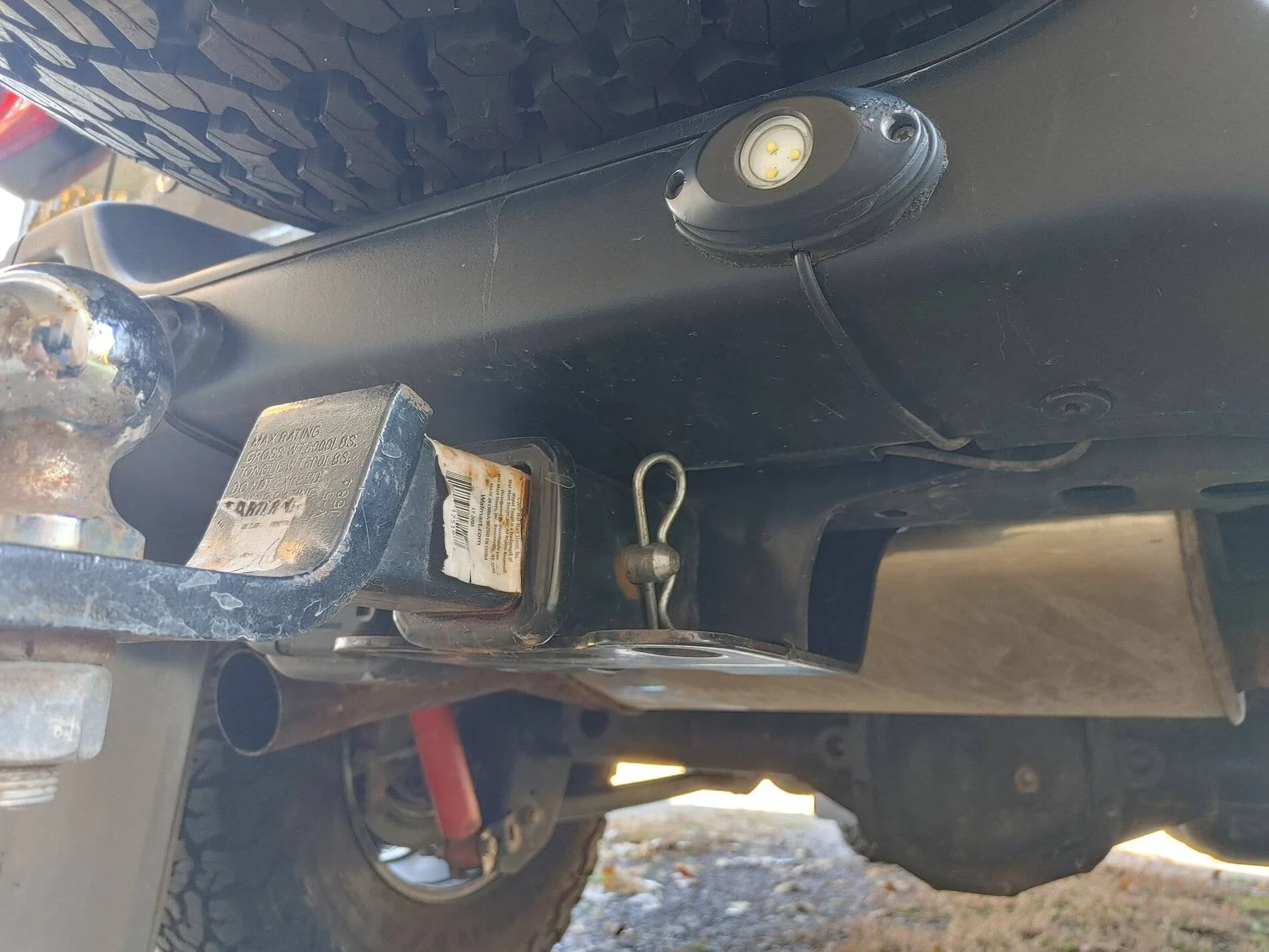

Those look good... Light output / flood looks decent..

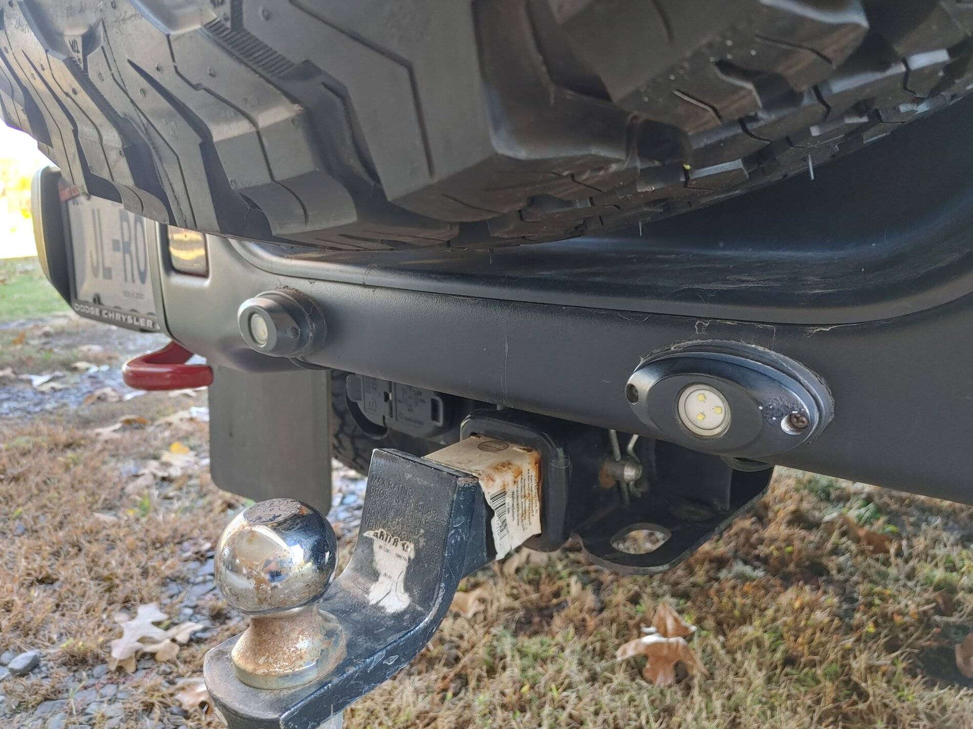

Any chance you could take a closeup pic of one of those installed lights and post here. Thanks in advance.

Hope these work...let me know if more are needed.

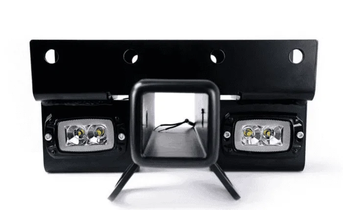

Looking at the pic, I don't see how (I could be mistaken as I have not seen the light bracket in person) the left light and it's bracket clears the the oval shaped box that holds the 7 pin/4 connectors.. So not plug and play, you'd need to do some jury rigging so to speak it seems when installing those.. Problem is, there is little free play in the wiring going to the connector box so moving it may be an issue.
Very good point! I might call the company tomorrow & get more info. I will then post any findings.

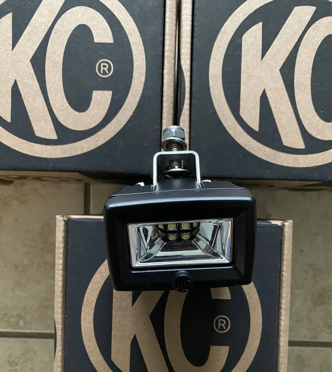

i have the KC backups too. great light and phenomenal people to work with. they replaced one that i've had for about a year with no questions/no hassle.

I am still extremely pleased with the lights. I can see everything I need to when backing up. WAY BETTER THAN STOCK!!!
