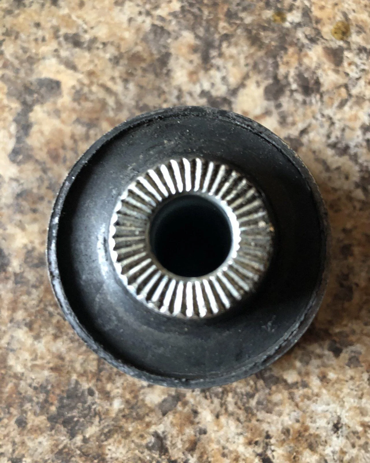

Do you have pic of yours ?Curious as to your upper bushing condition as you wheel harder then I do......

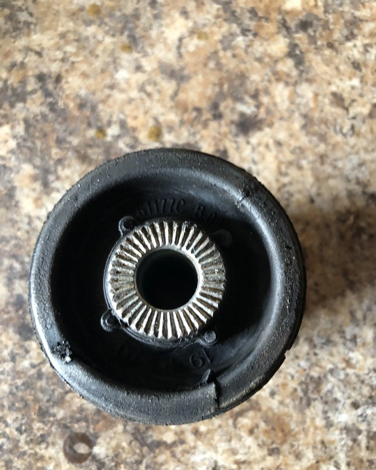

Tossed them out without taking pictures as it was obviously failed. Joys of sharing a garage workbench with my wifeDo you have pic of yours ?
I got the drivers side in after work today, to freakin tired...? to do the passenger side it’s an old man thing, lol. My oem bushing looks brand new, I was surprised, expected more carnage......? .Tossed them out without taking pictures as it was obviously failed. Joys of sharing a garage workbench with my wife![]()
Yeah I wonder how much these are getting trashed by people torquing them without being on the ground.I got the drivers side in after work today, to freakin tired...? to do the passenger side it’s an old man thing, lol. My oem bushing looks brand new, I was surprised, expected more carnage......? .
Yeah....good question, they’re tougher than I thought they were, as much as they’ve been flexed out, I expected them to be ripped.Yeah I wonder how much these are getting trashed by people torquing them without being on the ground.
I torqued mine on the ground at ride height - firm believer in doing it that way even if it means some sore arms getting to those torque #'s without a lot of room.Yeah I wonder how much these are getting trashed by people torquing them without being on the ground.
Yes. That’s why any control arms with a rubber bushing need to be torqued with the vehicle on the ground.Is the idea that the bushings do not rotate freely and are best positioned so the mid point of the elastomers' range of motion coincides with the "neutral" or at rest position of the control arm?
