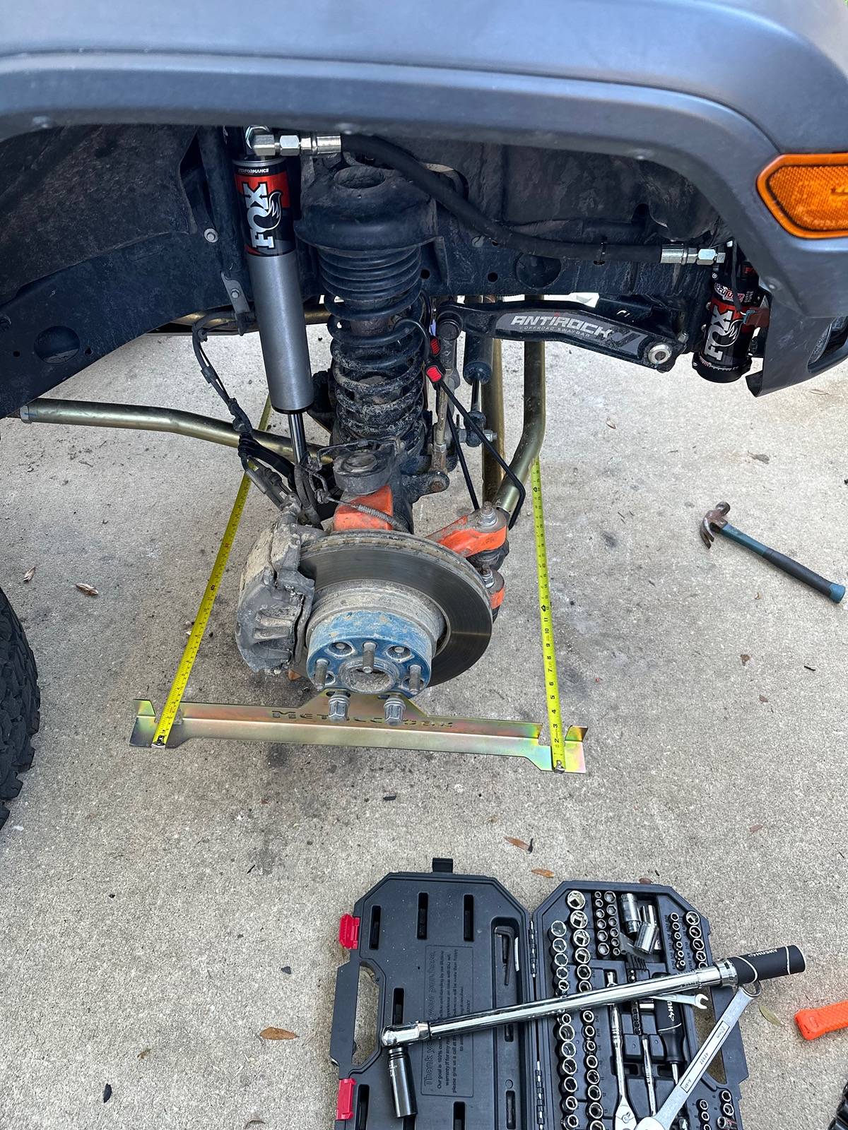

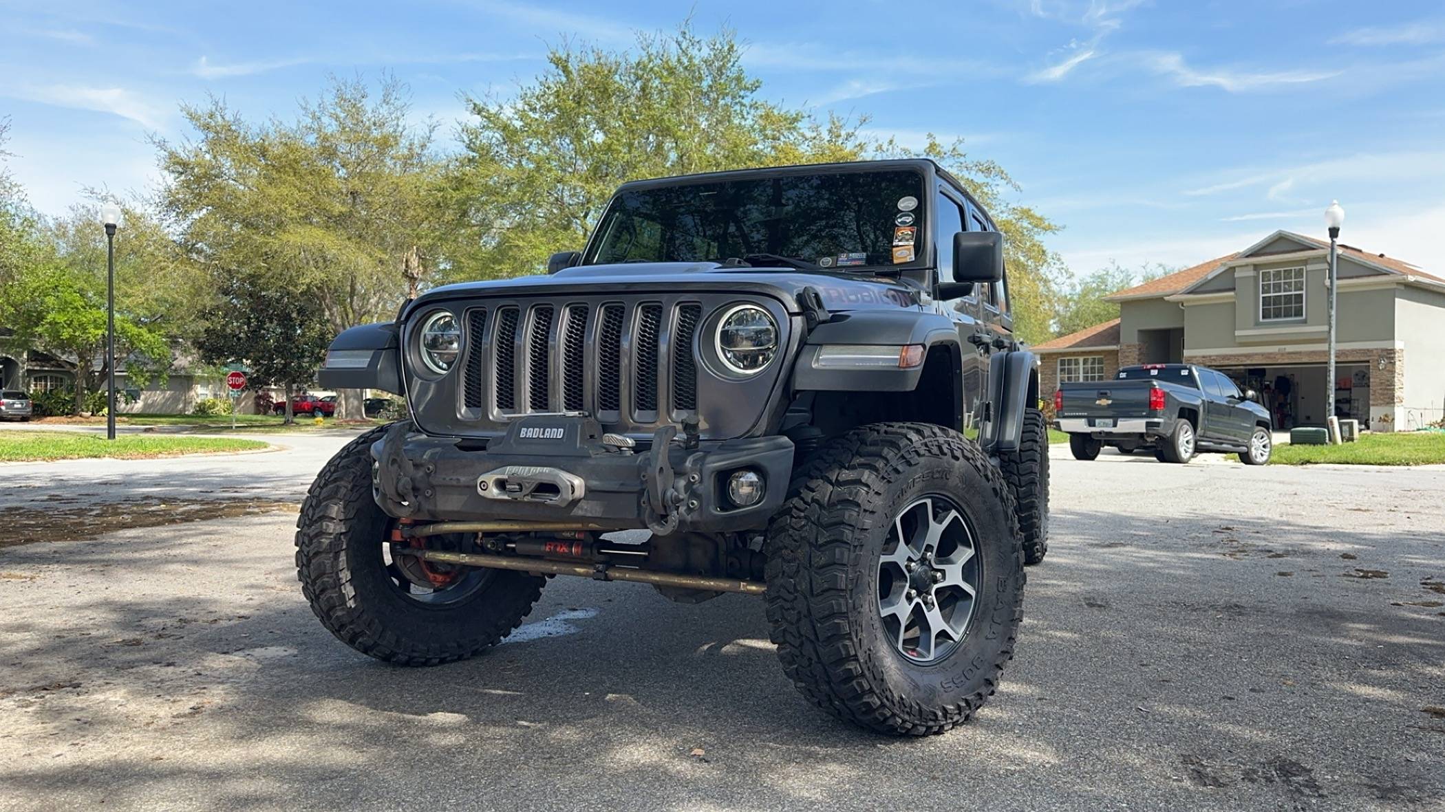

I also have these knuckles on the d44 and installing them was straight forward no extra work. Been able to get up to 57 mph on the whoops and open sand, 2.0 4cyl is now my limiting factor
