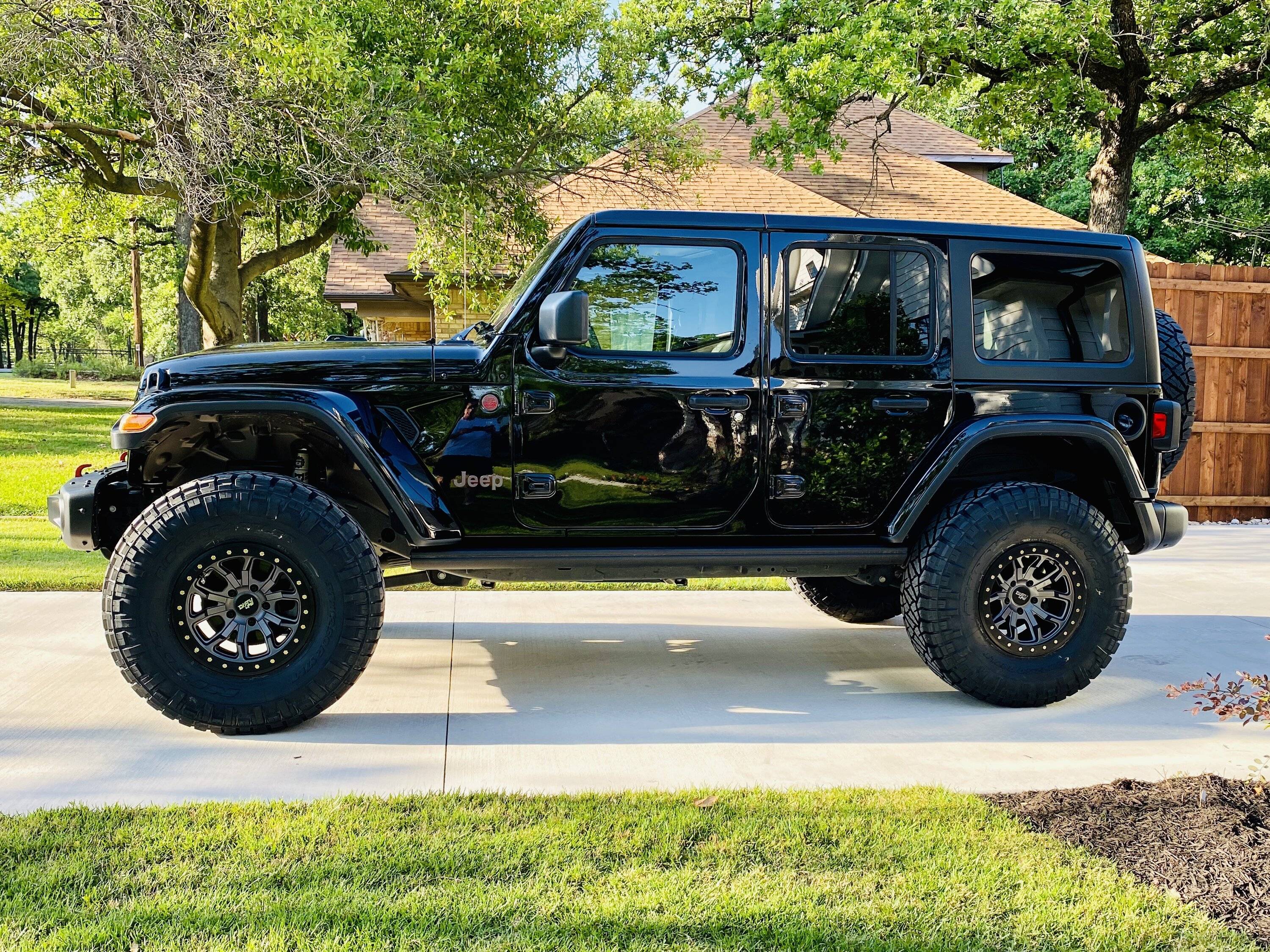

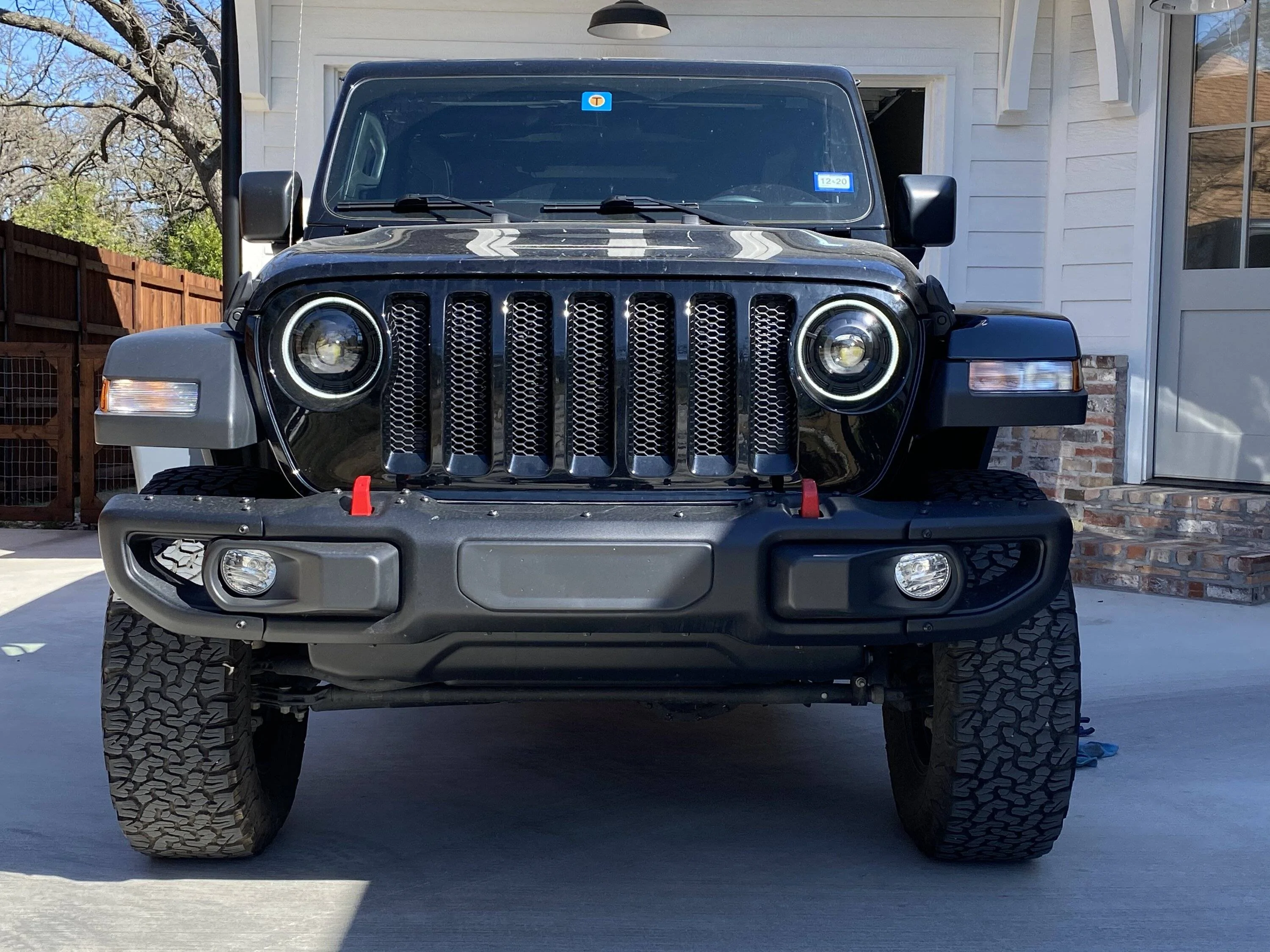

I drive on highway everyday for roughly 1 hour back and forth at work and i go around 70 few times 80mp and only few times i have seen the 8 gear.
Probably not the best reference but - My pavement princess was on stock gears with 37s and never bothered me on the highway 70-80mph. Around town it was great. Here is a pic to show you the difference in standard flares and Rubicon flares, you can see at least 2"s of clearance. I must mention, these pics are with Mopar 2" lift as well.
