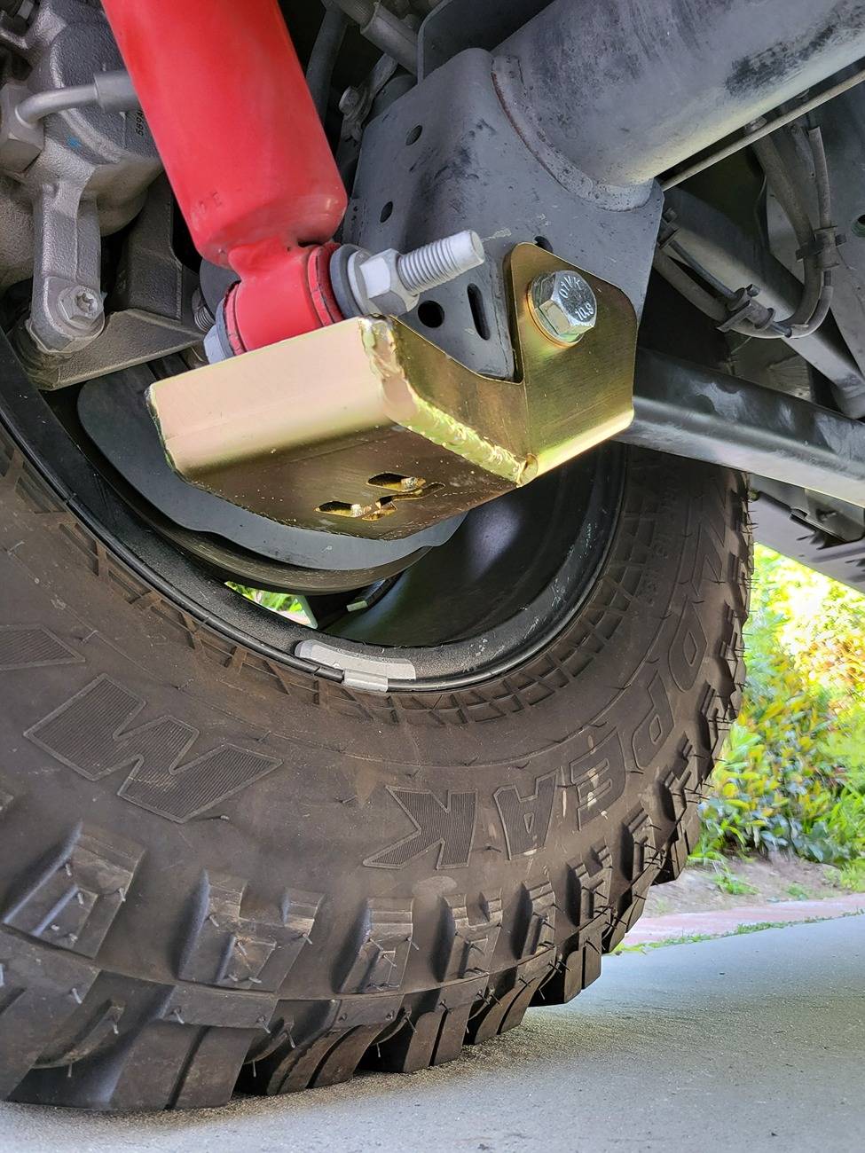

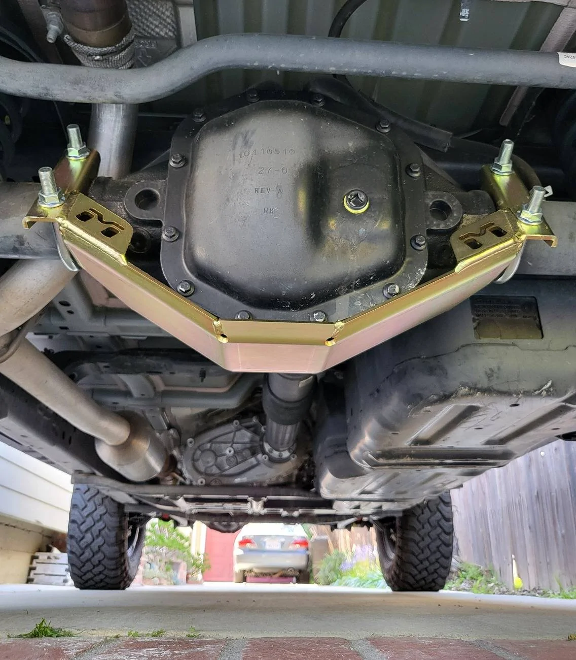

Rear diff skid and rear shock mounts skid. The two areas that I hit the most on stock suspension. I went with these two... MetalCloak.
Jeep Wrangler JL Recommended Skid Plates for Moderate Trails 20240317_174320
Jeep Wrangler JL Recommended Skid Plates for Moderate Trails 20240317_160642
Jeep Wrangler JL Recommended Skid Plates for Moderate Trails 20240319_150749(1)
Jeep Wrangler JL Recommended Skid Plates for Moderate Trails 20240318_132819
