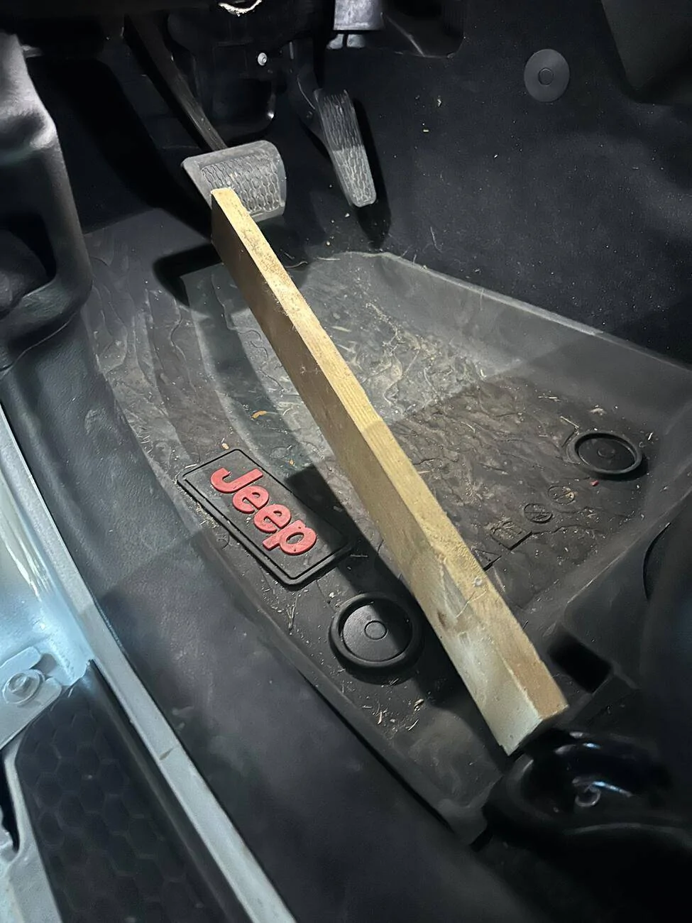

Wouldn't it be easier to just press the brake pedal down with a 2x4 (or something similar) captured with the driver's seat?

I do this all the time..as was said use a piece of 2x2 or 2x4 to wedge the brake peddle down super easy to do that way. when I run my stock wheels I run 1" BORA spacers and when I run my AEV wheels I pull the spacers off so super easy doing it this way.
