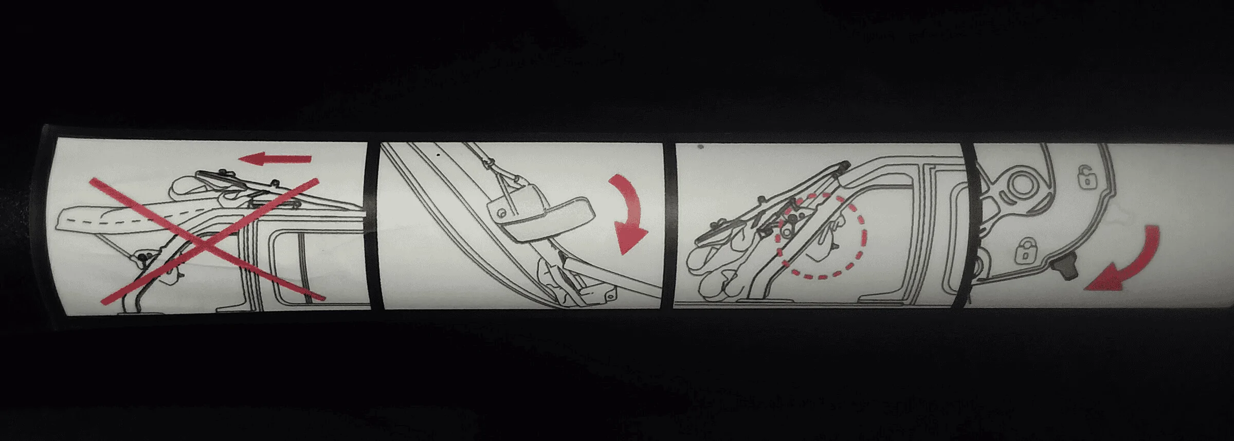

Here's the factory label that is attached to the soft top's folding hardware. There's one on each side of the vehicle.
Note that Safari Mode is fine so long as the forward portion of the top isn't also folded back.

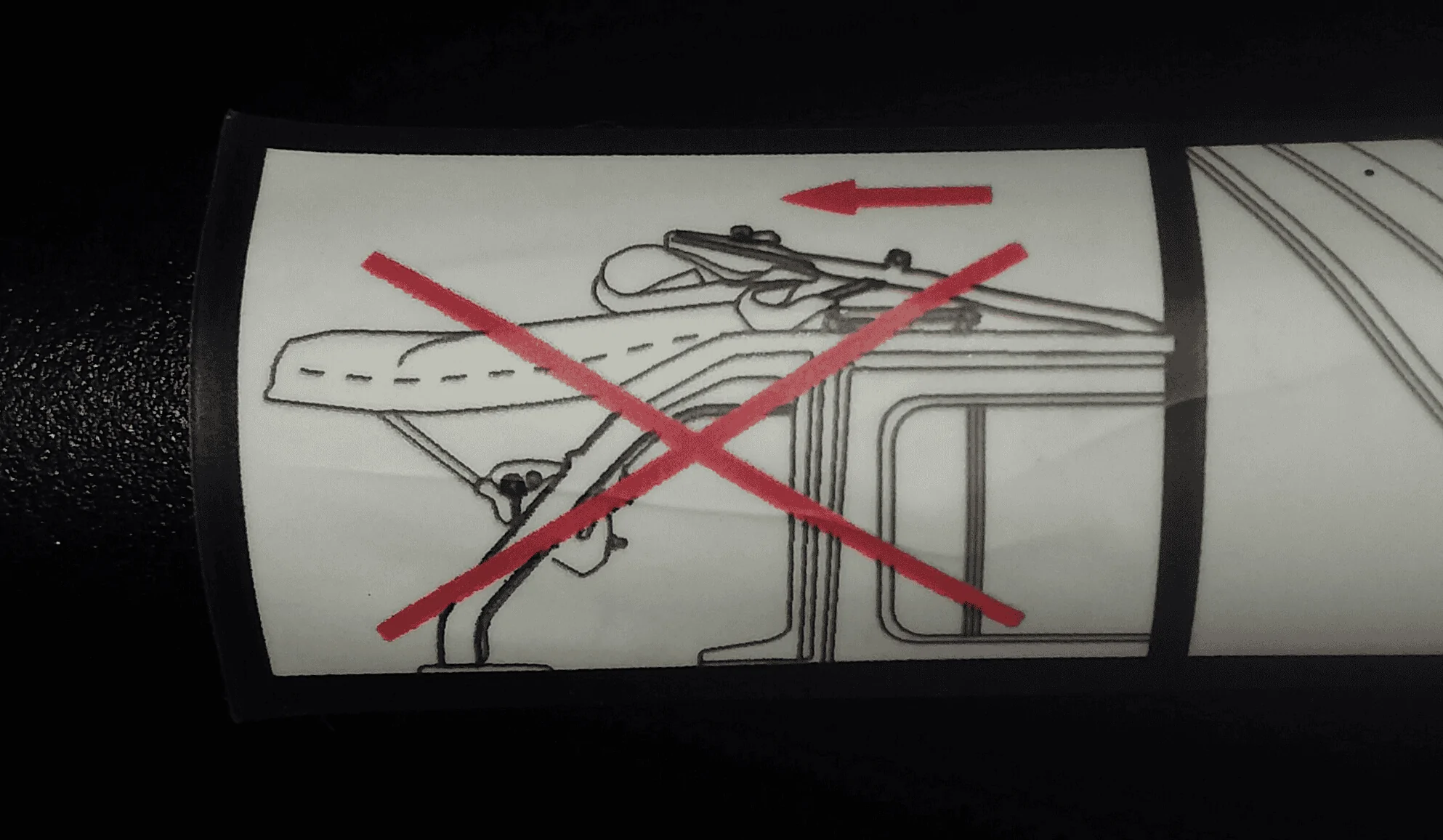

The relevant bit:

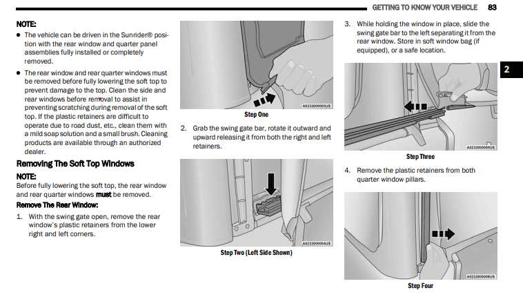

I see your argument, but that's not how I took that graphic a all. It's instructions for how to put the top back, not recommendations on driving configurations. That graphic, to me, is saying you can't push the top all the way back while the back is locked upright, but instead you have to use the rear latch under the top and then make sure to lock it once down.
Maybe I'm wrong.... but that's how I read it.
EDIT: Found this in the owners manual. First note says it's ok.
That was also my initial perception when I noticed the label during my pre-delivery inspection. I mentioned it to my salesman, who is also a Wrangler owner. He clarified that the vehicle should not be driven with the soft top in a joint Sunrider/Safari mode, suggesting that the effects of windblast on an unlatched/unsupported soft top could be problematic.
I know there are owners who will claim that having the soft top configured in that hybrid position will cause no harm. Perhaps they're correct. Or not. I'm just passing on the intel for general consideration. :beer:

I think it's saying don't move it into Sunrider position and then move the whole roof into the retracted position. So, you skip the Sunrider step if you are going full topless.
I've watched a bunch of videos showing Sunrider position then roof "removal" (completely down,) but then I saw one video where the guy just unhooked the front latches and rear lock(s,) then moved the whole thing into the retracted position in one smooth movement. IMHO, this graphic is saying the second guy is doing it "correctly."
