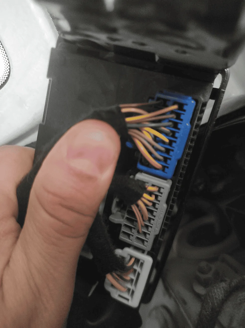

From this, we can have 2 solenoid that catch the dtcm signal to the locker activation, so we can have selectable factory or switch enabled
