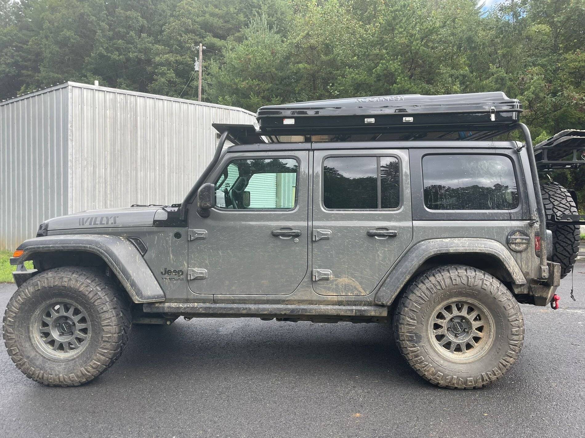

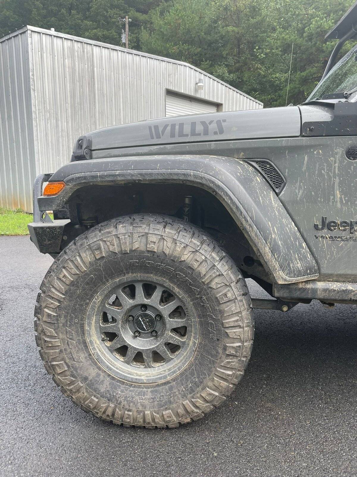

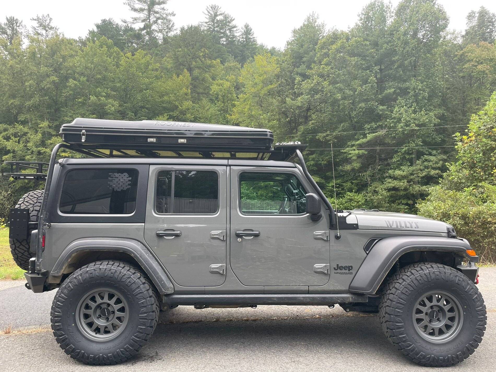

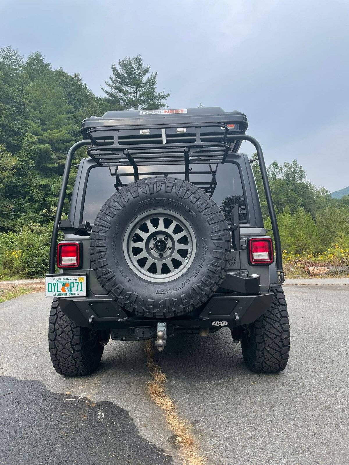

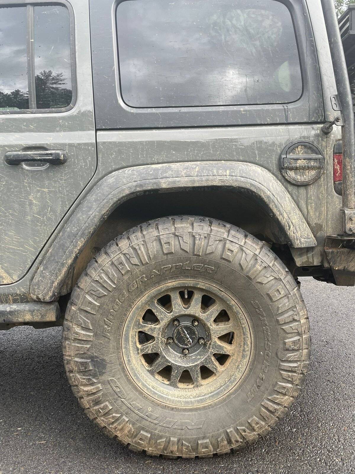

Hello All,
So first time lifting anything.. I'm having some serious sagging issues in the rear of the jeep with all the extra weight we have in the back. The issue was I went from stock 33s and suspension to installing the build below with a LOD Destroy steel bumper, and i have a roof top tent, and a custom cargo box built out of wood in the back of the jeep. Box probably weighs ~150lbs empty.. Fully loaded with fridge and gear probably 250-300lbs. All of this plus the 37" tire hanging in the back has caused some serious sag.
The build is
Teraflex St3 3.5" Lift Kit
Falcon SP2 2.1 Monotube Shocks
37x12.5 Nitto Ridge Grapplers
Method 704 17x8 Wheels
LOD Destroyer Shorty Front and Rear Bumper
Warn 10k Winch in the front
I've been doing some research but not really sure what's the best way to approach this issue, and get the jeep leveled out. I don't think reducing weight is an option as I would have to redo my entire setup inside, and change the bumper (i love the look of the bumper).
I have read about changing springs to something like these for 'heavy load' https://www.morris4x4center.com/old...-load-coil-springs-for-2-5-3-5-lift-pair.html
Or going with an air spring like these https://www.cjponyparts.com/media/images/install-pdf/install_air60829.pdf.
I'm open to suggestions, I plan to do a lot of off road miles, and trails out in west side of the US as we travel out there. It's important that we keep daily drivability but also not lose any off-road performance.

If you unload your Jeep in between trips heavy duty springs are going to ride harsh and tall in the rear unloaded, use the airbags. If you are always going to be heavy consider the heavy duty springs. IMO of course.

I can't tell exactly how level you are from pics but measuring the rockers is the best way to go. The rear fenders are lower than the front so visually comparing gaps at the top of the tire(s) is meaningless.
I hope the air springs get you where you wanna be. Another option might be MetalCloak rear 3.5 springs as MC tends to sit very high unloaded, their reasoning being they're accounting for car camper (er, sorry the kool kids say "overlanding") and aftermarket bumper weight.
That said, I have no idea how the Teraflex spring rates compare to MC -- they may be very similar?
