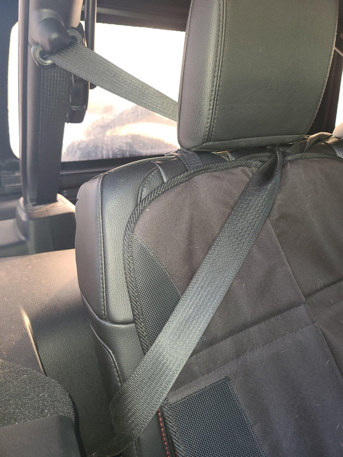

So my kid did this. She "locked" the belt with no slack. I either remove the headrest, disconnect the belt pulley, or never have a seat belt for that seat.
Ideas?
Ideas?
God, that sucks!
Is the anchor point on the floor accessible? It used to be just a T60 or something on my TJ. I'd look for myself but it's freezing out.

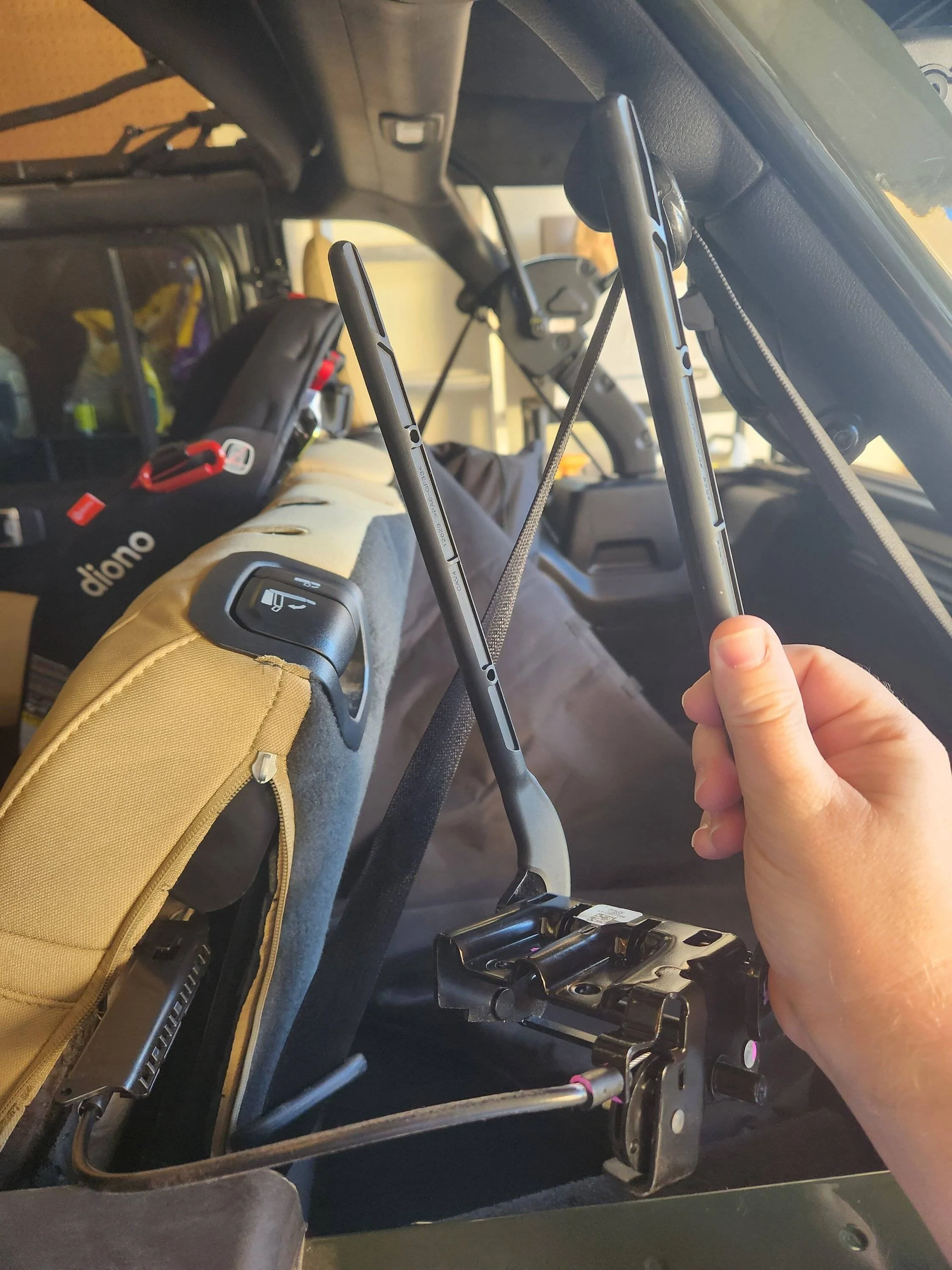

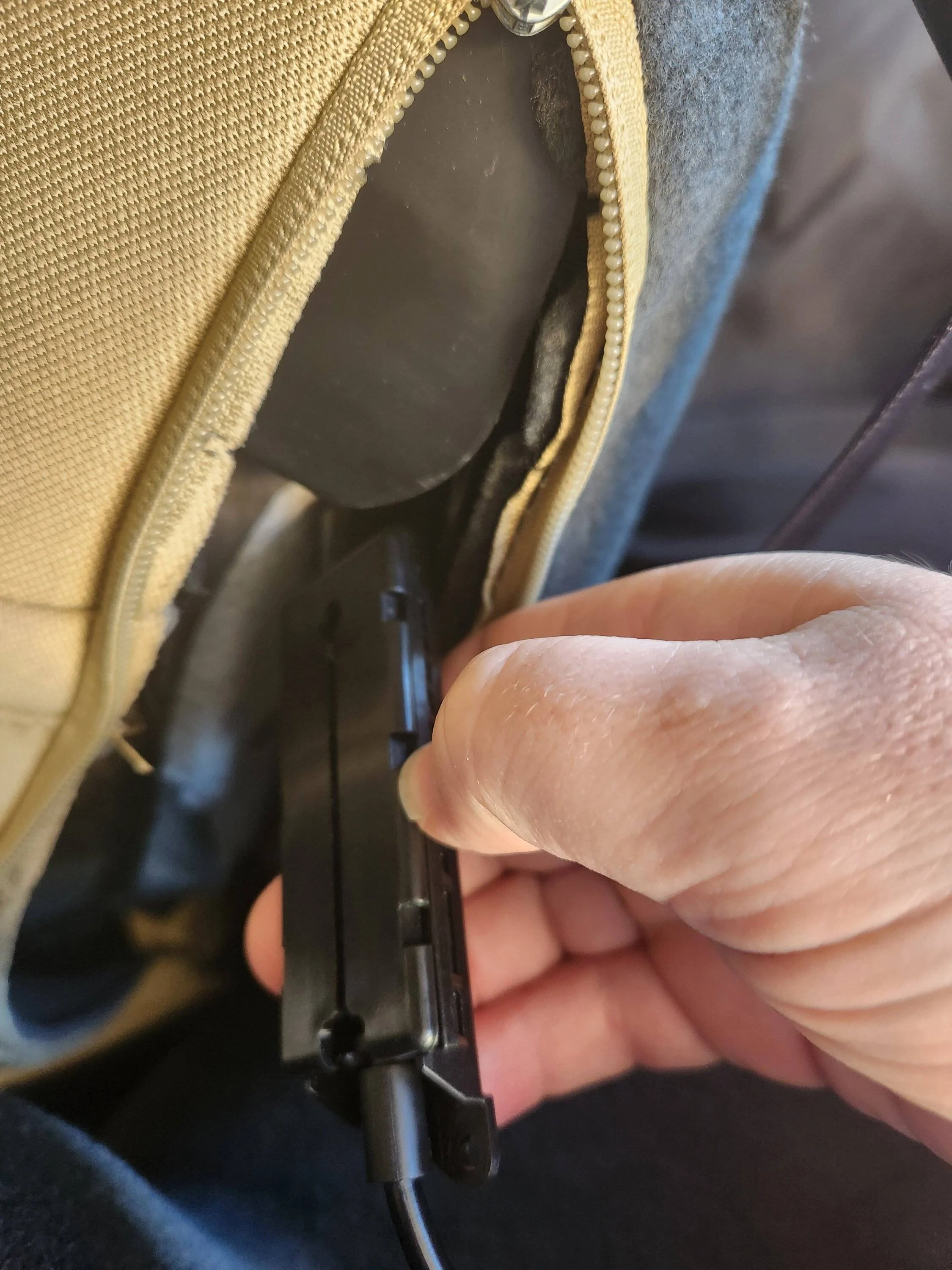

I will make a write-up. But I'm stuck halfway. How do I disconnect the release cable? Is it related to that little box I'm holding?
This I great! Did you figure out how to disconnect it? Do you still need help? Would love the write-up!!
Yes! I did! Atleast one side. I need to see if the otherside is the same.
Not reading the entire thread but do they not just pull off the mounting poles like the 2 door rear?
Nope haha. Quite non-trivial removal.
