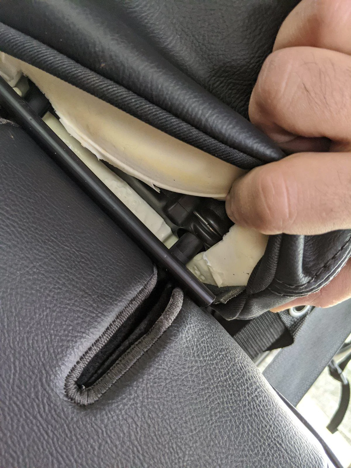

THIS DOESNT WORK, the plate on the back of the rear bench seat is riveted to the frame (must be different on the gladiator), there is no way to access the headrest mechanism without cutting off rivets, that was one step too far for me lol, I DID however get the headrest cushions off and that allowed the carseats to now sit against the seats, i will post pictures in the next comment

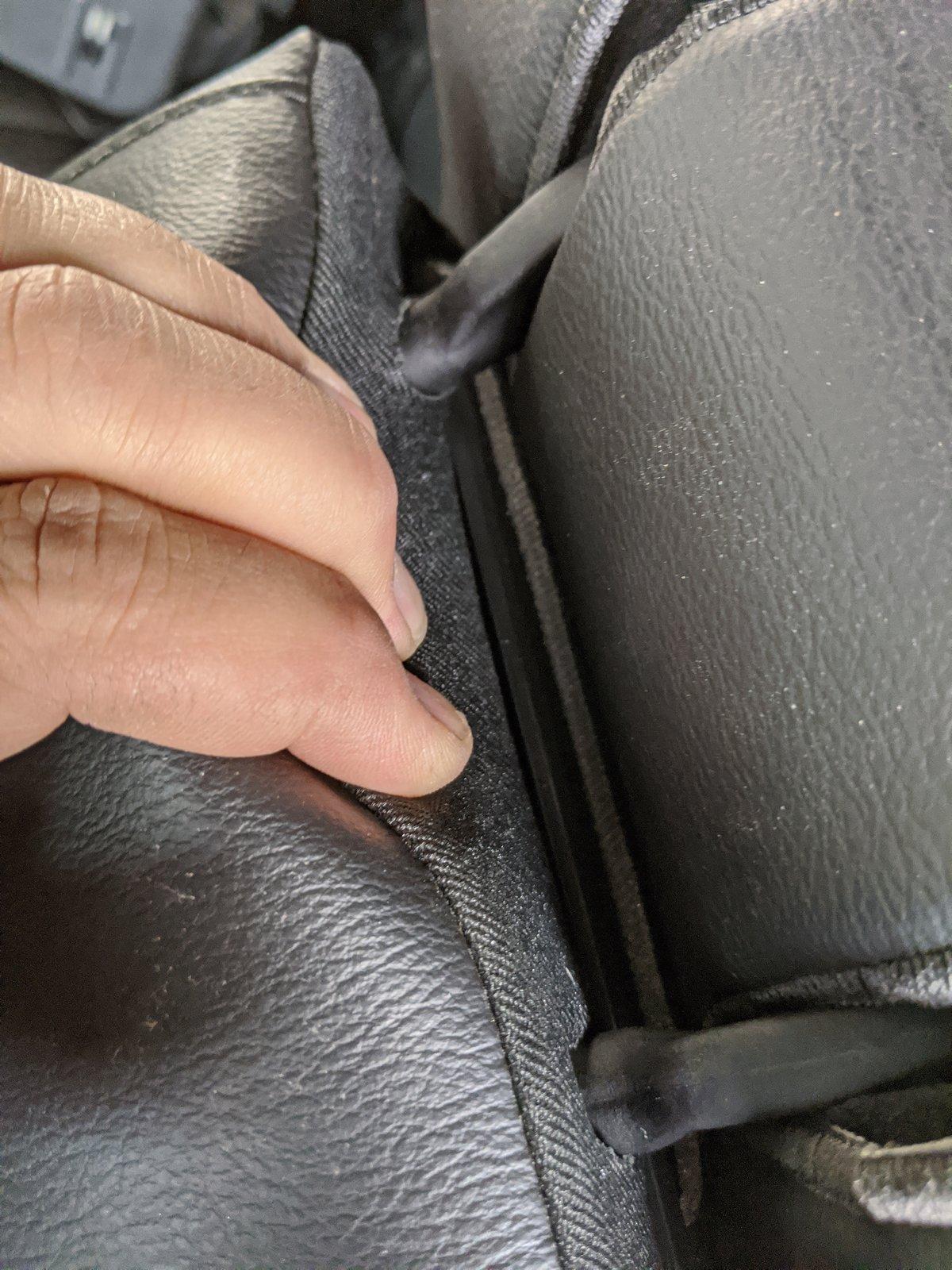

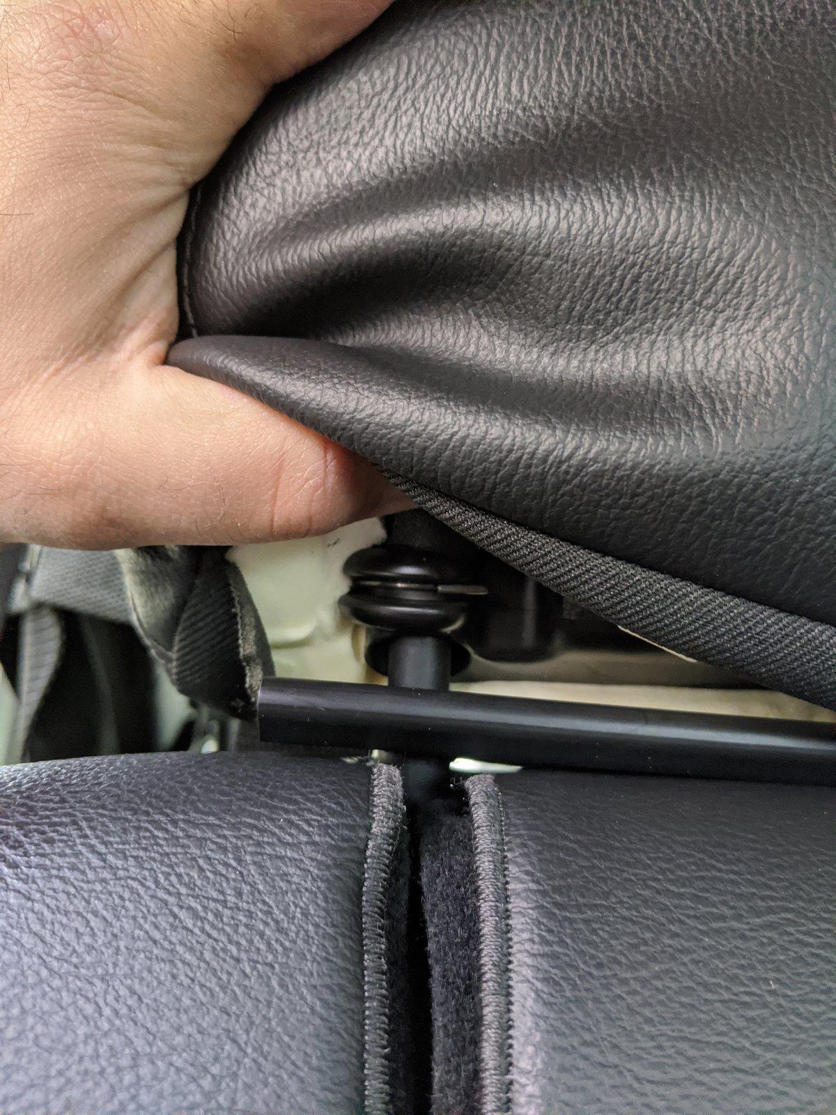

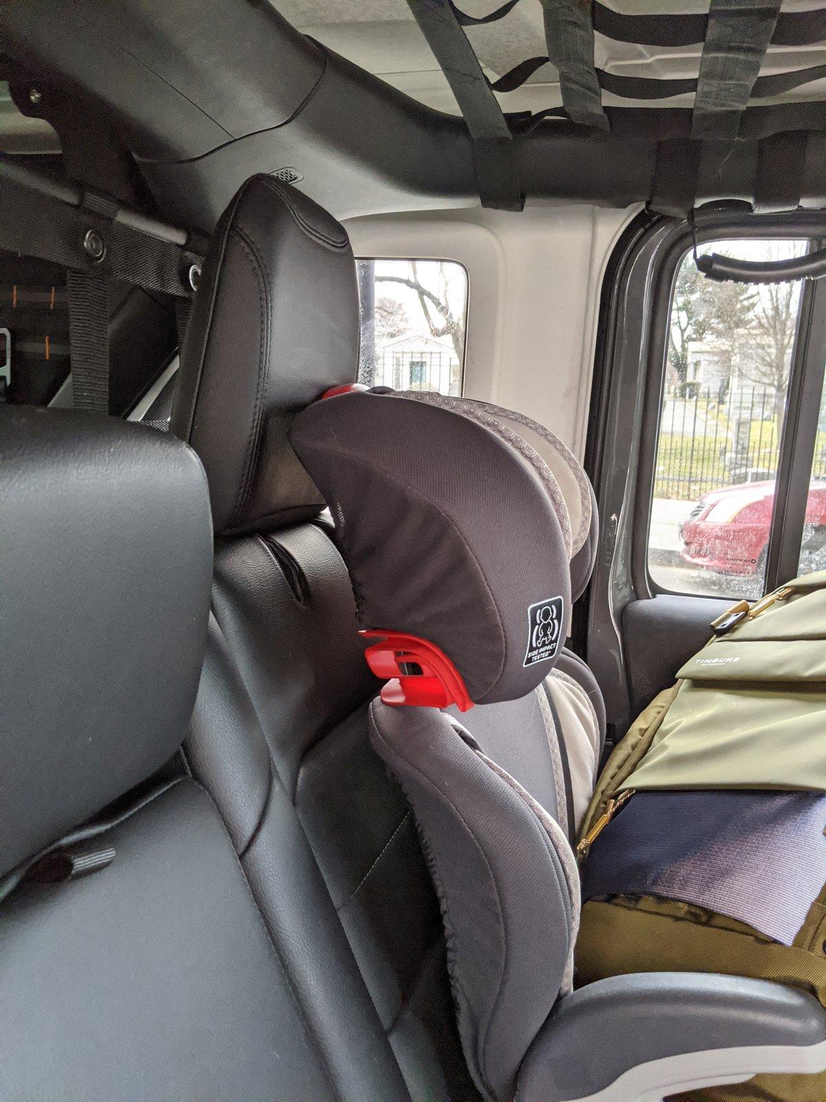

Looks a bit odd with these 4 posts sticking up, you can see before and after headrest cushion removal.
To remove the cushion you just need to undo the cover at the bottom of the head rest, then there are 2 spring clips holding the cushion in place, remove those and you just pull off thie cushions, no damage. Pics attached if everything, sorry it's not organized I'm rushing in between things at work.
Note that I have the recline kit installed, if you didn't do this, your results won't be as good.

Won't be as good as far as the booster seat not contacting the headrest?
I agree it does look funny, but at least they're black and not silver. It's actually really weird that they're not, like Jeep knew we'd be forced to do it. If I go this route I'll probably find something kind of fabric to go over them. You've got enough going on with that cargo net that it's not so noticeable.
The posts are actually a bit flexible so it could be that you would have your car seat sitting flush against the seat without the recline kit but I couldn't tell you that for sure because I have the recline kit installed, your idea about covering them with fabric is not bad I could even just put a knitted hat on it and call it a day
