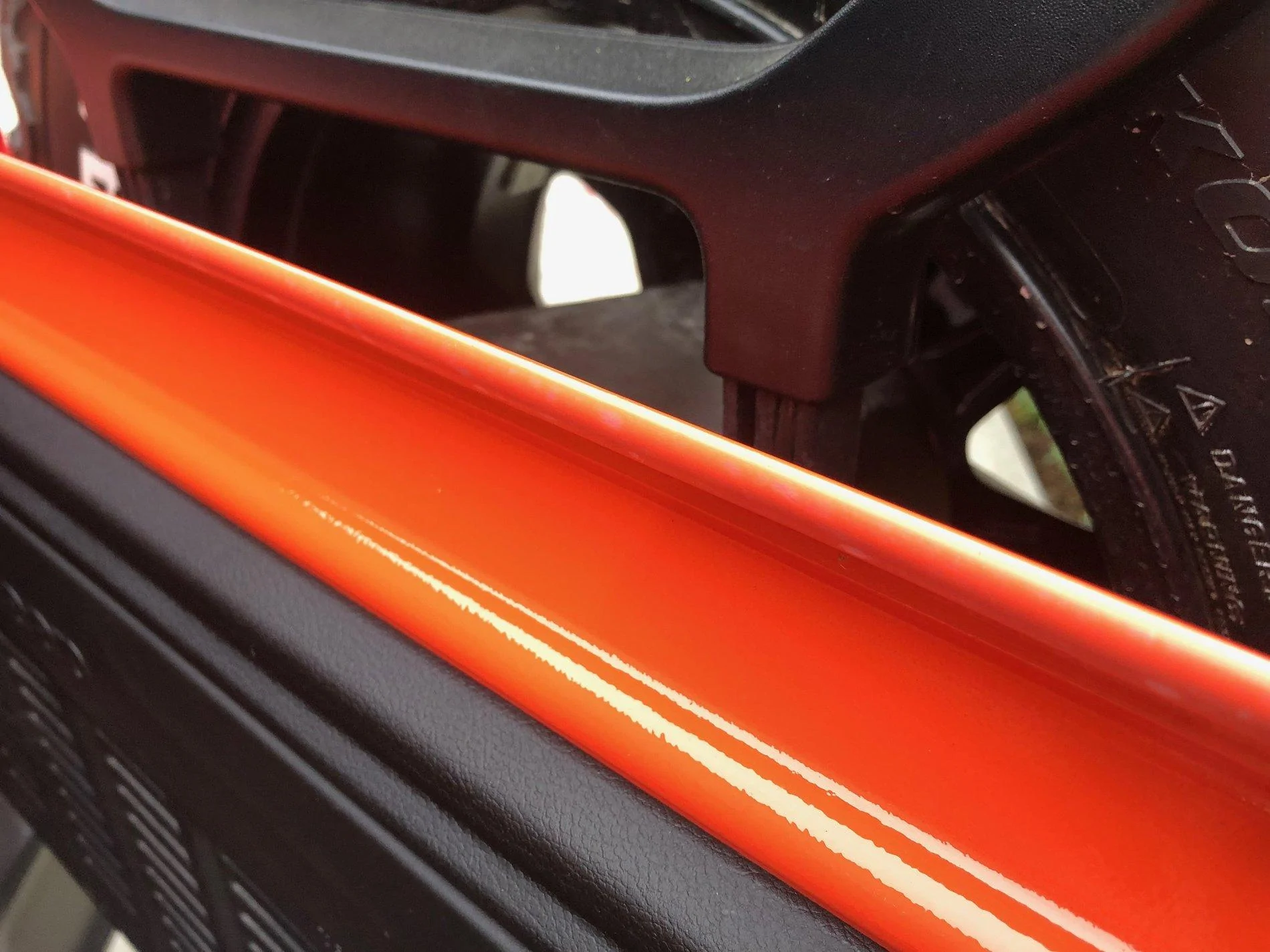

Absolutely amazing stuff. Virtually invisible (completely invisible with the tailgate closed). Applied it this morning and the tailgate was completely and utterly silent. Not. A. Peep! (no, not the yummy little yellow marshmallow kind)
After a quick wipe with alcohol, I applied the top edge of the tape to the top edge of the tailgate and smoothed the rest over the inside lip. Unless you are really looking for it you won't see it. If you see the picture below you only faintly see some air bubbles that should pass with time, but it's on the inside of the tailgate so I don't really care.
I don't understand why the factory doesn't do this. This just might be my best upgrade to date... or at least on par with the Sunrider :like:
A big vote of thanks to @Vegvisir66 for his post mentioning the tape that his dealer put on. I had no clue this stuff existed.
I purchased a 0.5" x 5 yard roll of 3M 5430 PTFE/UHMW anti-squeak tape for about $20 on Amazon. Have plenty to spare in case it needs to be renewed from time to time.
https://www.amazon.com/0-125-5-5430...+5+yard&qid=1556287711&s=gateway&sr=8-1-fkmr0
