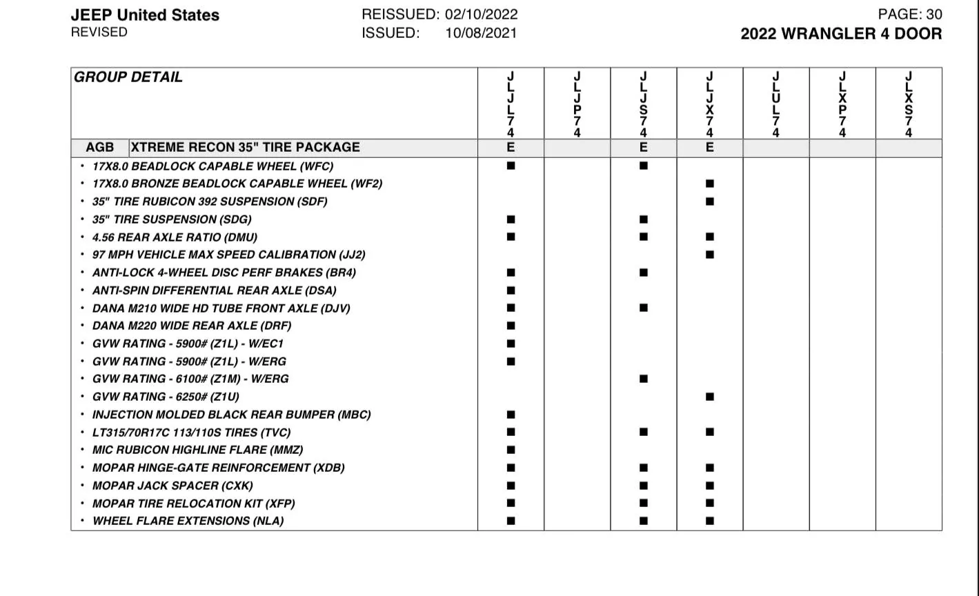

If you don’t have the 4.88 option, 4.56s were in the Xtreme Recon package:
Thanks again Matt. Attached is the window sticker. Not sure it is the Extreme Recon package but only the Recon tire package?
Yup, that’s xtreme recon.

Great just what I needed! Thanks for the info! So 4.56 it is then.
Also went to jeep.com and put the VIN # and found the jeep specifics with the following:
4.56 REAR AXLE RATIO
