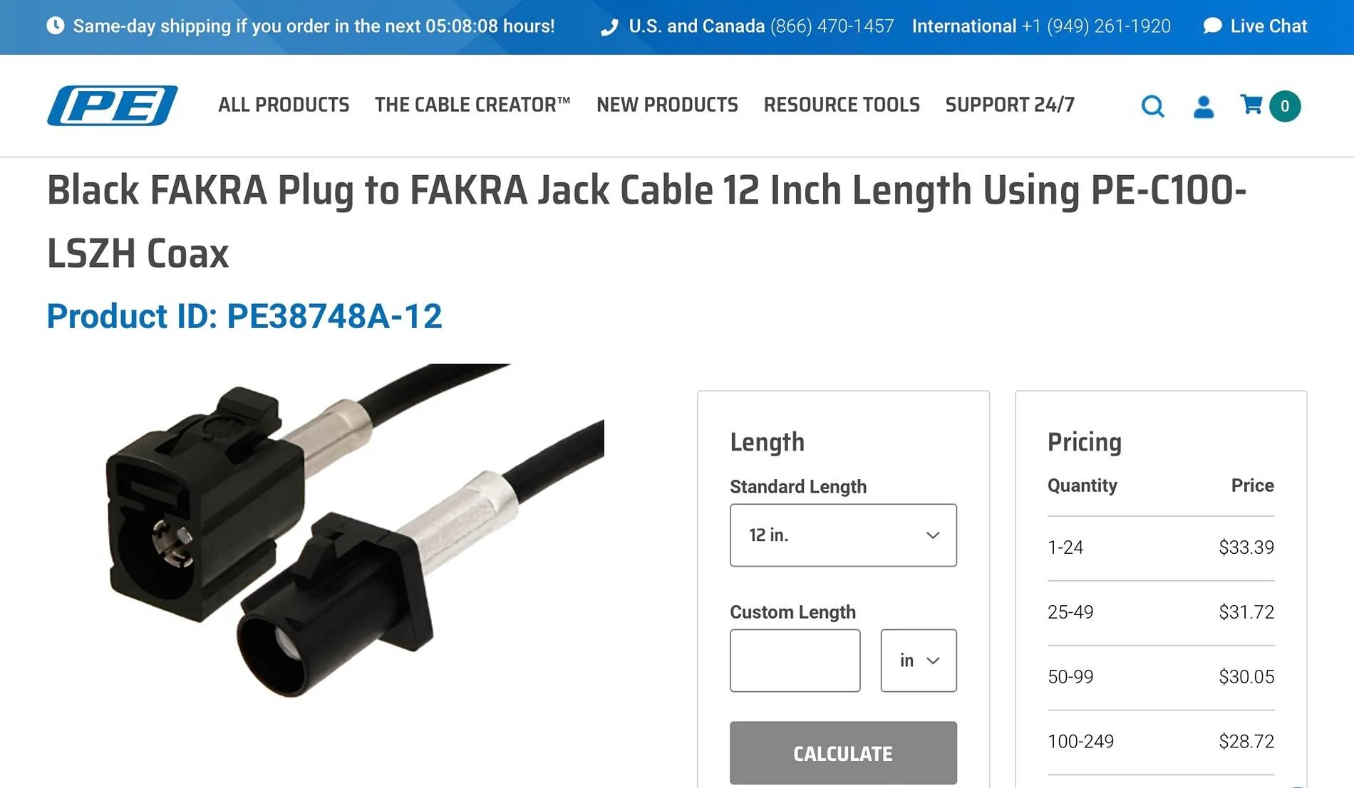

@Terrymo is it the "black fakra plug to fakra jack using PE-C100-LSZH Coax" that is required to extend the backup camera cable?
Asking because there are so many different colors with ever so slightly different connectors based on color.
https://www.pasternack.com/images/ProductPDF/PE38748A.pdf
https://www.pasternack.com/fakra-plug-fakra-jack-pe-c100-cable-assembly-pe38748a-p.aspx
I have a 2023 with the OEM front trail cam in addition to the rear back up cam. My connector is black and that is a screenshot of my order form. I sent pics to Pasternak tech support of my camera and cable connectors and they told me what to order. Sorry, I don‘t know what variations there may be from year to year, with or without front cam etc.

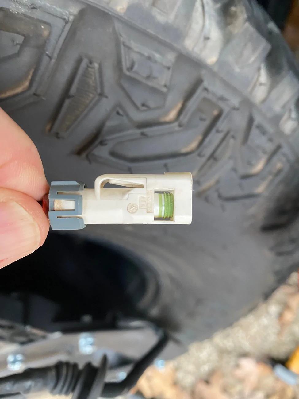

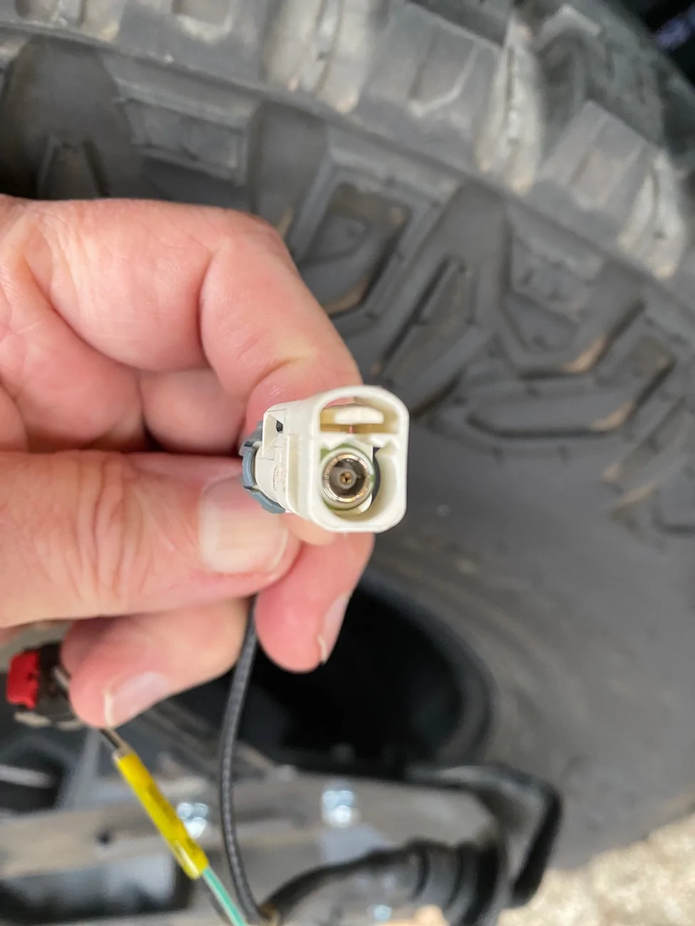

My connectors are white. 2021

So, they are the White Farka Plugs. I need a chord with a male and female, to make an extension chord. Man, the colors (styles) that are available are crazy.
Looks like I can get a premade one off of Amazon, though I will have to "deal" with the length(s) that are available. $16 ot $50, depending on length and supplier (no free shipping).
Thanks to all for the help!
