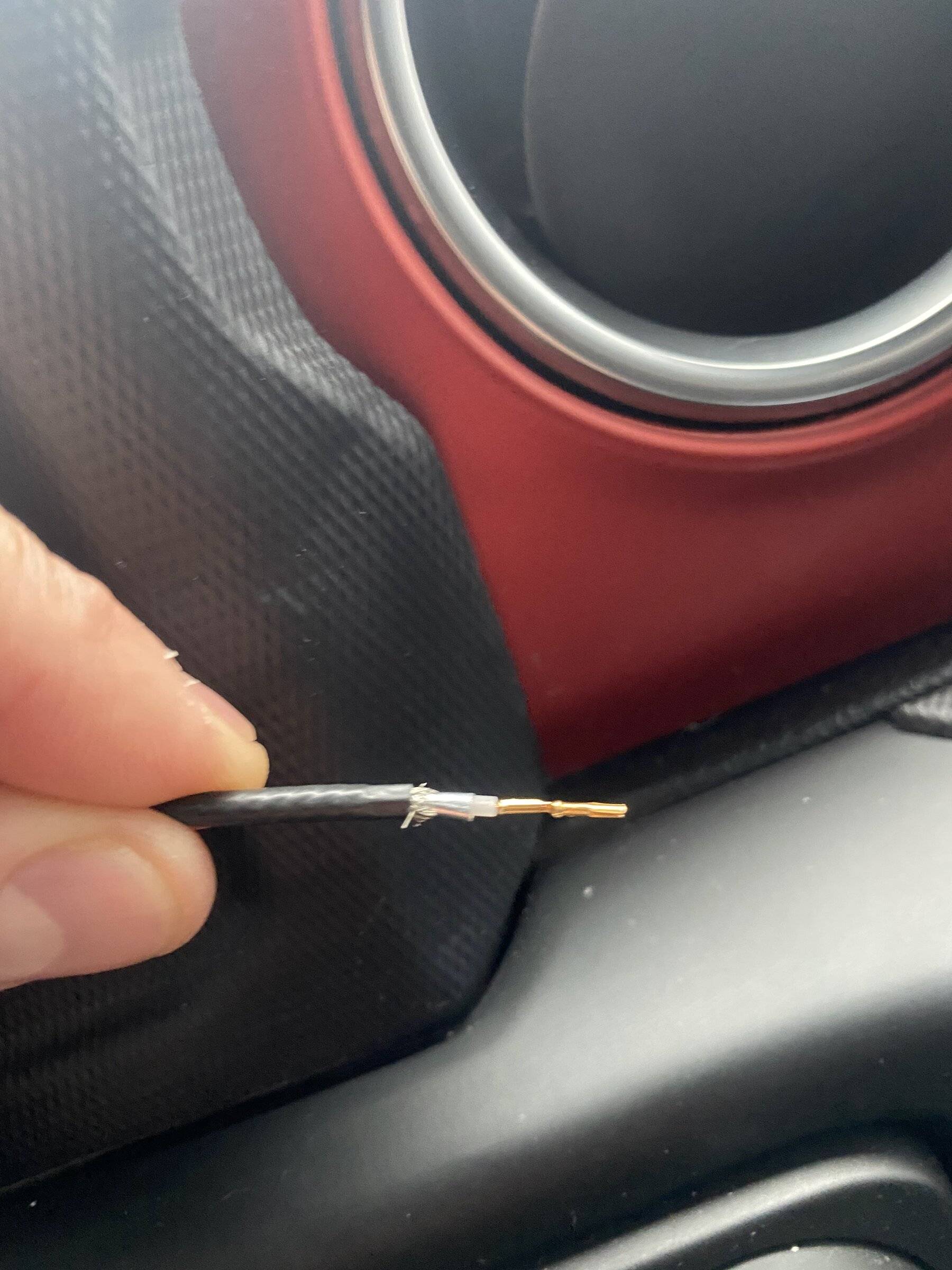

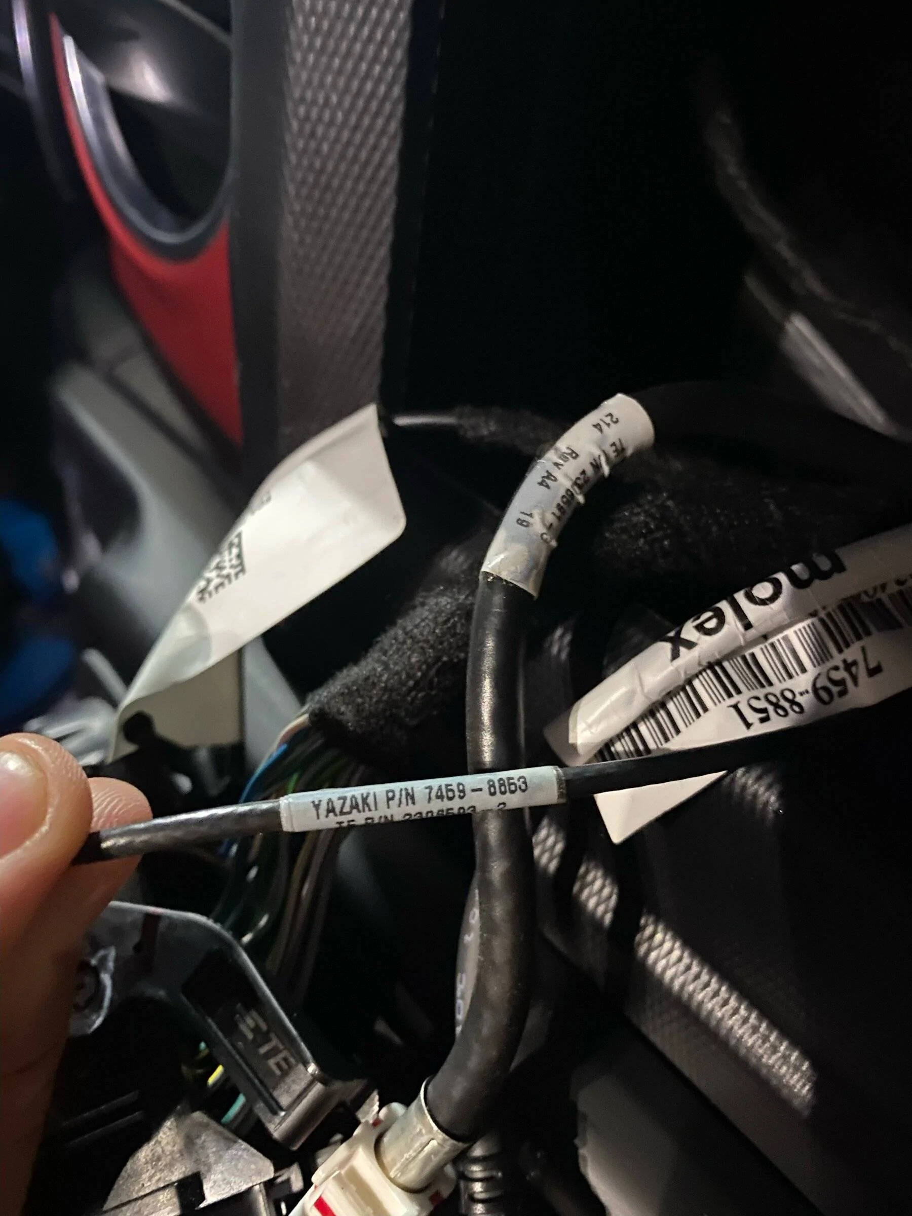

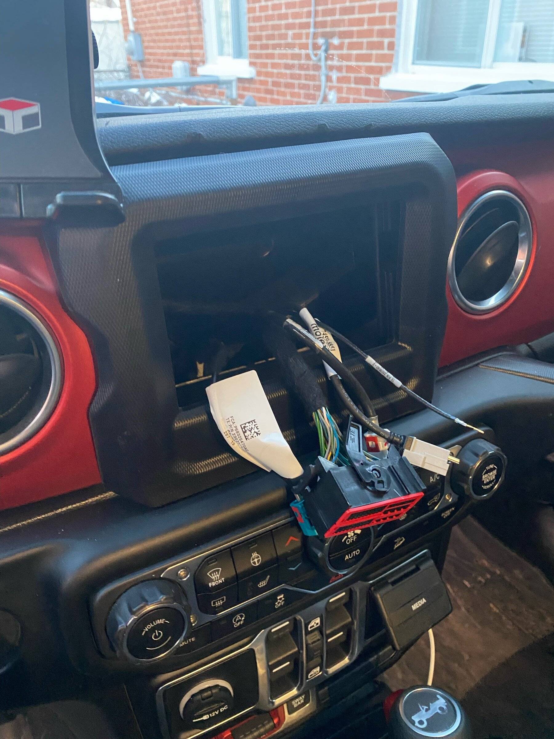

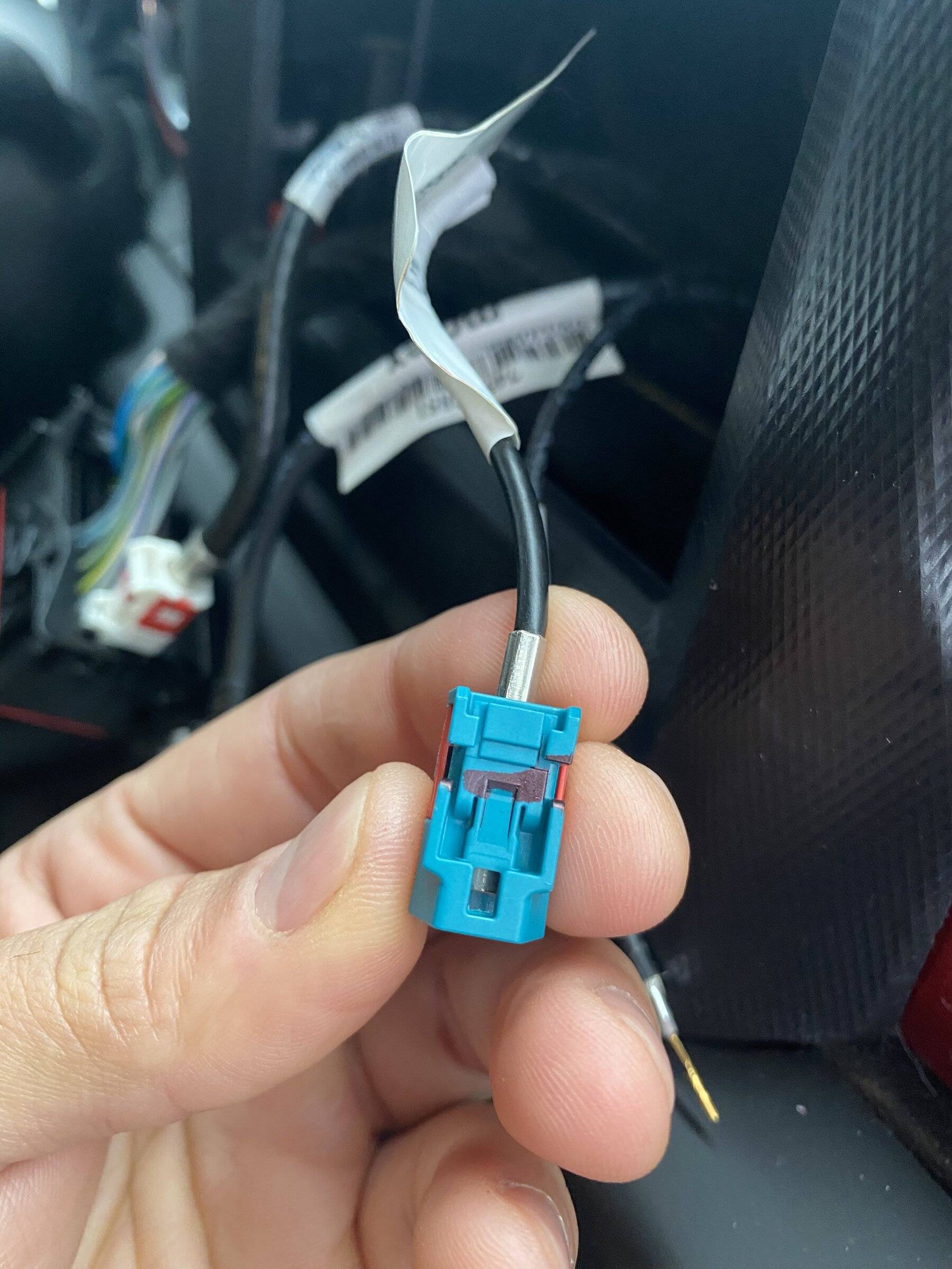

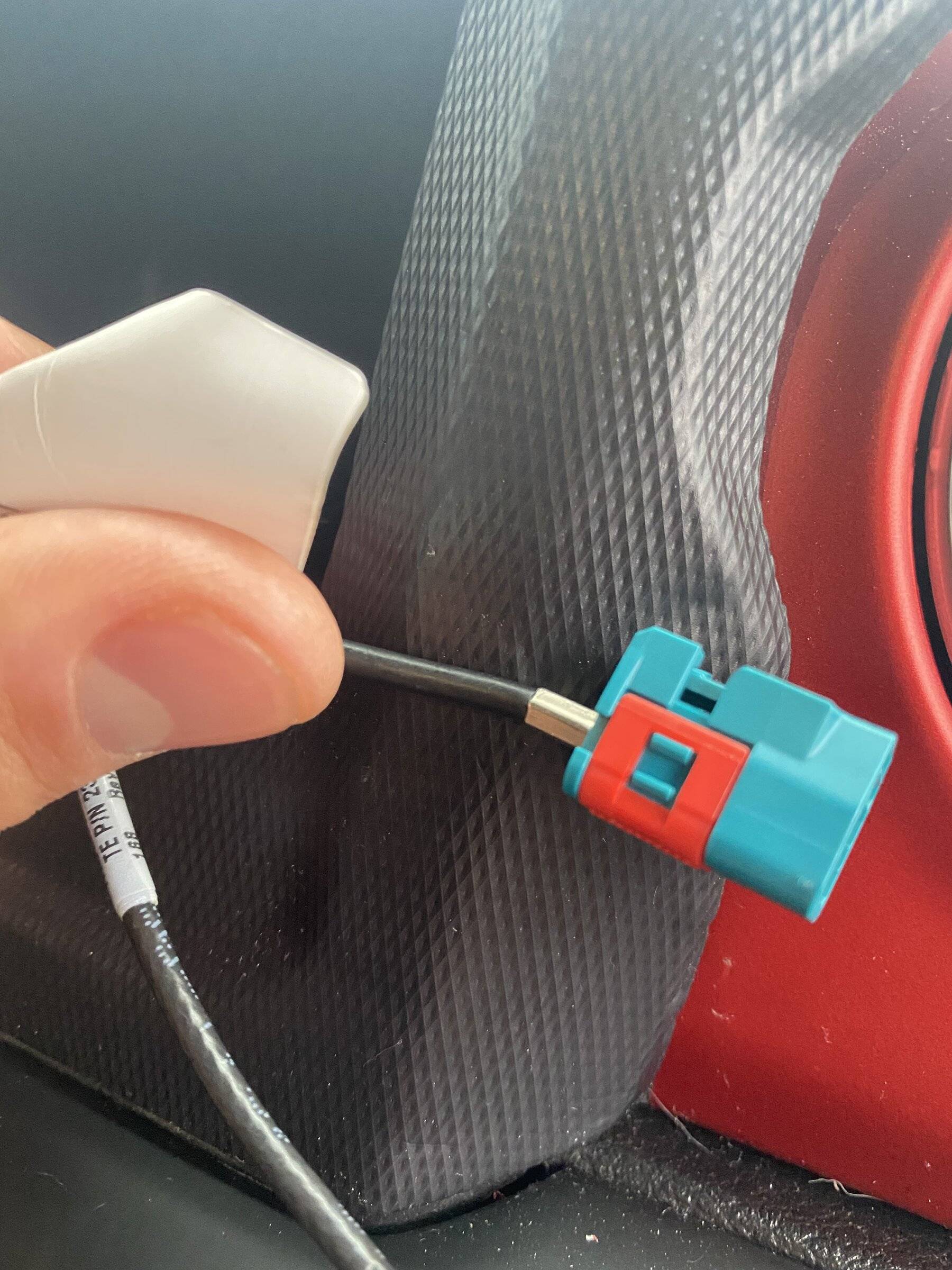

Need help finding the the reverse camera cable that connects to the rear of the radio unit. unfortunately, someone broke the window of my Wrangler and stole the 7" screen radio unit. All of the wires are intact except for the camera coaxial cable (red Connector is gone). I search for the part number listed on the cable but those are different from the MOPAR part numbers. I found Part Number: 68401977AA (https://www.moparpartsinc.com/p/Jee...FTKkhd6TqcfKI6e5xhaDW5sYwW2pEm1caAlc2EALw_wcB. However, this part is listed only for 2018 Wranglers and it says it does not fit my 2020. The cables look the same but the dealership says that for 2020 the cable comes with the whole dashboard harness and is different from the 2018. Ultimately, the part is only $21 and I was planning to buy it and try. Any ideas? Thanks for your help

I routed the cable and indeed it joins with the main harness bundle. Now I need a workaround this. Only if I could fix the existing cable.

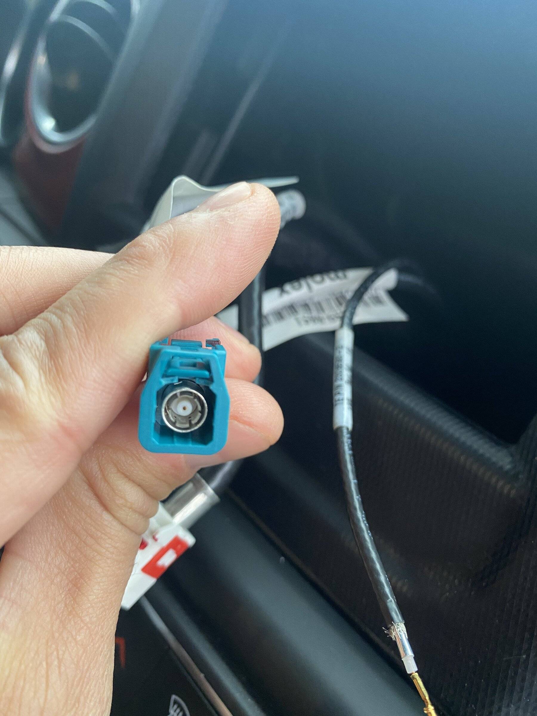

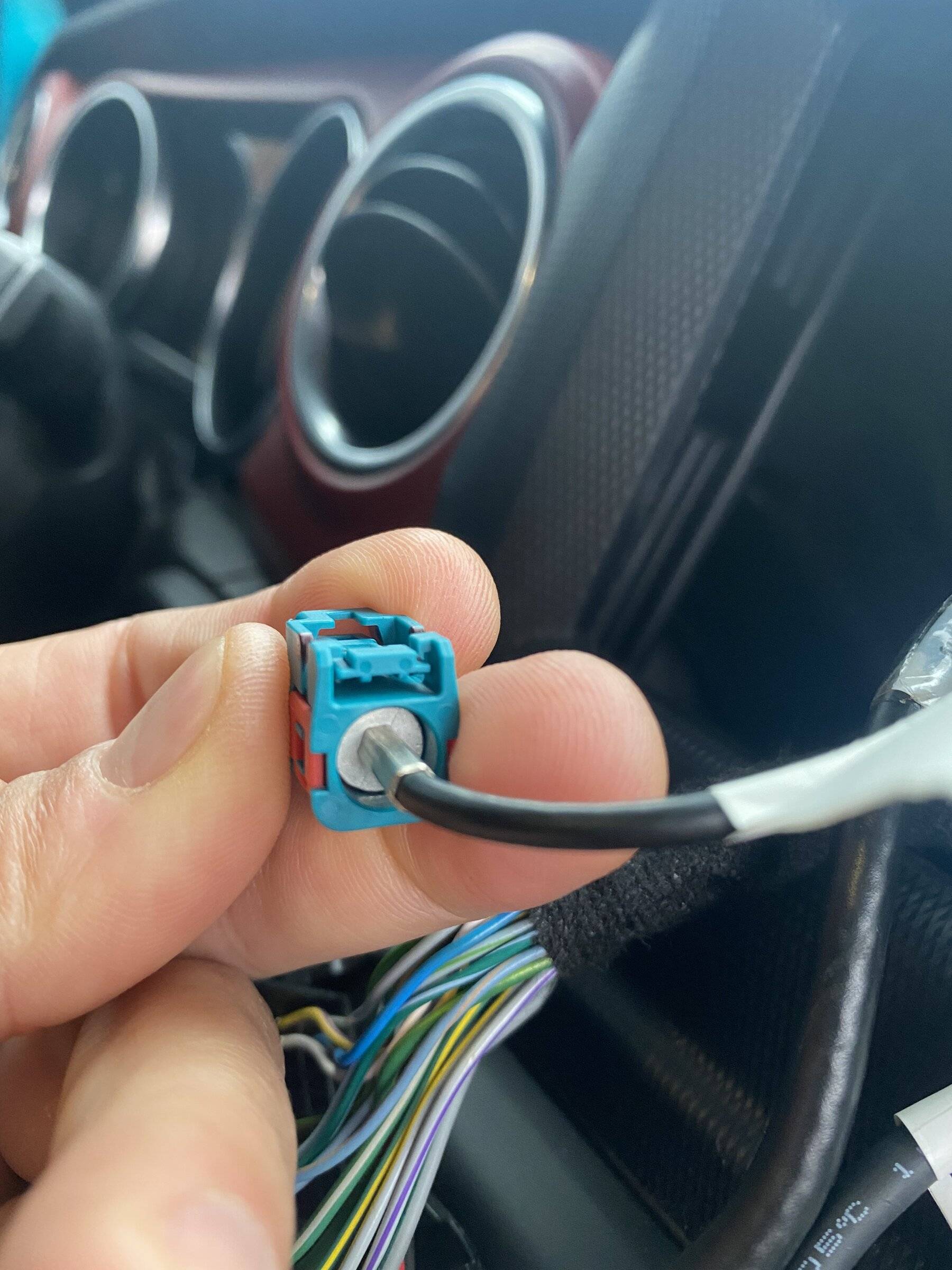

Yes, I saw that. This cable is an extension for the existing rear portion that connects to the camera side. I need the one that connects to the radio unit. The connector looks similar. If I can find the connector, there is a chance I can repair it. The connector is the same as this one but in red.

I ordered fakra and coaxial connectors and fixed it myself.

Fakra plastic connectors and the coaxial ends. If you disassemble the end you cut by mistake, use it at the end of the wire. Just peel it and reassemble. I had to order connectors because mine were gone when the radio was stolen.
