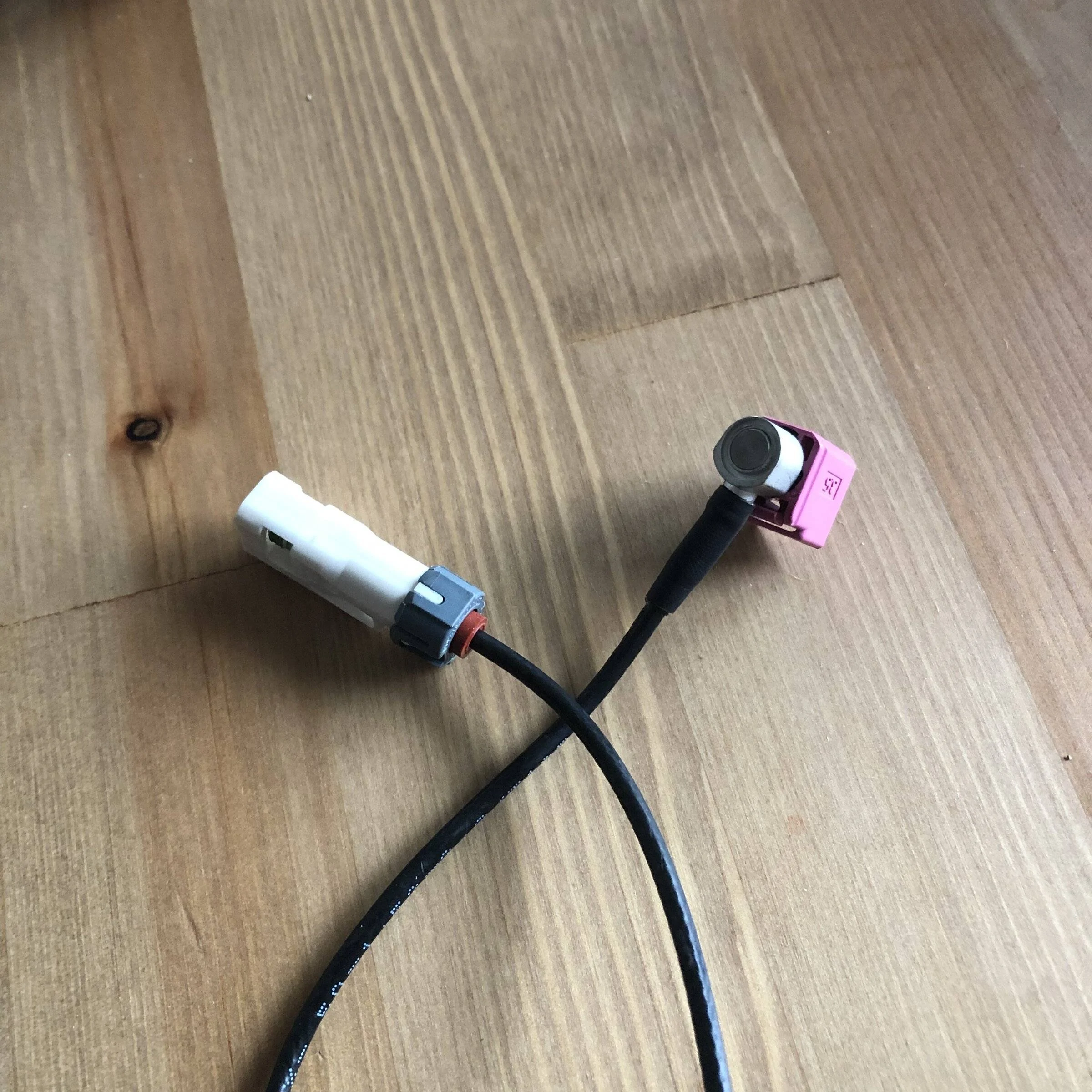

Hello,
So I was installing the Teraflex HD Alpha Adjustable tire carrier over the weekend.
the new ‘21 OEM tire carrier is way more complicated to get your backup camera out, I ended up having to use a saw to get it out.
Anyways, the OEM tire carrier fell and the backup camera cable broke. I tried to repair the cable with no luck.
When I go into reverse, I see the guide lines but my screen is black.
I called my dealer and he found part “68488636AA”.
would this be the correct part number as I have been advised that one I install it and it doesn’t work, I can’t return it.
Thanks!

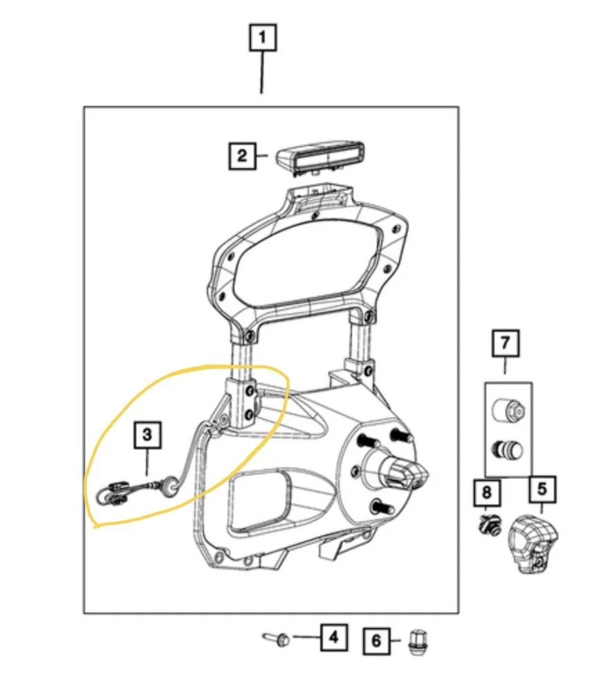

Bump and thanks, OP, for the part number. Cut my fiber optic cable as well trying to take out the back up camera to reinstall into my spare delete.
‘21s have the backup camera inner sheath glued to the outer plastic sheath. Was able to eventually punch out the inner sheath. PITA!
Yup! Big PITA. I ended up having to order a different wire .. the first wire they order was the optic wire that goes from the center console to the tailgate, which I didn’t need.
They finally ordered the right cable, which was a combo rear camera cable and 3rd break light cable.
If you need the part number for this, let me know.

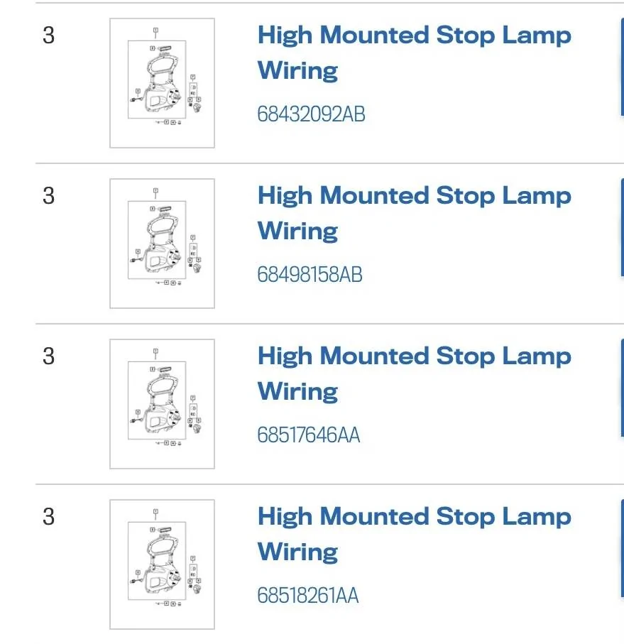

What‘s the correct P/N? I ordered the one in your first post. Guessing it’s one of these four…
Jeep Wrangler JL Replacement backup camera cable on ‘21 JLUR B3A4800C-CA4C-4FBD-A5C9-02AF640D1F58
Jeep Wrangler JL Replacement backup camera cable on ‘21 JLUR 9ABACFD2-441D-4E2D-B6FB-0464A972E051
At Risk Ute
Christian
Jun 7, 2019
52
1,211
2,832
USA
‘23 392 XR
Retired Navy
Confirmed with OP that the ‘21 combo cable P/N is 68518261AA.
My advice is to remove the inner tailgate cover and unhook the rear brake light and backup camera cable connectors BEFORE trying to remove the rear tire carrier.
This way you can pull the combo cable out of the tailgate and place the rear tire carrier on a flat service to punch out the inner sheath to access the backup camera. My dumb ass cut the back up camera cable not knowing it was a fiber optic cable.
