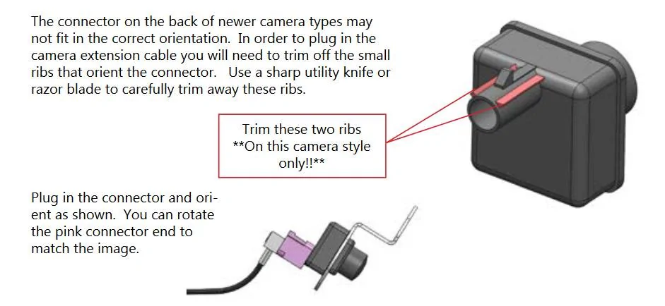

From what I understand all you have to do is trim the little tabs off for it to work.
From LOD's instructions on rear camera install for 2021s

Well, it looks like that cable will fit. The original part number posted in this thread was PE38748A-12. They told me it is "out of stock and one of it's components has been discontinued." They suggested PE3C6305-12 be used in it's place and that's what they sent. It does not fit. It's basically the same fittings but the alignment tabs are not in the right places. As someone else noted, I would need to trim part of the fitting for it to work.
I just sent them an email about exchanging it for PE38753H-12. It looks like those are the correct fittings.
I don't know if this is the right size plug, but it appears to be the right clocking for the anti-rotation features. black connector, it appears that the color connector dictates orientation.
Pasternack link
And it is not white, but white has the "block" key on the correct side, but the "wing" or "triangle" key is pointing up instead of out horizontally.
See diagram on spec sheet.
