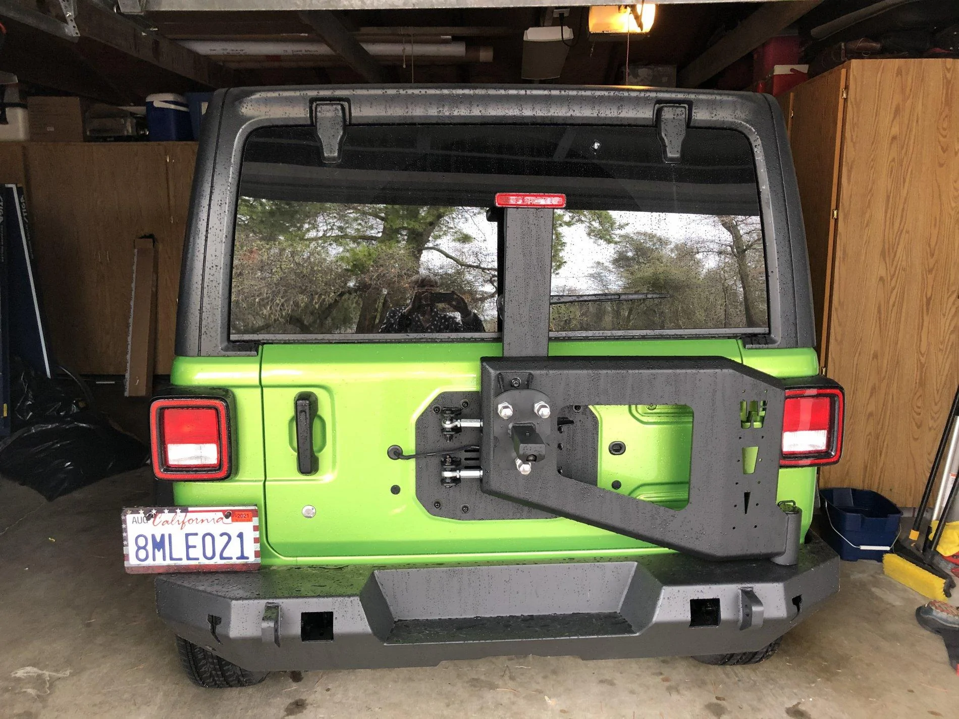

Is that the Westin rear bumper and tire carrier? I'm in the process of trying to decide on one. I read the reviews and they mentioned the camera cable.
Yes it is. I decided on this one since it kept everything legal (third brake light, lighted license plate relocation) plus rear camera all in one package. Went on pretty easy using install video - happy with the purchase.....with the minor hiccup being the wiring for third brake light
