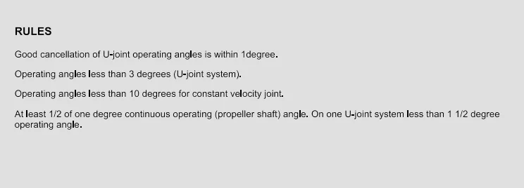

Also, FYI, 0 angle is not what the OP wants if they're still on the OE Rezeppa joint. From the factory service manual for driveshaft angles:
Jeep Wrangler JL Rear axle Perpendicular to ground! 1707768624198
Under 10* is the target for OE style joints. Rezeppa joints need some angle on them to operate correctly. Too straight and they fail. U-joints (typically aftermarket double cardan "CV") are where you want as little angle as possible.

You don't want to shorten below factory spec on an LCA, as LCAs generally should be used to set wheelbase. You will have to balance UCA/LCA length in order to achieve proper pinion angle while not having any arm fall short of factory length. Generally, with a lifted Jeep, you will need longer LCA and UCA to have the proper amount of additional overhead to adjust pinion angle, with factory length being the bottom end of the range for each.
