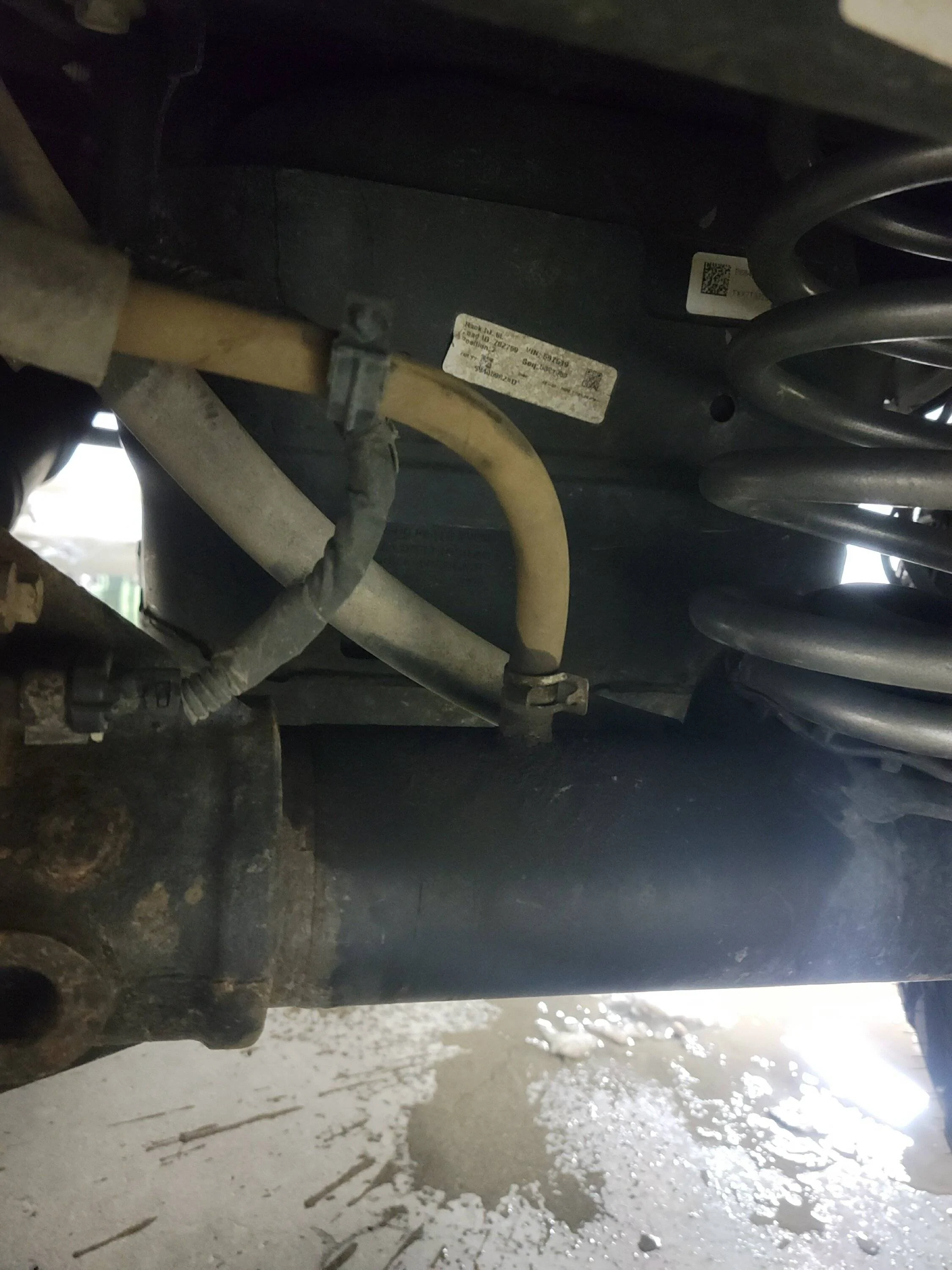

Bought my 21 JLUR 12 days ago. Was able to pull it into the shop to do a oil change and checked all fluid levels.
I noticed some oil around the rear axle breather tube and wanted to check the fluid level. As soon as I pulled plug oil stared pouring out! So quickly shoved that back in.
Is there any reason it would be Over filled and how? Front axle was just below the fill hole.
You might consider removing the fill plug again, so as to allow the existing gear oil to self-adjust to the correct level. Or, drain and refill to the proper specification. Doing the latter will allow you to establish a base service date, so to speak, for future reference.
That was my original thought and I'll do it in the next day or two.
I'm going to be throwing 4:88's in it soon enough hopefully in the next month. I just don't understand how you over fill it!

How it might happen is when it was drained for service and was not drained completely. Then a high school kid at dealer was told that the unit requires XXX amount of fluid. Then said youngun was determined to stuff it in there like a good employee, subsequently squirted it in there then stuffed the plug in before it could escape.
(You just repeated the 2nd part of that process) Now it is still overfilled.
I would drain, pull the cover, inspect for trash, chips and signs of strange gear wear, admire your locker.... Seal it back up and fill with new fluid of your choice to bottom of fill hole.
Then you will know its right, and can log it in your new little maintenance book and life will be good.

Something no one said..... might be worth while pulling checking for water..... water in the diff will raise the oil level. I'd take it for a 10-15 min drive then pull the fill plug and check for milky oil. if the oil isn't milky then just drain it until it just comes out of the fill plug and seal it up. but with the oil coming from the vent tube that is a possibility of water being able to get in as well.
