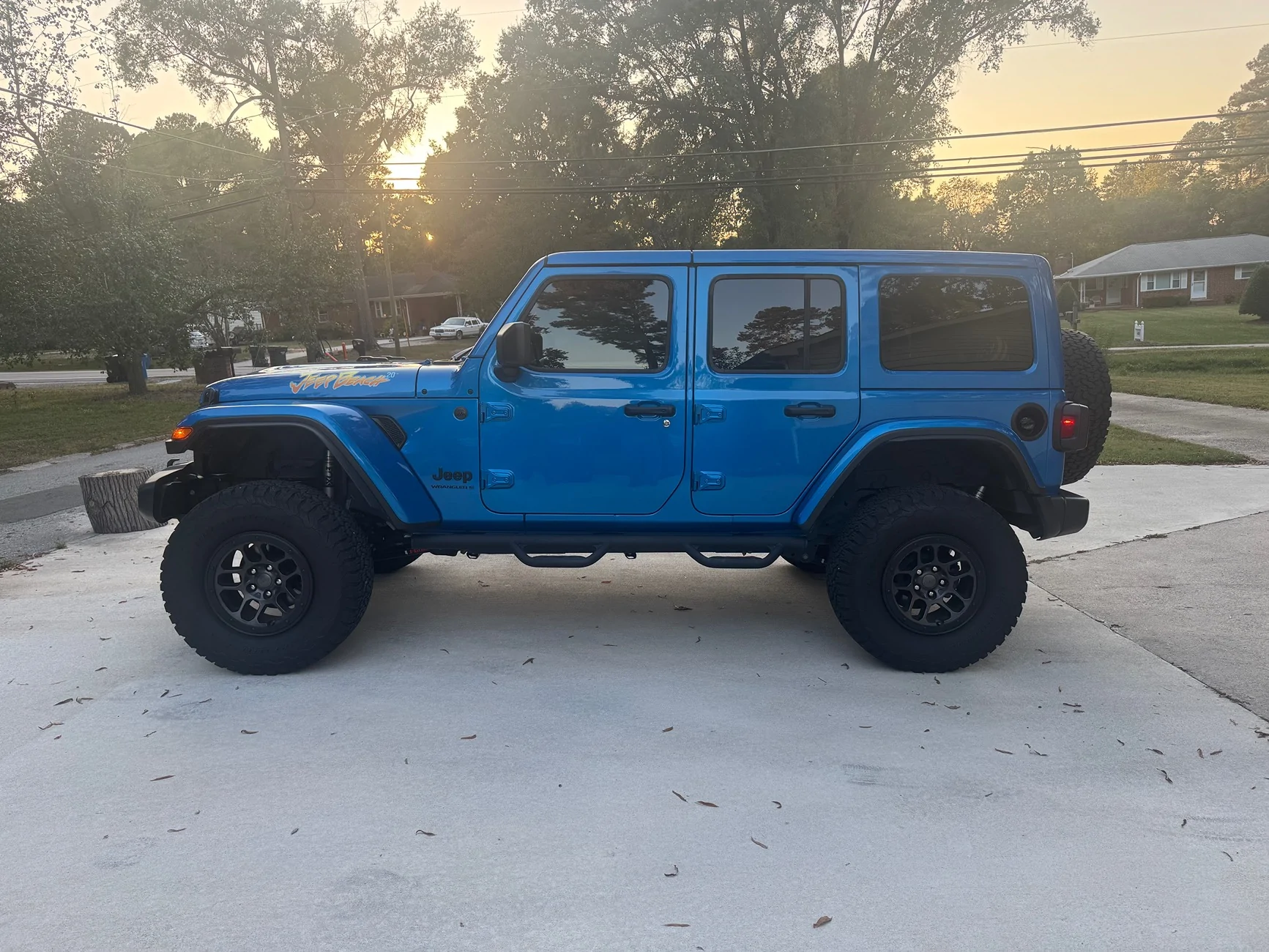

I bought this 2023 jl beach edition with the reckon package brand new … I love it . I just put a 3.5 lift on it because I want to put 37 or 38 tires on it to take it to the trails sometimes…
The shop that put the lift told me I have to regear before buying the tires … other shop I went to told me that the 4.56 gear the jeep has will handle the 37 with no problem…. So they told me only regear if I go with 38 or bigger tires …
Should I regear anyway or not ?

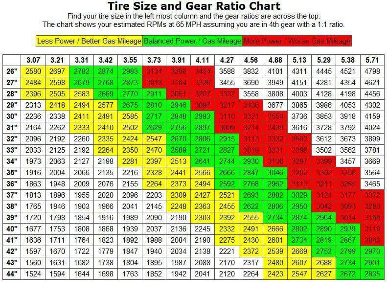

There are folks that run larger tires on lesser gears, but it really depends on how you use it. Might as well go 5.13 and be future proof. Here is a chart that came somewhere from the site.
Jeep Wrangler JL Re-gearing needed or not ? 810203-d26eecf45f72dabde55c46c00fcfa58d
I really wish people would stop reposting this 20+ year old chart. It really doesn't apply to the JL, given it doesn't factor in overdrive. On top of that, it doesn't factor in the true rolling diameter of the tire so the numbers are significantly off. Finally, every engine has a different set of yellow/green/red ranges.

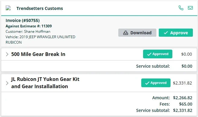

Where can you get a regear for $2500? When I had my JK done in 2020 it was $3k. My JL in 2023 I think was around $4k, though that might be a little high.
Come down to Texas. My re-gear last November (2024) was $2331.82. Ended up with Revolution gears, but the price was the same. Kevin @ Trendsetters Customs out in Weatherford is one of the best in the business. He had me in and out in about 5 hours. I just took the laptop with me and worked (and watched the install) from the shop.
