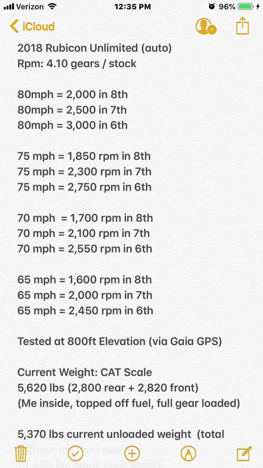

my 4.88 gears are in transit right now! Will be running Toyo 38s
Hey Matto!
I wanted to follow up from your thread here. I'm also going to 4.88's next week and wanted to get your feedback on them!
I have 2018 JLUR (auto) and have added 940lbs in armor and bumpers/gear (CAT scales weighed and verified). I'm looking for my 8th gear on the highway + some extra power. I'm in the North East and surrounded in mountains. The hills kill me lol.
I did some highway testing on a long drive. See below for results.
Really appreciate any insight on brand, installation, gear noise, and overall impression of the 4.88's.
Thank you so much!
