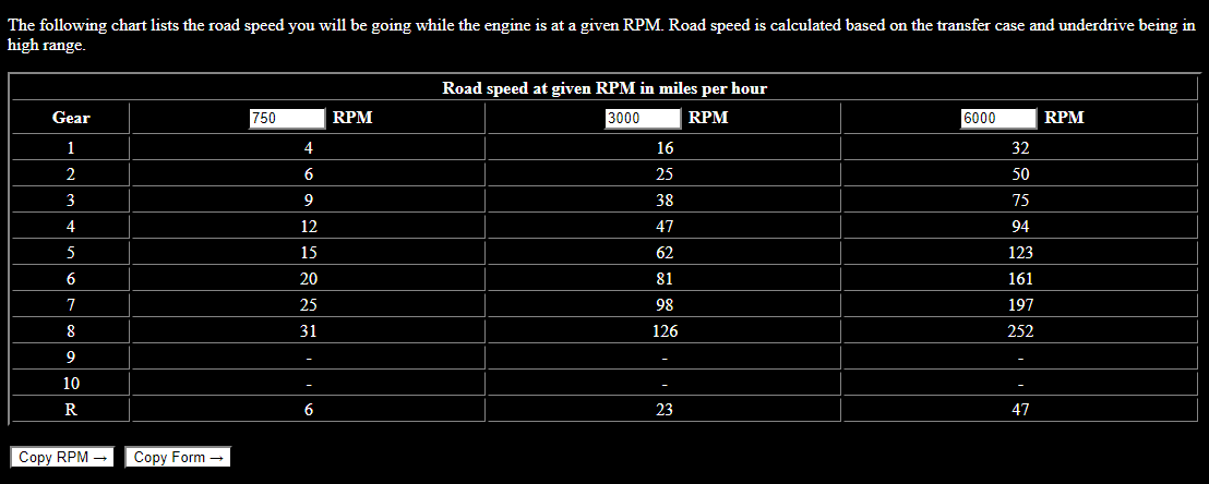

Roys gear calculator is a god send.
http://www.grimmjeeper.com/gears.html
1. Aisin D478 for the transmission
2. NP241/NV241/NVG241 for transfer case
3. n/a
4. whatever gear ratio you want to see
5. Tire size you plan on running
Plug those details in and there is a left column and a right column that you can use to do side by side of different comparisons of tire sizes/gears.
It'll give you crawl speeds, RPM at various highway speeds and RPM at each gear vs the speed you're going in that gear.
Give it a whirl!
It can seem a little intimidating at first, but knowing the transmission and transfer case is the first step. (conveniently provided)
EDIT: 4.56:1 if you do a lot of highway driving. 4.88:1 if you do a fair bit of off roading/crawling. 5:13:1 if you're real serious in the crawling/essentially zero highway.
Well, I did something wrong, I think. I will go try it out right now but I don't think my Jeep can go 252 miles per hour on the road....
?? did you put in the wrong transfer case or gearing or tire size or something
That’s wild
@grimmjeeper
Something happened lol
That's not uncommon to see. There's no sanity check to say whether the jeep can physically reach that speed in real life. It just does the math and spits out the result. It's up to the user to know that no Jeep is going to hit 200+ MPH without outside help.
