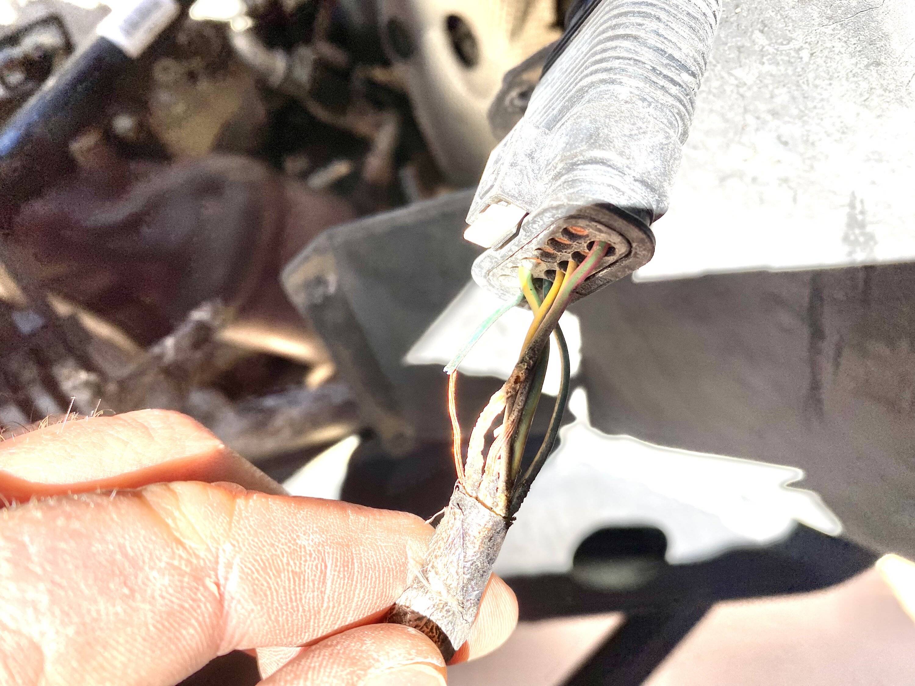

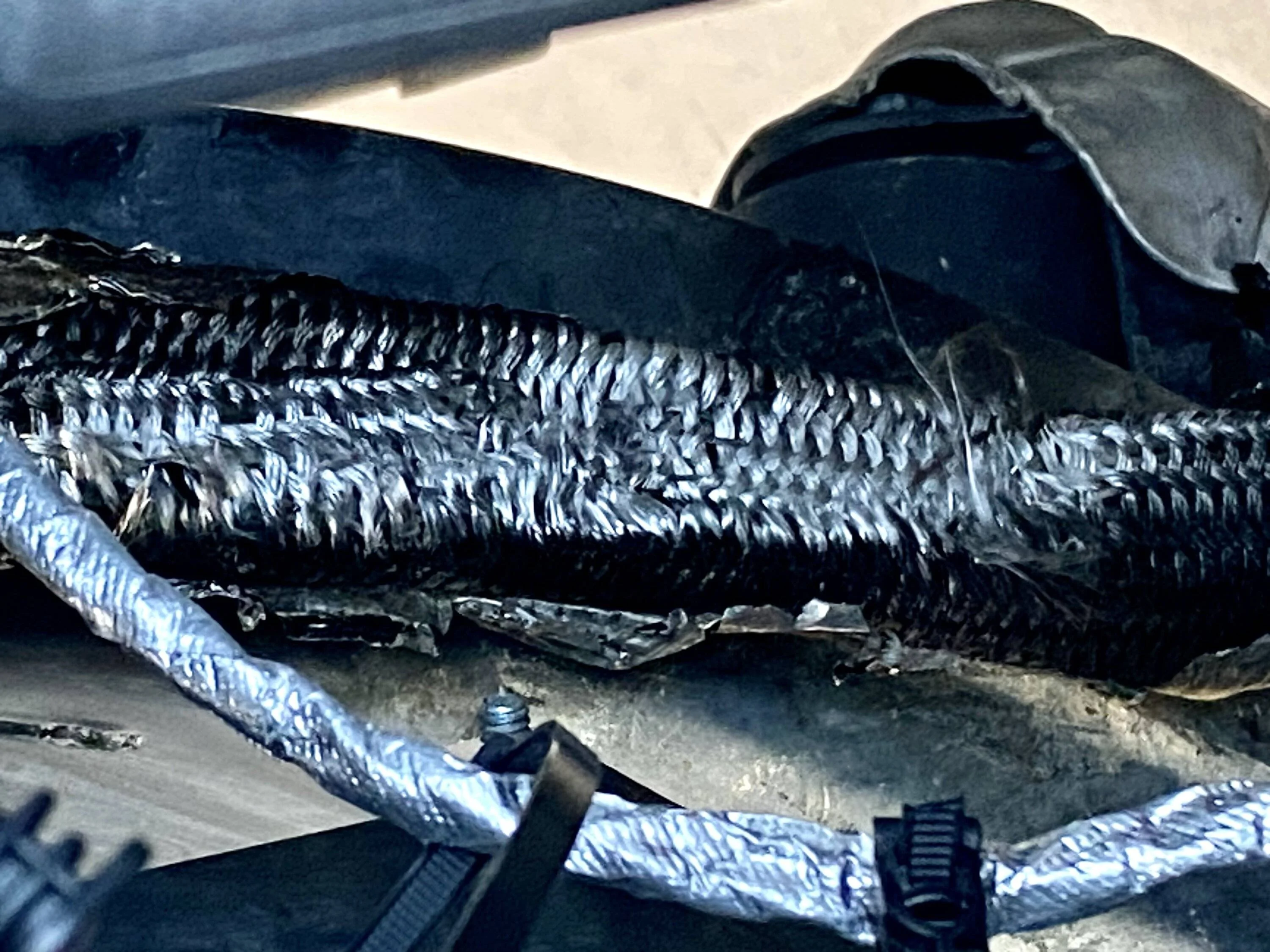

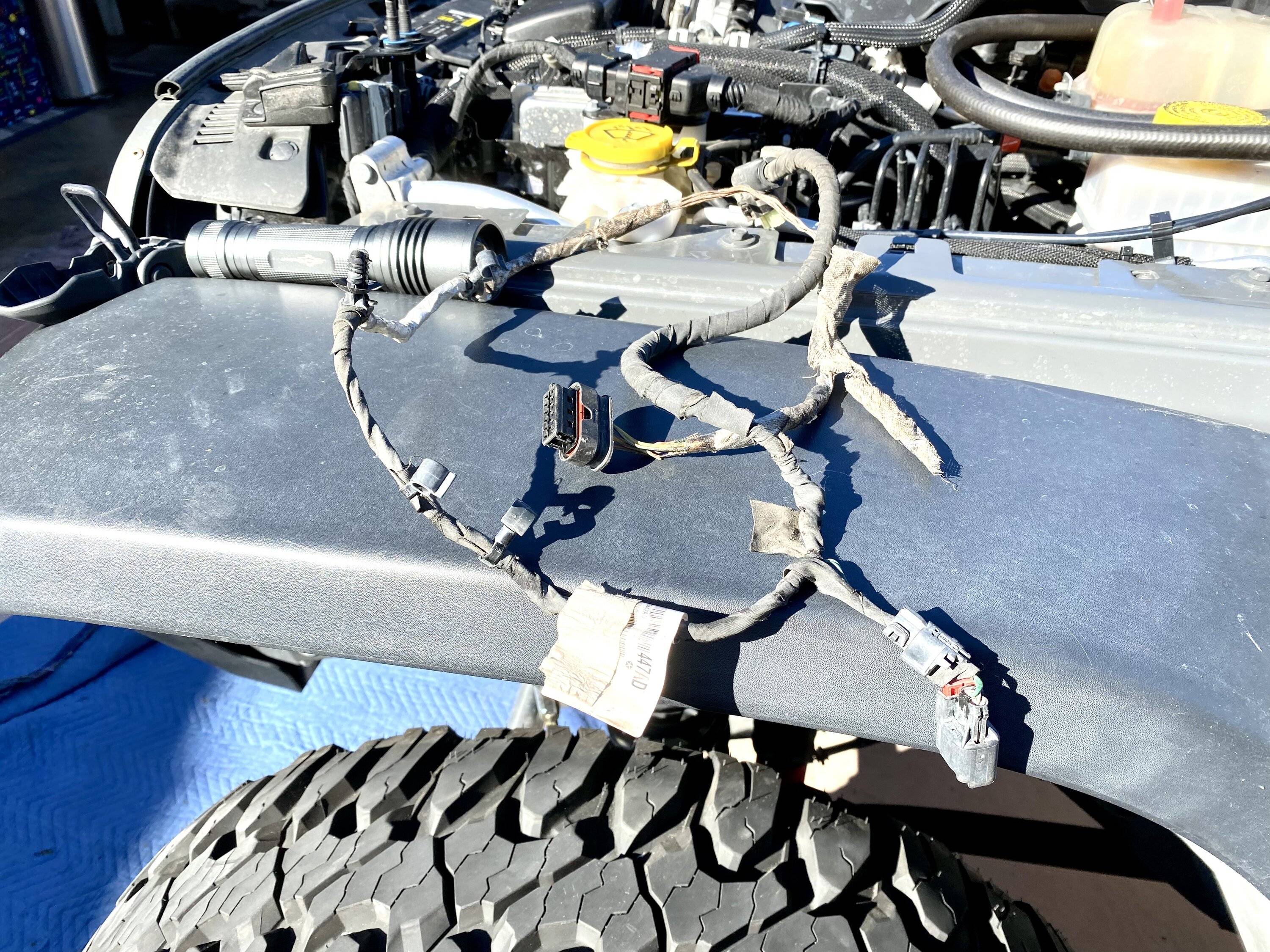

My poor 2018 jlur with 68,000 trouble free miles caught fire. I was driving home when I smelled it, luckily just one mile away. I stopped in the street and grabbed the hose. After looking it over I drove it around the block and the dash lit up and has a very soft pedal.
I pulled off the drivers side inner liner and the harness from the fire wall to the drivers front wheel sensor and e locker was burned/chewed by RATS.
The insulation on the brake hard lines next to the exhaust manifold was burned as well.
There were 3 codes, U115F, B1BE7, and U0101. I replaced the e locker 15a fuse, replaced the chewed on and burnt harness (only $60 from dealer!), and cleared the codes. All that is left now is the soft pedal. The dealer will flush the system this week, I hope. I believe the insulation burning boiled the brake fluid, there is no visible damage to anything else. Does anyone have a pic of what that insulation on the brake lines looks like? I’m trying to visualize how/why what was there that burned.
as for the rats, I hope they don’t come around again.
