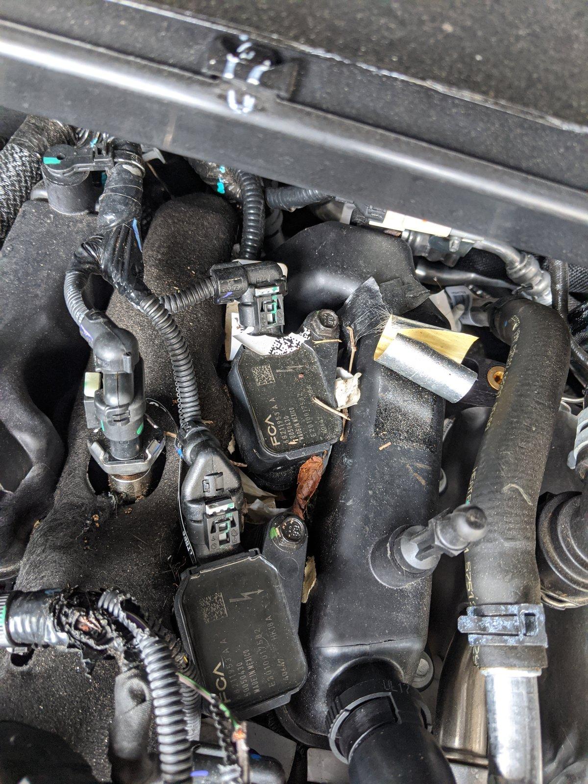

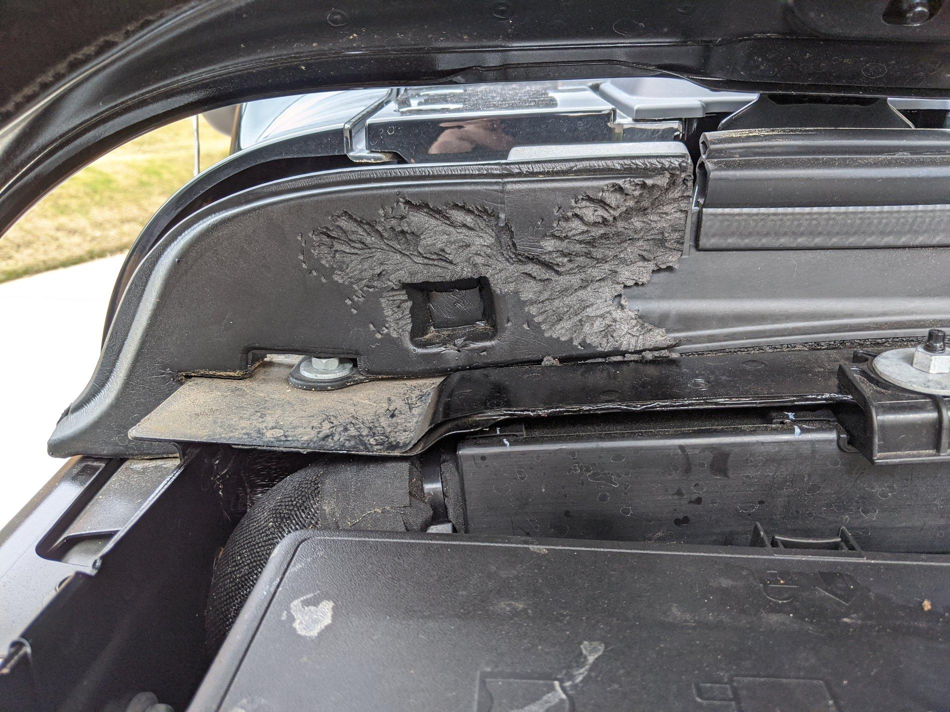

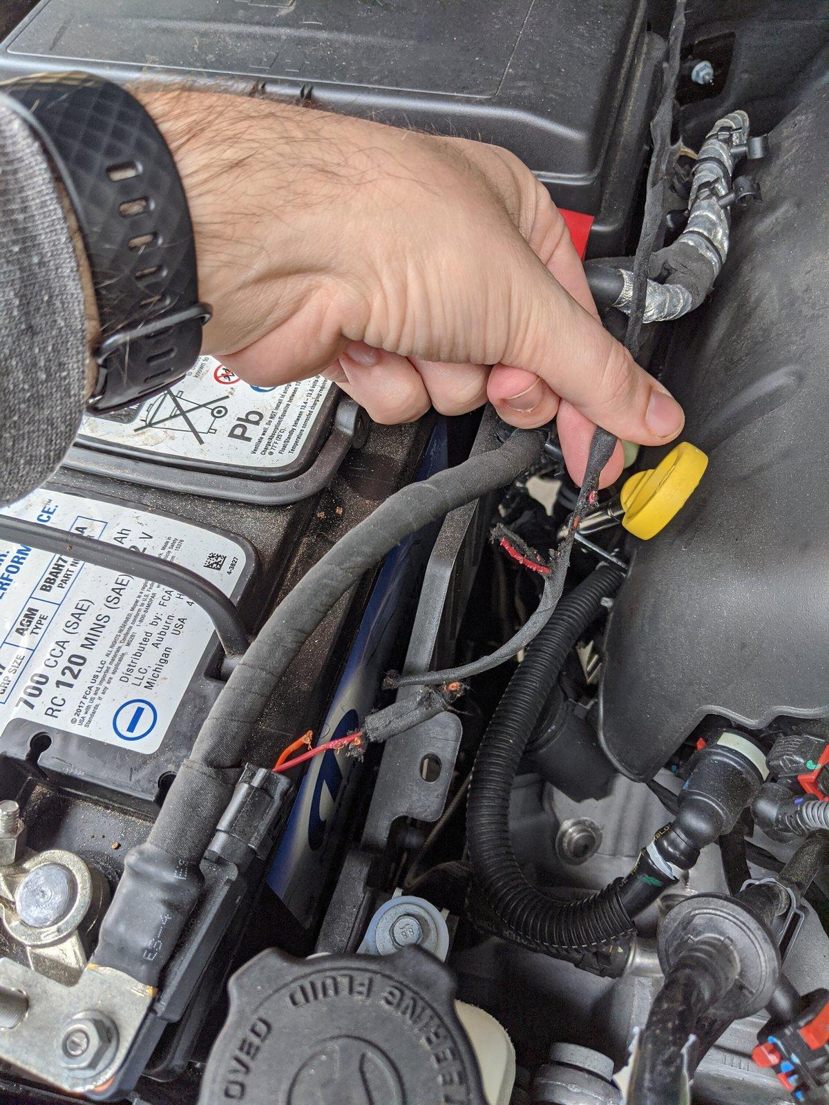

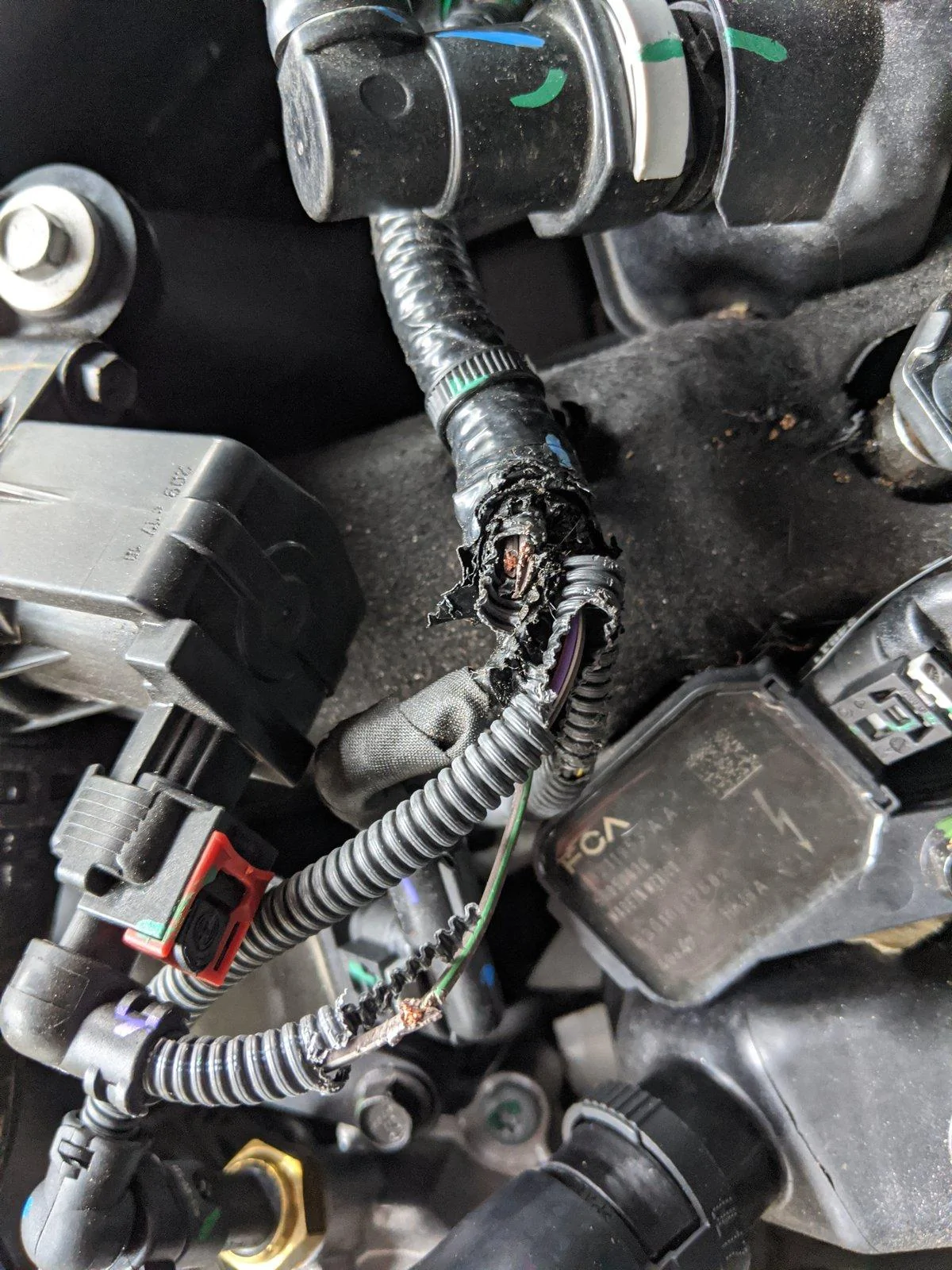

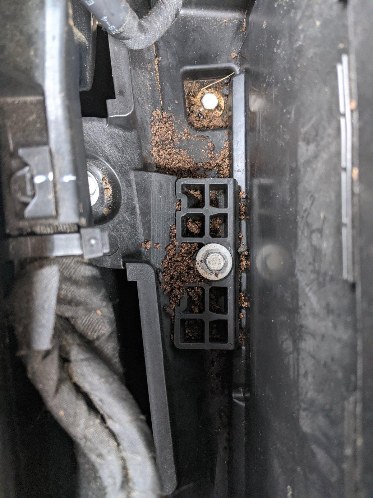

So last week my wife's Jeep had an error pop up saying to service the auto stop start system. It seemed to have much less power when driving it. The check engine light came on, have a code for the turbo bypass valve and one for the evap system. I found a chewed wire and foam piece in the engine bay. Pulled the engine cover and found a small rat nest as well as more chewed up wires.
So I filed a comprehensive claim with the insurance company. Not sure if they'll replace the whole wiring harness or not, but at least I'll only have to pay $250 and she'll have a rental while it's getting fixed.
