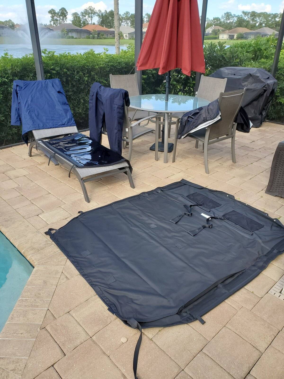

Lay it all out:
Jeep Wrangler JL Rampage Trailview fastback soft top install and initial impressions 4
Put the windows in the nice sunshine:
Jeep Wrangler JL Rampage Trailview fastback soft top install and initial impressions 3
Jeep Wrangler JL Rampage Trailview fastback soft top install and initial impressions 2

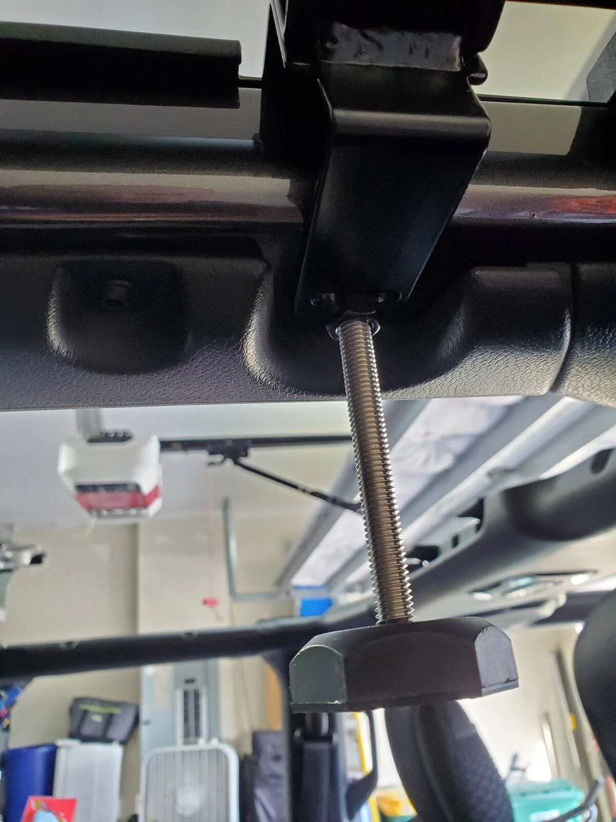

Some more info, the instructions show the windshield brackets install alone but they go over the stock brackets. They're offset the instructions show different but they go like this :
Jeep Wrangler JL Rampage Trailview fastback soft top install and initial impressions 20210930_164644
