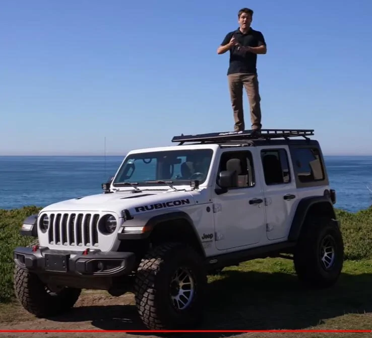

It is seem quite expensive to find wrangler specific rack amount, so I want to build my own from aluminum extrusion parts.
Any issue with rain gutter rack mount, how much load does it take?
like this one
https://www.amazon.ca/gp/product/B0D31F3QBJ/ref=ox_sc_act_title_3?smid=A3V8KM657SOFDN&psc=1
To @Ratbert's point, if the Mopar rack is rated at 150 pounds https://www.quadratec.com/p/mopar/removable-roof-rack-kit-jeep-wrangler-jl as a result of the limitations of the gutters, please appreciate that that strongest aluminum extrusion design you create will likely have the gutters as its weakest link.
While it might be true that increasing the number of places to which your DIY attaches to the gutter might not only balance the load, but spread it out, since you ask about load please know that there is both the dynamic load, which invariably is less, and the static load. Still more, as pictures above depict, it's not simply how much weight is placed on the rack, but how that weight is dispersed, as well as the shape of the object carried above.
For example, and for argument sake an owner could put a kayak above that easily falls short of the weight requirements, and yet have all sorts of problems at high speeds given the object's more aerodynamic tendency to want to rip off from the rack and sail down the highway.
