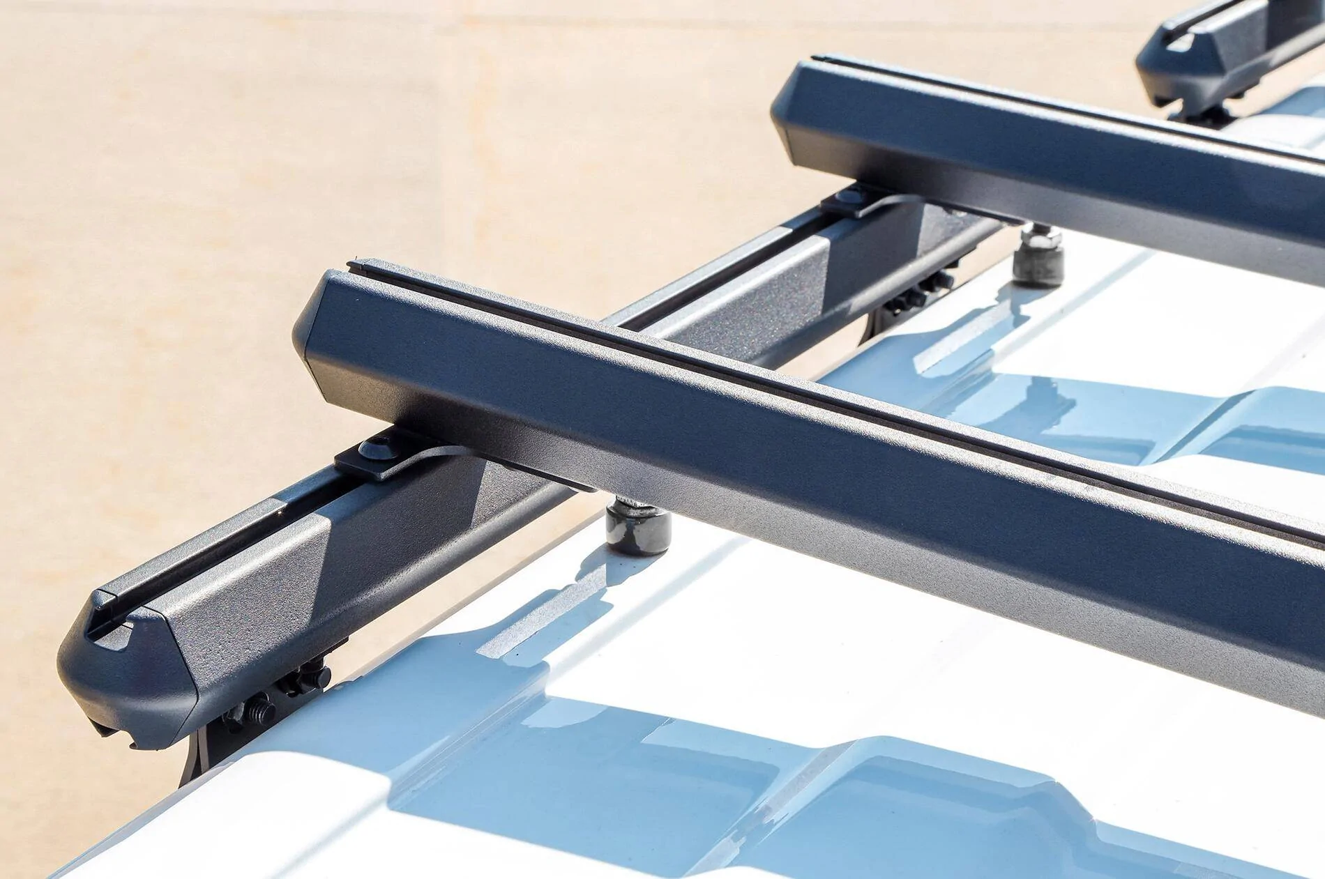

It is seem quite expensive to find wrangler specific rack amount, so I want to build my own from aluminum extrusion parts.
Any issue with rain gutter rack mount, how much load does it take?
like this one
https://www.amazon.ca/gp/product/B0D31F3QBJ/ref=ox_sc_act_title_3?smid=A3V8KM657SOFDN&psc=1

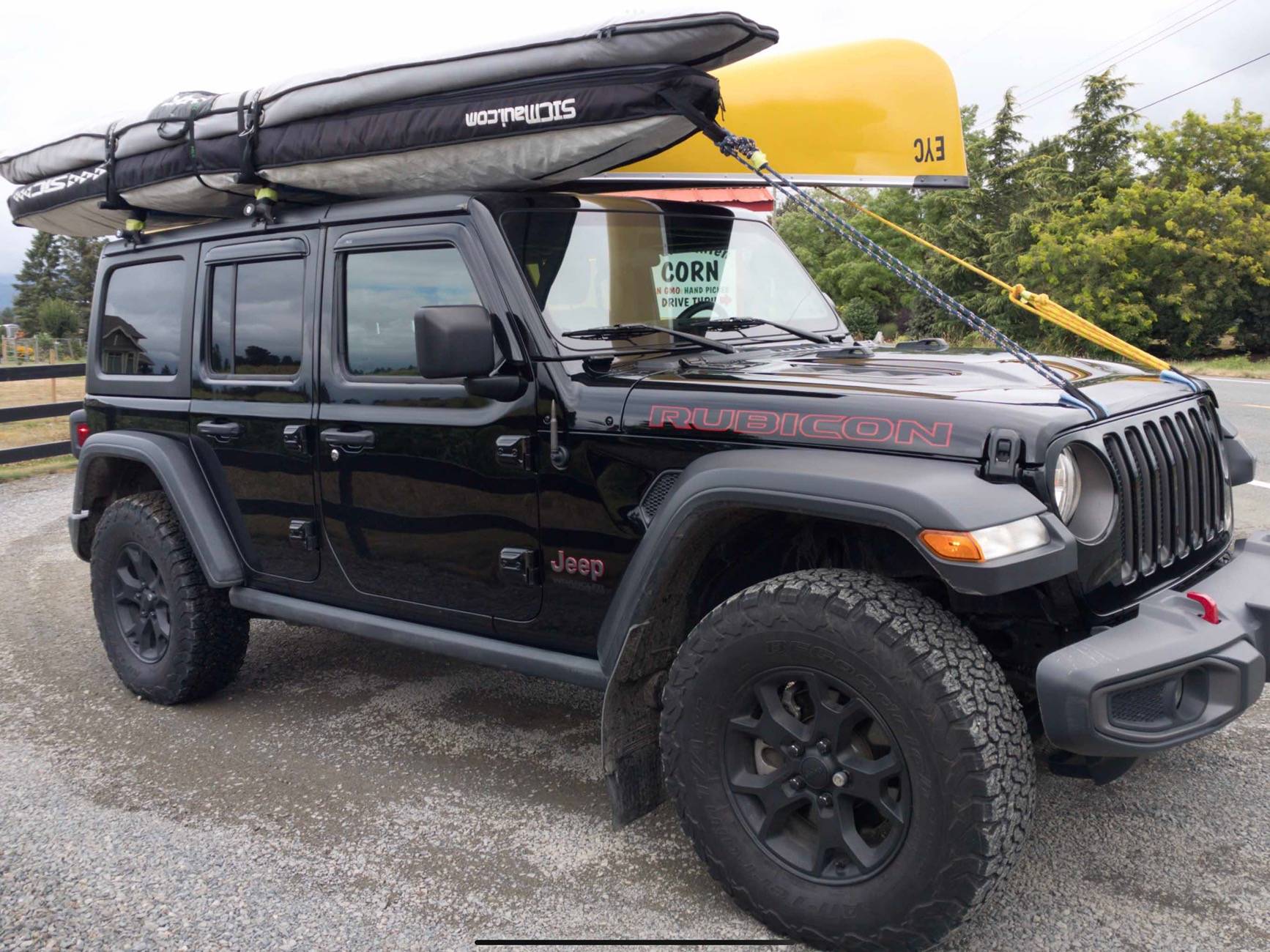

Post this pic years ago. Using a Yakima gutter mount is fine. No stress cracks nothing. Take off the rack and you would never know what load was up there. This is around 150lbs or maybe a bit more static. 16' glass comp canoe plus 3# - 14' hard racing paddleboards comp and carbon. Bouncing on a heavily rutted with huge potholes FSR back to civilization. Highway probs was around 60mph for a few hours. So dynamic wind load was pretty massive with that much windage. But just tie it down properly - drive within reason - and you should be good. Not speculation or guesses or BS. Actual. Best not to exceed 60mph.
Jeep Wrangler JL rain gutter rack mount, any issue? 3681367C-1A23-4988-85AC-2A89457029AA

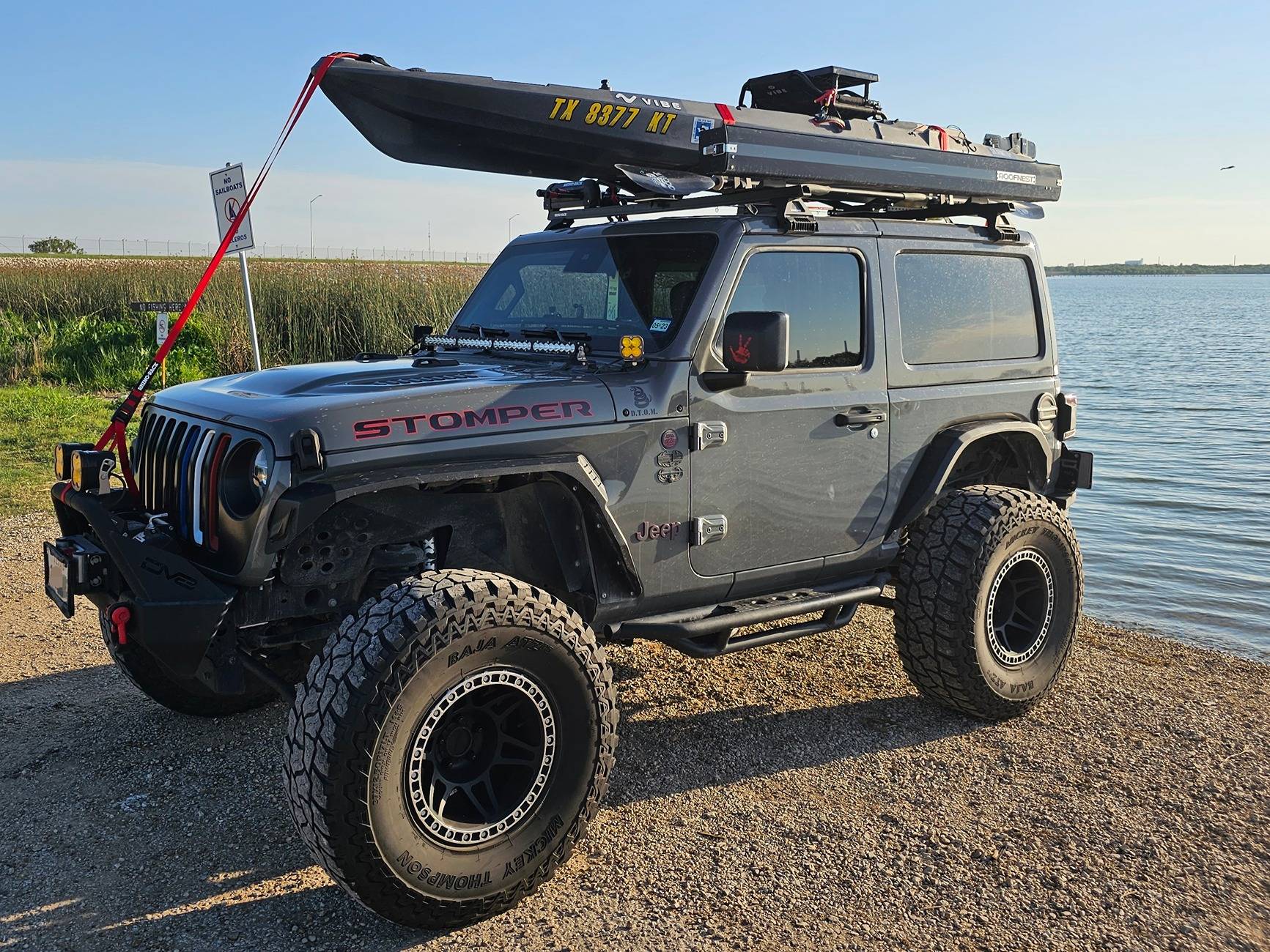

Like others, I carried kayaks and SUPs. IF you can tie down your load to the hood, bumpers, whatever, you mitigate some of the lift forces.
Still doesn't get you around the weight limit or the chance to crack gutters - not the "best" idea, but it may work fine.
Jeep Wrangler JL rain gutter rack mount, any issue? 1000003786
