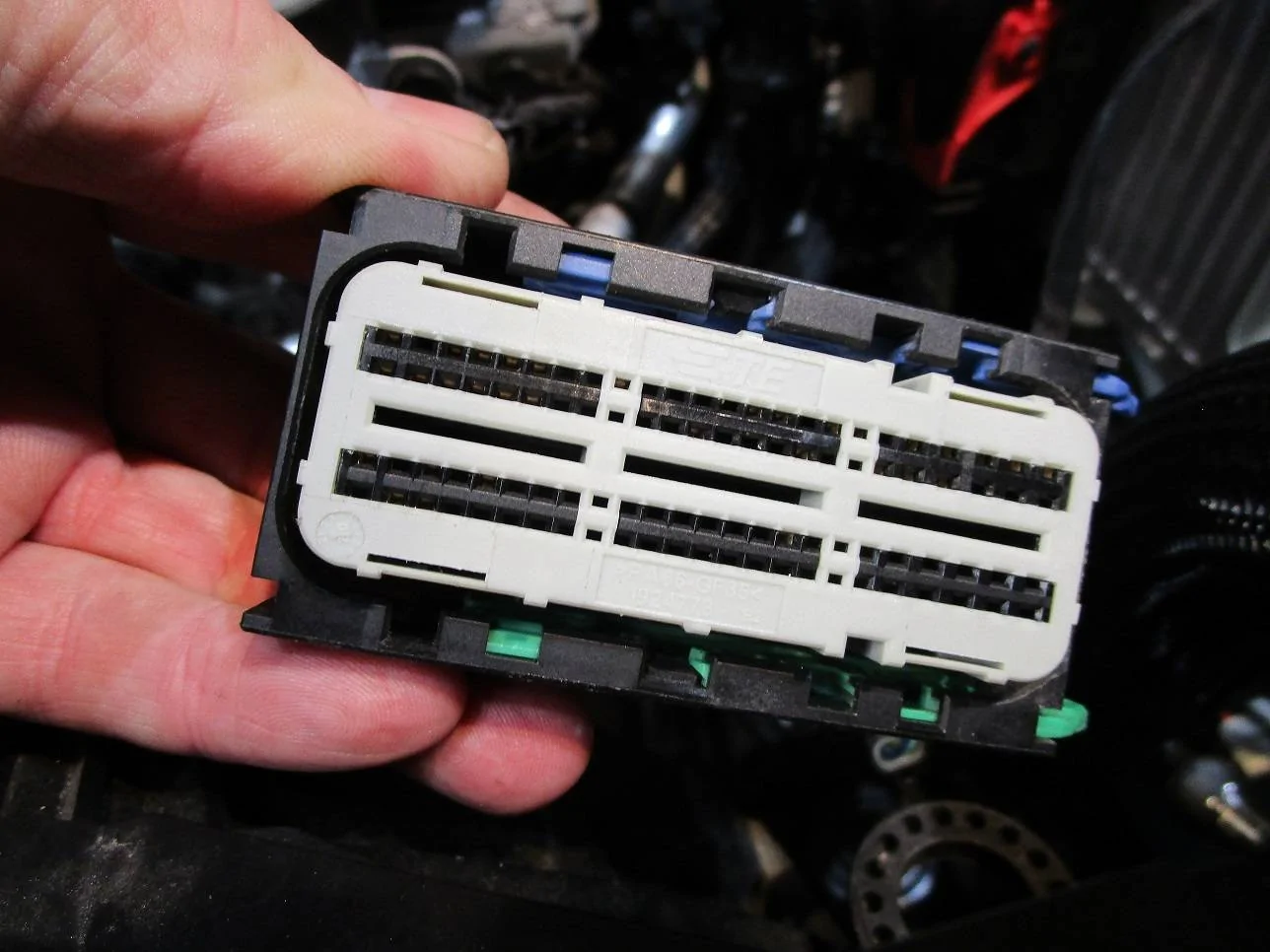

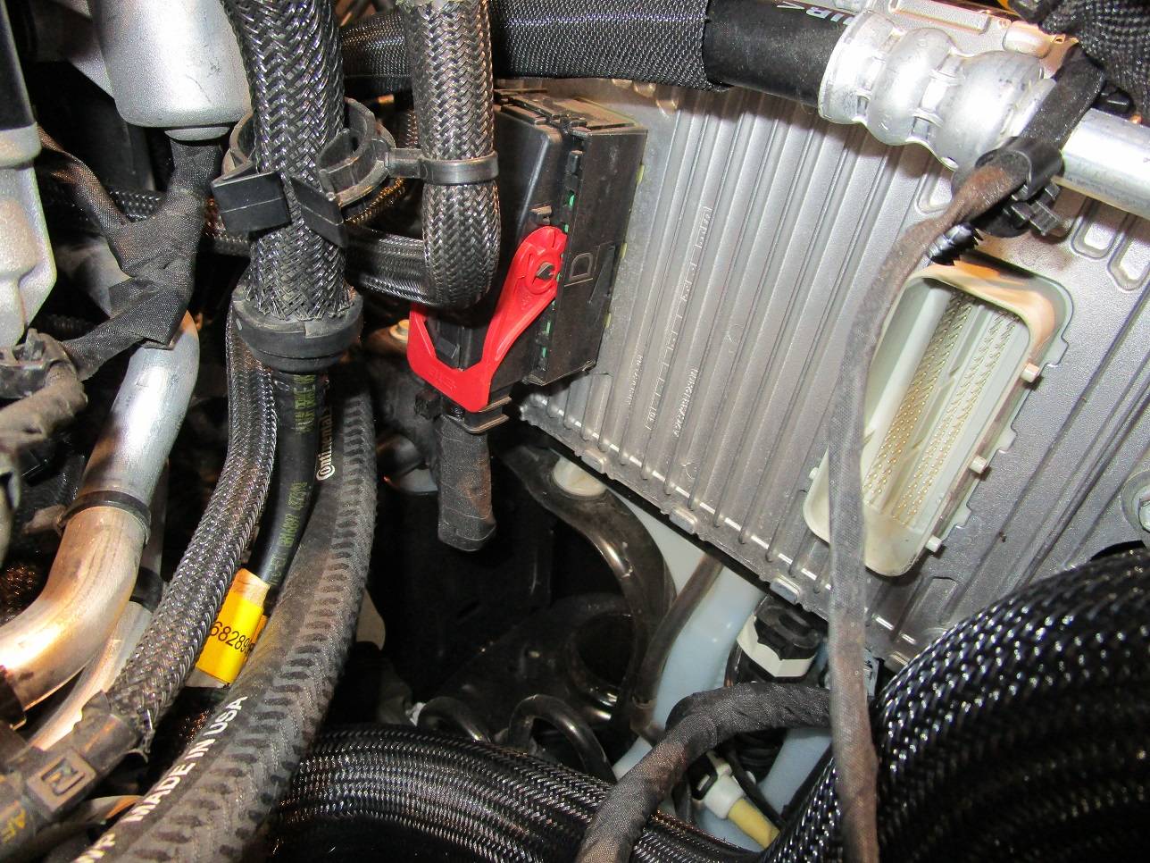

Sorry to revive the old thread, but the post from @Willys41 is so helpful.
I am going in to do the install of the RPMExtreme fan controller on my 19 JLUR. Of course, any job that Shane starts turns to 💩 about 5 minutes in.
Need some wisdom/knowledge/whatever from the group.
I'm at the point of unplugging the forward plug on the ECM. Sounds easy, huh? Of course not. When I pull the hinge up to turn the cams to loosen the plug, the plastic cover just pops off of the plug rather than moving the cams. I have no problem re-attaching the cover, but I cannot get the plug itself loose.
Any suggestions? Can I use some sort of penetrating oil on the slides without damaging the electronics?
